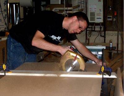

Are you using a guide to make your cuts? If not clamp down a straight piece of 1x2 or a long straight edge as there's NO way you can freehand cut straight enough. Then just run your saw along the guide...

Cut a 3 or 4 inch x 8 foot strip out of MDF that has a smooth factory edge. Then use wood clamps to clamp that small strip to the sheet, leaving the smooth factory cut to butt the saw up against as a guide.
Get you a plug in saw also... //content.invisioncic.com/y282845/emoticons/wink.gif.608e3ea05f1a9f98611af0861652f8fb.gif. Batteries **** for anything that has to do a sufficient amount of work. Also, about getting Lowes to make your cuts, they only guarantee them to within 1/4", so what I would do is give them all your cut sizes and add maybe 1/4" or 1/2" to them and you can refine them when you get home. This will keep you from having to make the really long cuts.

well i got all the cuts done yesterday evening... used almost all of a 4x8 for a 2.2 cube ported box lol but i got them all within a 1/16th of a inch. Put the box together today, and added woodfiller to the countersink holes. Tomorrow it gets sanded and a coat or two of bedliner
