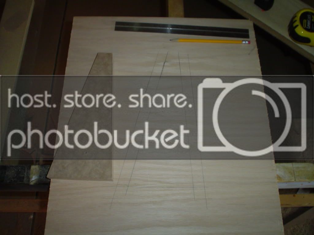

First, i like to draw a full scale model so i can see the actual finished pattern. This is where i get all my measurements from instead of using math to figure it out.
So this is from the buyer of one of the builds i'm currently engaged in
So i make my full scale drawing, and then cut out the end piece and use that as a template to make 3 more pieces just like it using my router and flush trim bit.

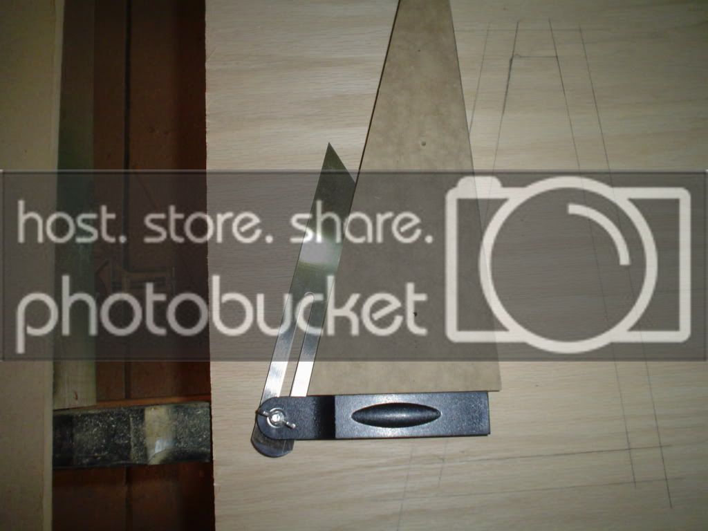

Using the end piece, i take my angle gauge to get the exact form

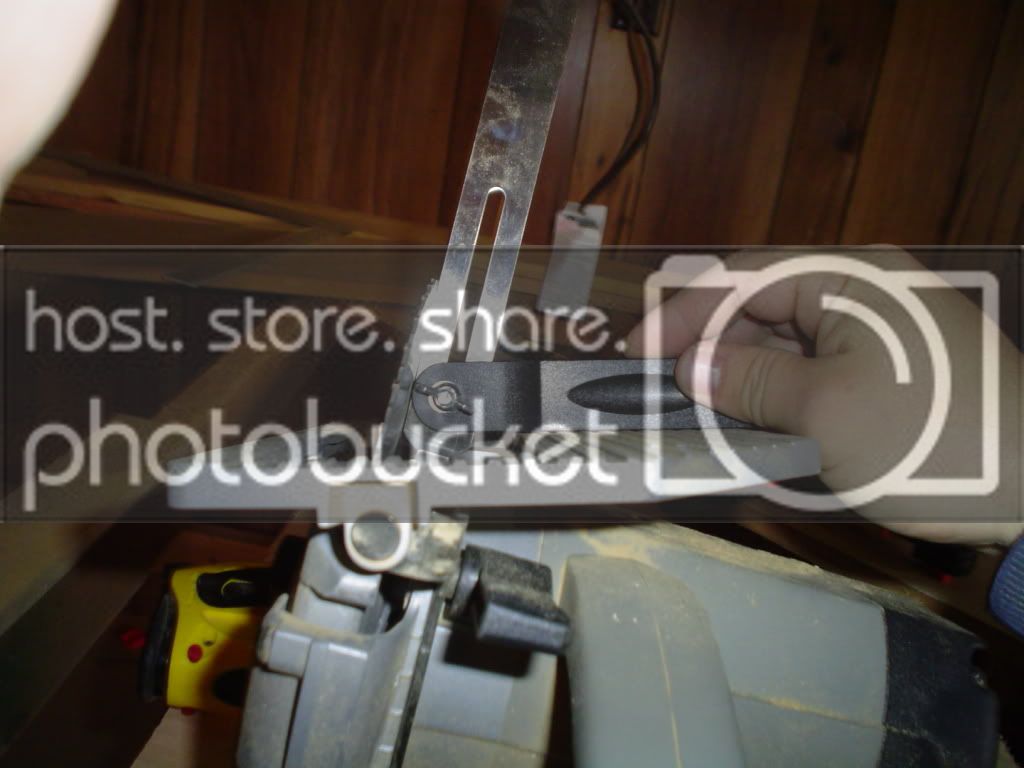

I now transfer the angle to my circular saw (unplug the saw during this step)

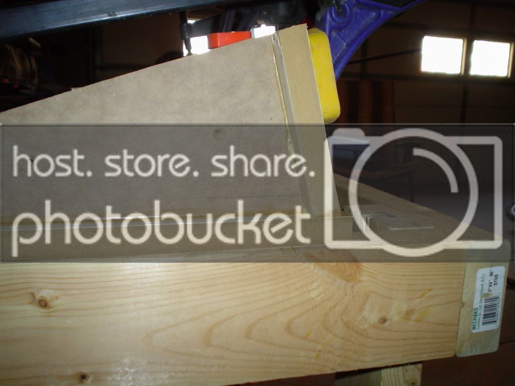

And if everything works as it should, you will get a very nice tight fit
