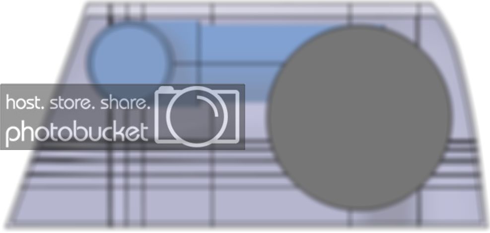

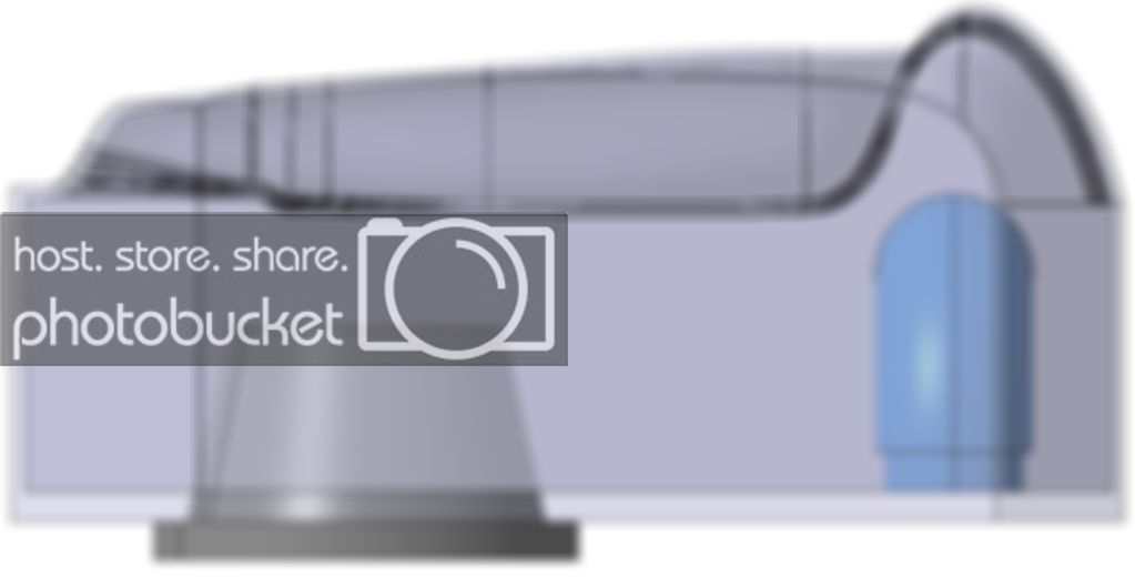

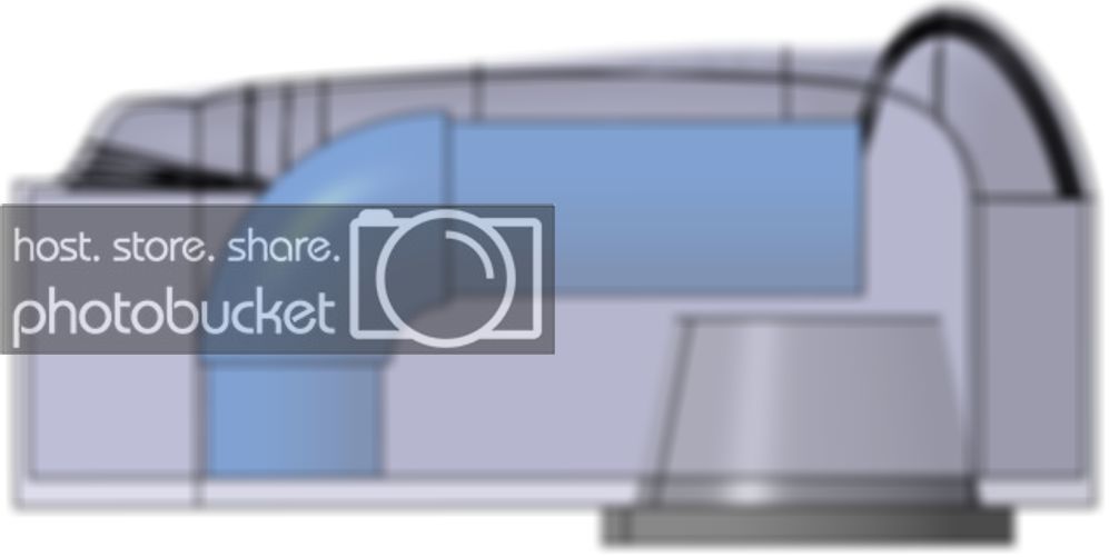

Below are some pictures of the current box design with the port and driver locations modeled accurately. You can make out the internal lines of the box to see that everything has clearance. The front and the top of the box will be made from 3/4" MDF. The seat and door sides, back, and bottom of the box will be fiberglass. I might only do the back as fiberglass and the rest as 3/4" MDF, not sure yet. I figure that using fiberglass would result in thinner wall thickness which gives me more volume so I do not have to extend my box out farther into my trunk space. The top in fiberglass too I guess... But I might want to put stuff ontop of the box. If I go camping for example. Would fiberglass be okay to use on the top? I make an assumption that all the fiberglass locations will be 0.25" thick as a start. Does that sound about right?
I will be heat-forming the PVC port to creat a good flare on either end. I will either build a mold with a flare modeled or use a bowl. Any suggestions? I realize the model does not factor in the flares yet, I will probably refine the model and see how much it changes the volume. It also looks like the clearance at the end of the port might not work if there is a flare... I'll need to look into that, just thought about it.

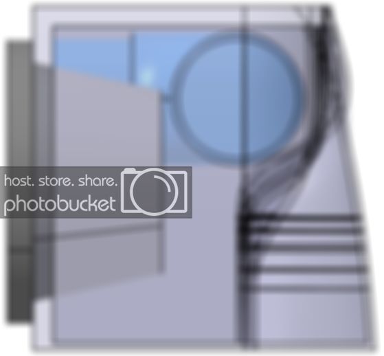

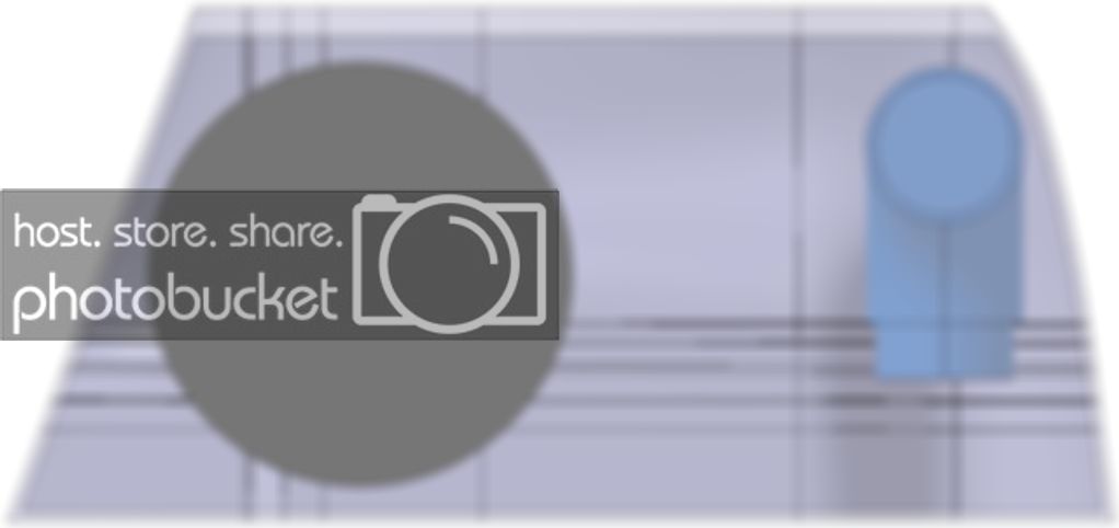

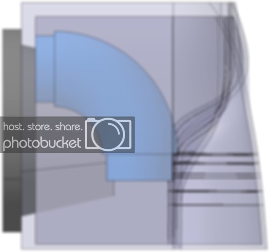

I changed the design to use a 3" port which shortened the port length and increased the net volume to 1.3447cuft and the port length is now 9.46". I also swapped the location of the port and the sub and the clearance is much better. The port head it now on the other side of the box from the sub.
Now I am mostly concerned with the top, bottom, and sides of the box. I know the front will be 3/4" MDF and the back will be ~0.25" of fiberglass. What about the sides? I have been recommended to use MDF on all sides except for the Fiberglass back. I have also been recommended to stick with fiberglass for the added volume, but line the inside of the box with a deadener. I have 10 sheets of 10"x13" deadener material from Parts Express (HERE). I also have 1lb of poly-fill which I have been recommended to try from Parts Express (HERE).
So here is my favorite option so far. I will make all sides of the box fiberglass except for the front which will remain 3/4" MDF. This will bump up my volume to 1.40 cuft and a port length of 8.95" I will line the inside of the box with the Sonic Barrier Sound Damping Sheets. I will then loosely line 0.5-1.0lb of polly fill inside the box (recommended amount per cuft).
