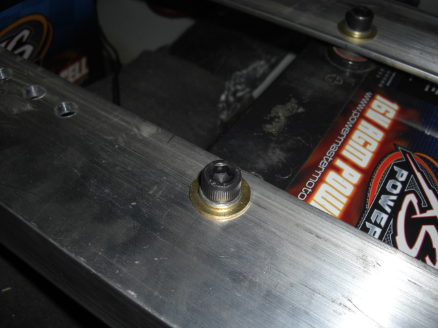

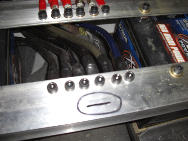

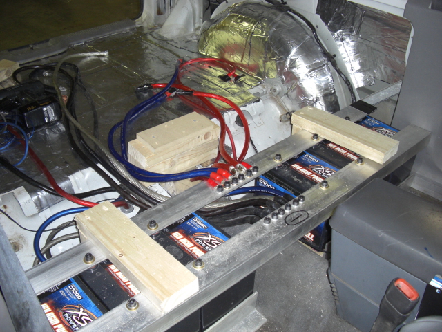

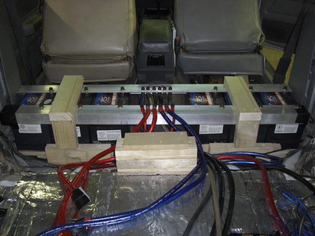

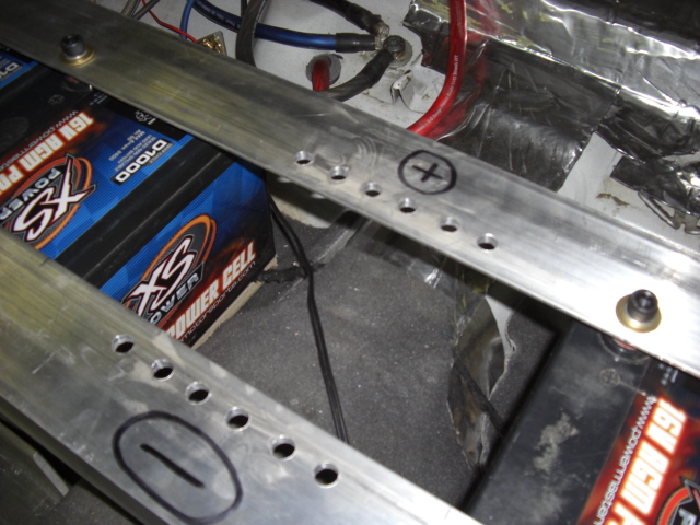

* I have just a little bit of aluminum here.

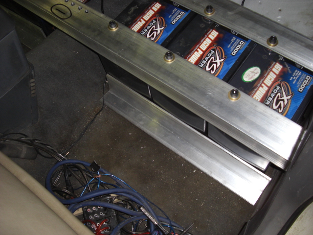

* Front brackets to hold them in place will be aluminum angle just like the bars.
* Allen bolts + lock washer + brass washer (have one on both sides)

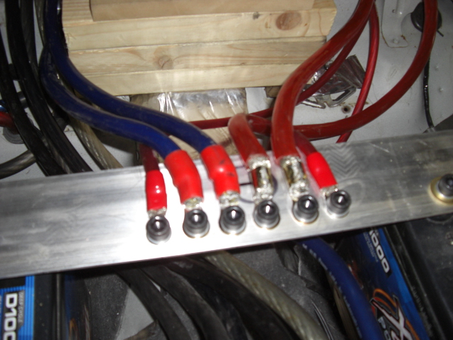

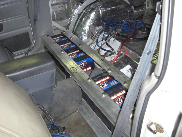

* This is where the wires will connect for the amps, grounds, flux caps, etc
Nice that company is local to me, any reason you didnt go with copper?
Other than the fact its like 8 times more expensive?
aluminum isn't a bad conductor... hell of a lot better than iron
sure copper would be better, pound for pound, but it looks like he's got plenty of aluminum there to handle is current needs. would have been a waste of money imo.
