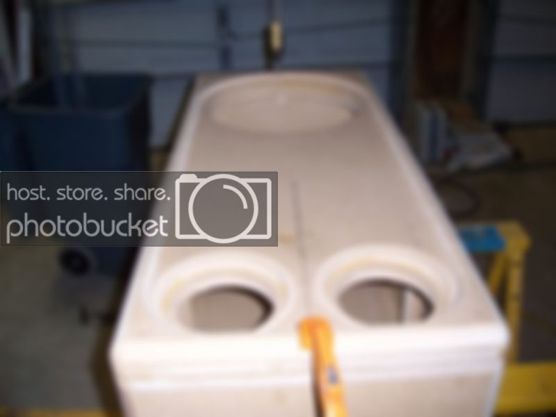

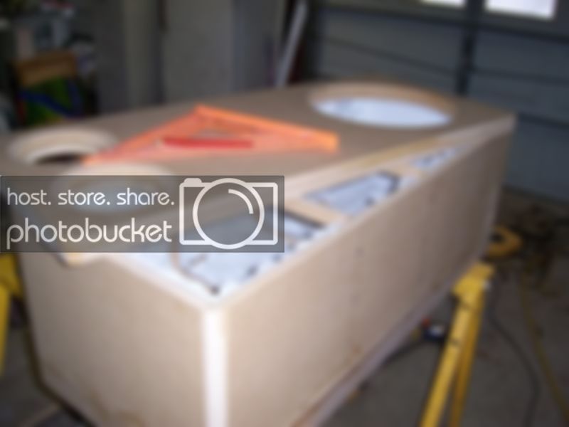

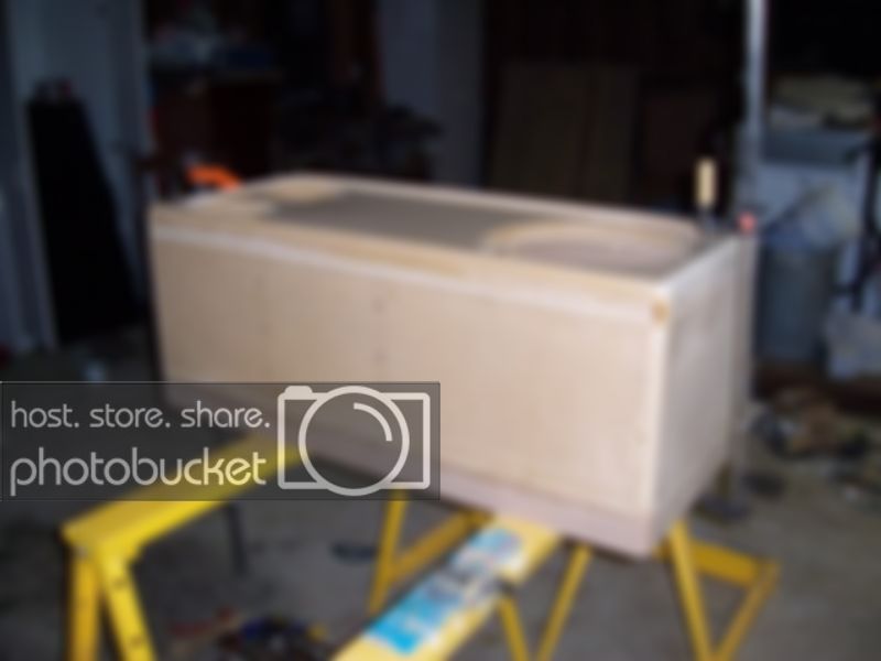

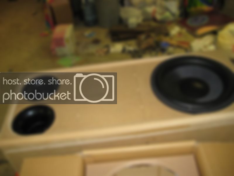

Everything mocked up to round the corners on the baffle and back panel:
Siliconed everything up (just to be sure):

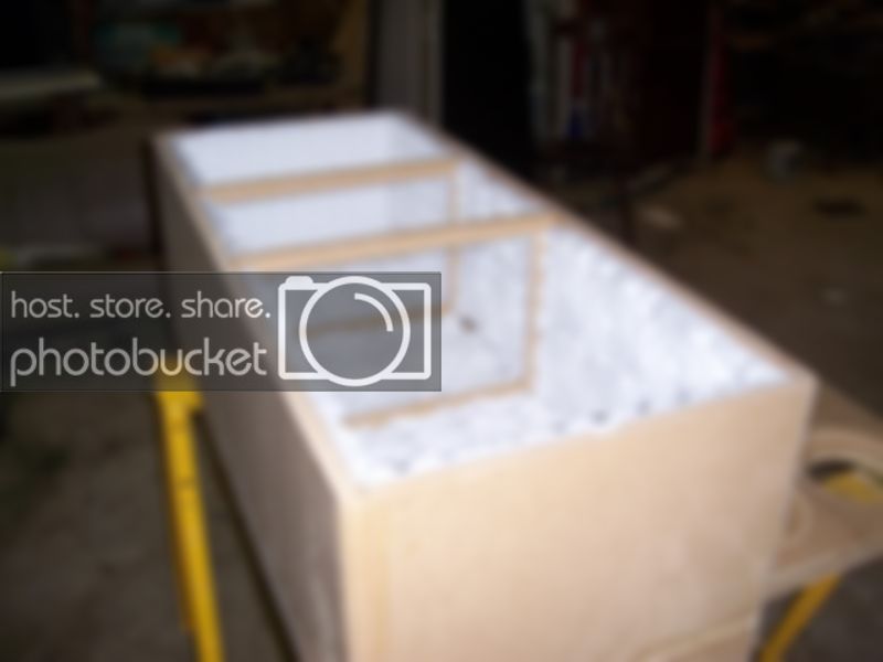

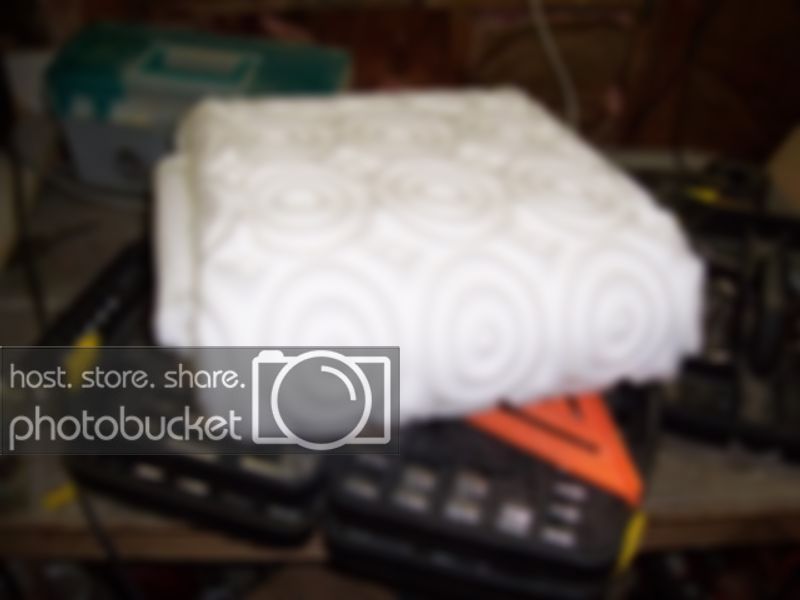

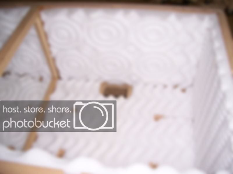

I've been searching for a while for stuff to line the walls of enclosures. Batting is always too thin and expensive, foam sheets are expensive and small, but I found this stuff today at Wally World for 9 bucks. I also think I'll have enough extra to do my ht enclosure.

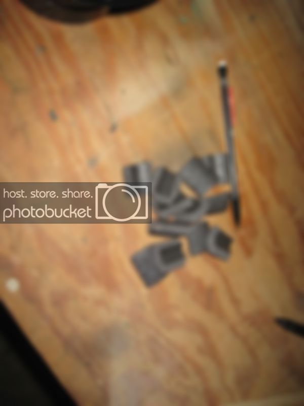

I picked up this to run the power wires through. I can't seem to find any smaller ones for the speaker/rca wires though.

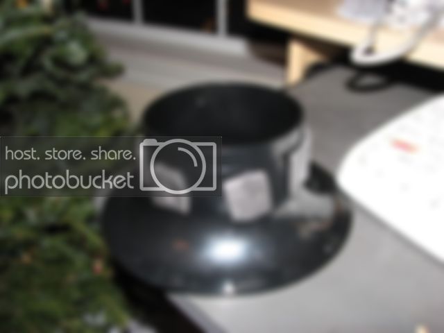

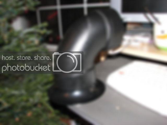

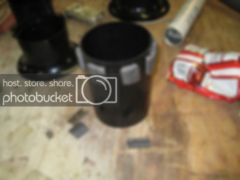

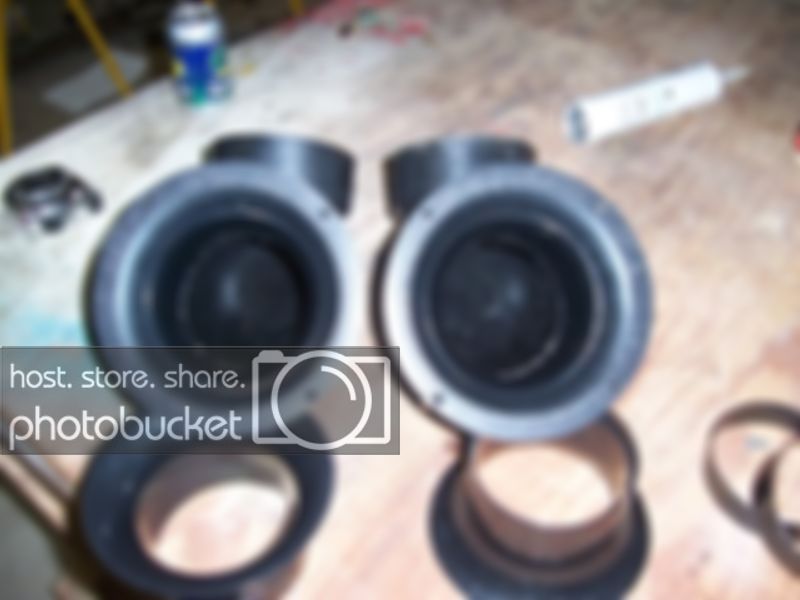

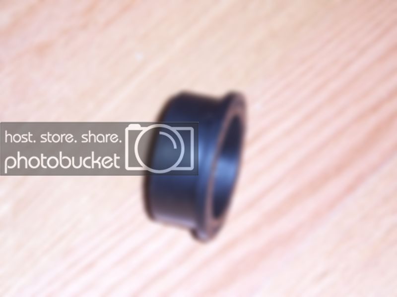

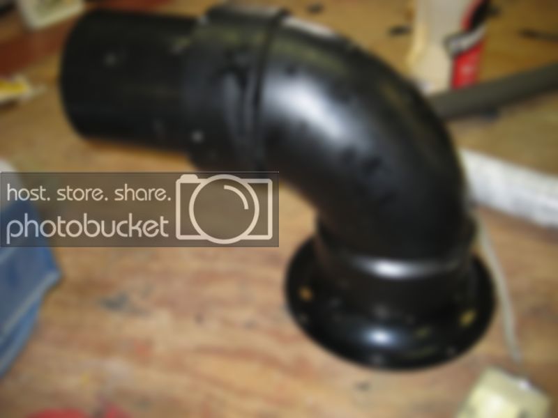

I finally found a way to connect the aero port tubes to the 90* elbows that I got at Lowe's. I used some foam pipe insulation and hot glued it around the tube. It sits tight and won't move or shift.

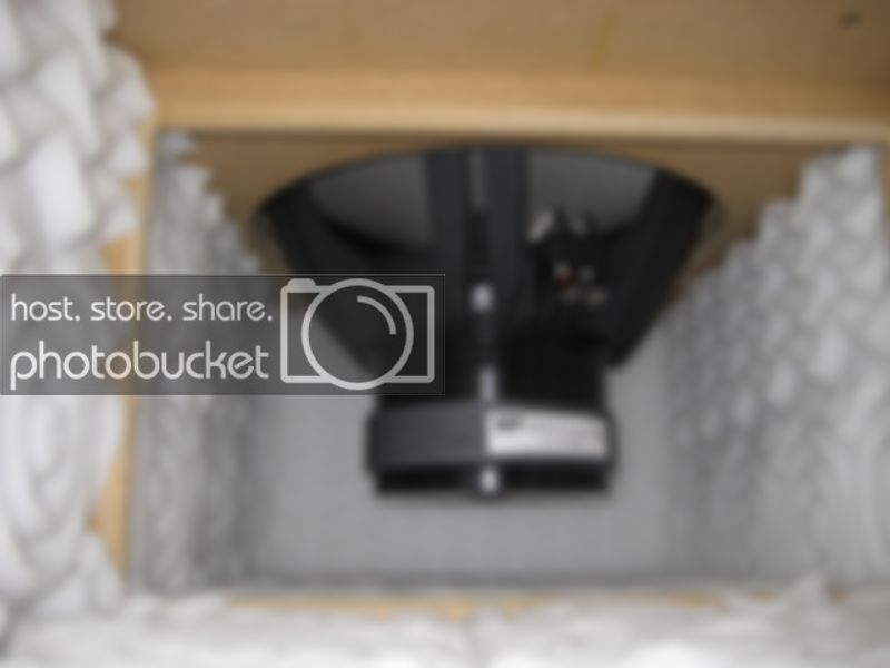

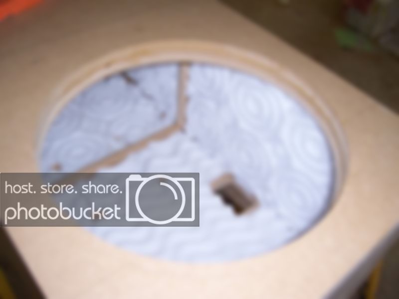

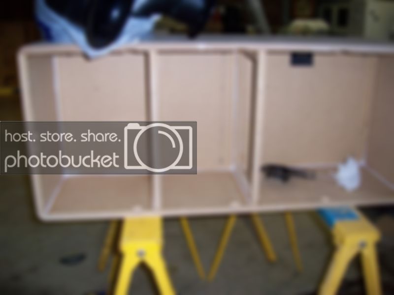

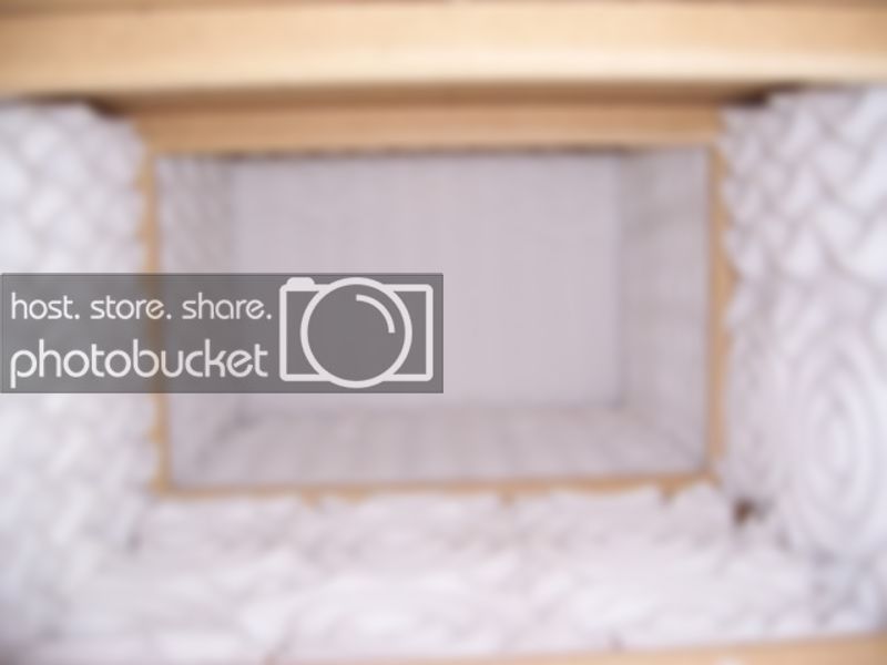

Lining all cut and glued up:
It's starting to look more like a comfy casket:

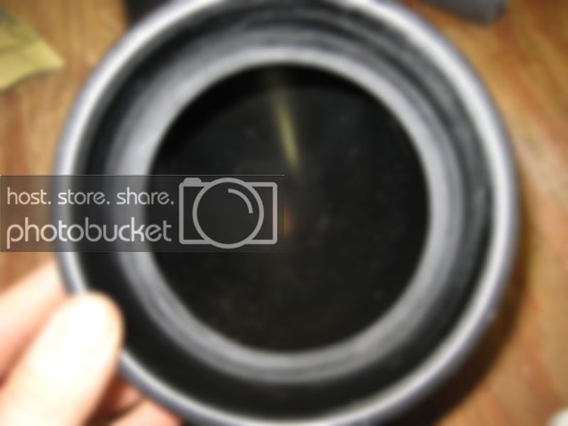

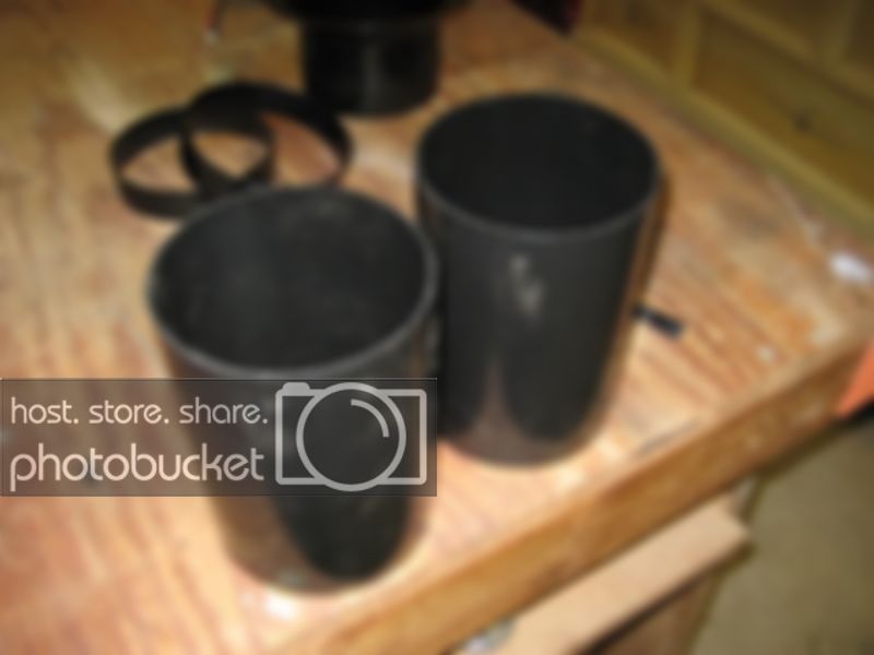

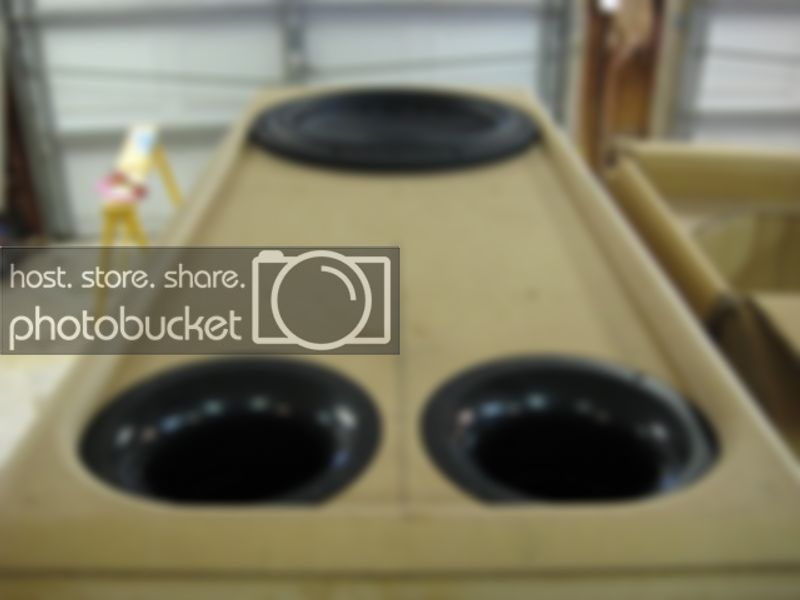

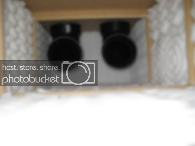

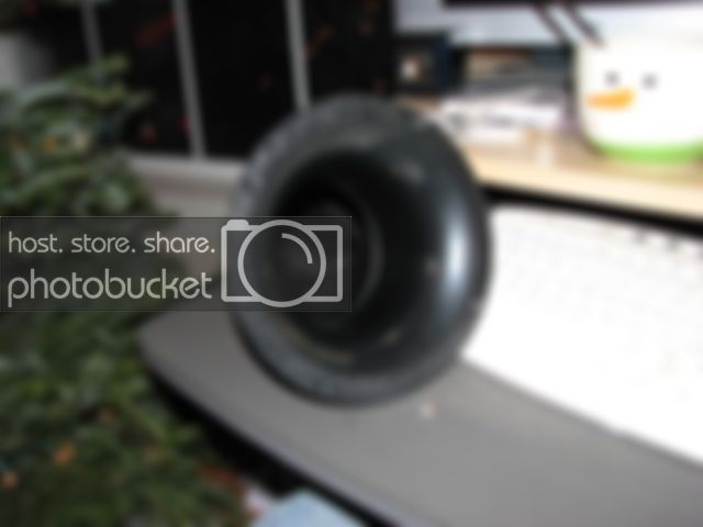

Ports:
A little messy on the joints with the elbows. I might use some electical tape to smooth it out:
