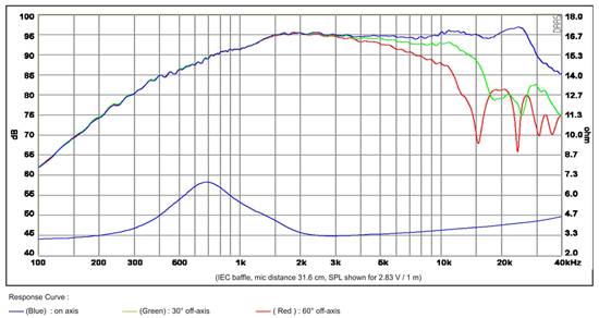

Just to give you a comparison of how much you are actually losing when going off axis vs on axis.
Red = 60 degrees off axis
green = 30 degrees off axis
dark blue = on axis
ignore the lower line
That is pretty true for these tweets I'm playing with currently.
