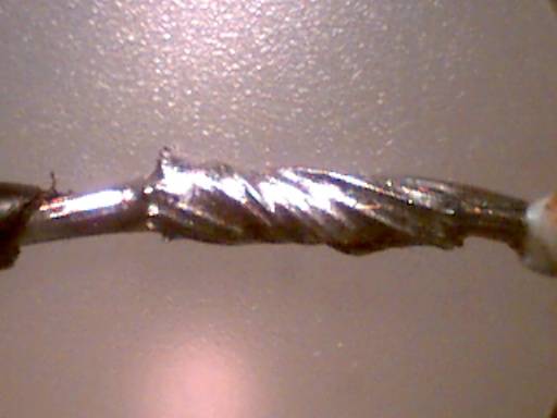

Solder 2 pieces of wire together correctly and try pulling them apart. I bet the wire rips elsewhere, or not at all, before the soldered sections come apart.
You know youve done a good job soldering when both wires are shiny and wet looking with solder.
Like that. Thats not going to come apart....
