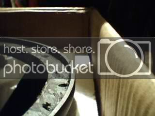

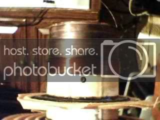

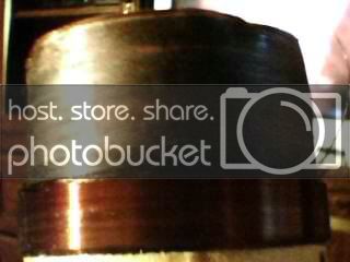

RAW Basket and Motor:
Can you say burnt pole?
also... fyi, if you plan on using the screws to bolt down the spider landings its gonna be a bish
every one of them ive done came with screws that were too short, i just ended up clamping down the spider rings till the glue dried...
also, putting the screws in is especially a bish on the 15" basket... you will see why soon enough //content.invisioncic.com/y282845/emoticons/fyi.gif.9f1f679348da7204ce960cfc74bca8e0.gif
lol...yup as far as I can see I shined a flashlight to lok really well, but that doesnt always mean its all clean. I will look in the daylight to make sure and use my air hose to blow it out real good.

and i meant former not pole..lol
