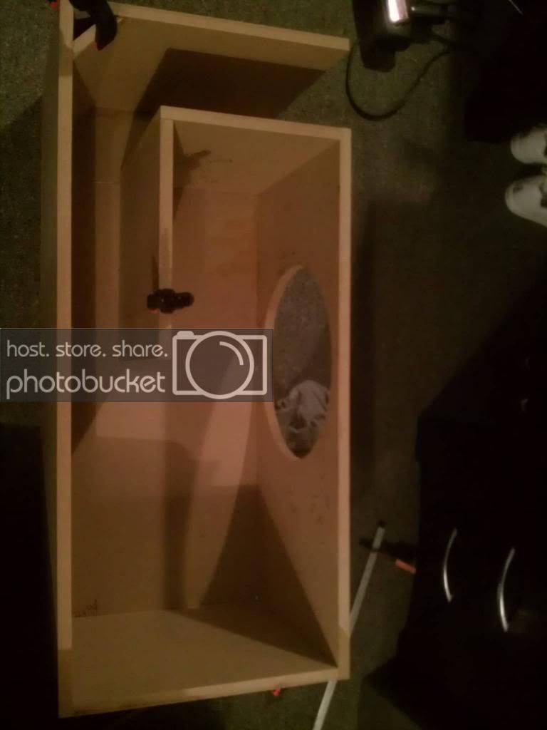

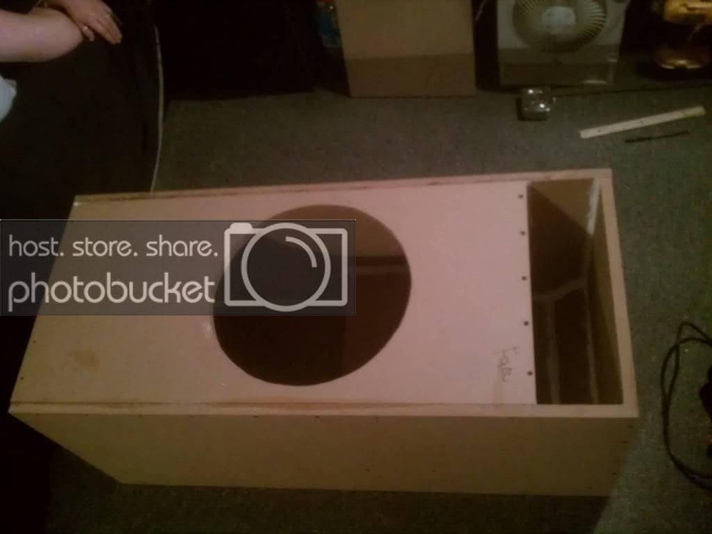

Doing the 45's will remove approx .18 ish of a cube for my plan. That only adjusts my tuning like .3 Hz... I am most likely going to do pic 2 as it is not that hard and I feel it will be better.

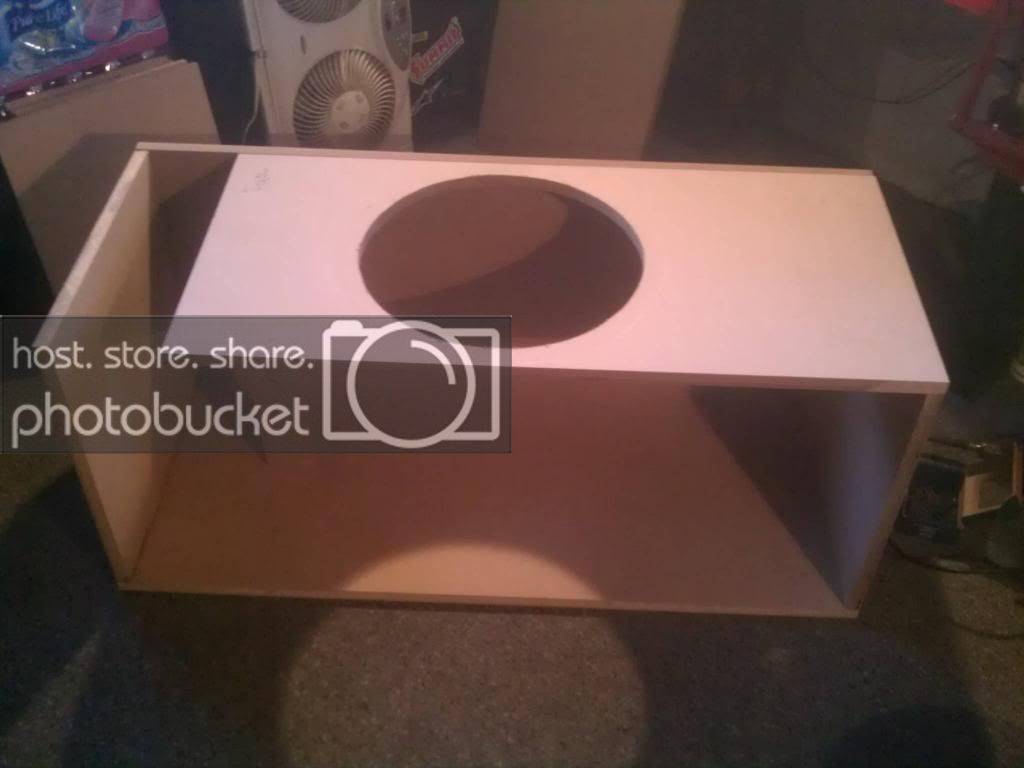

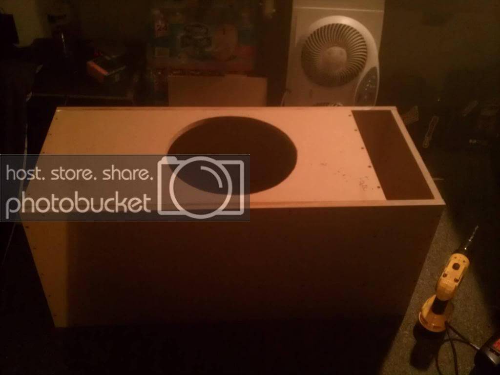

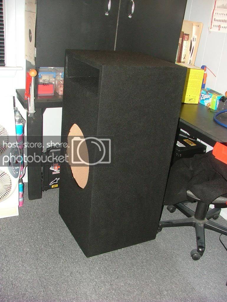

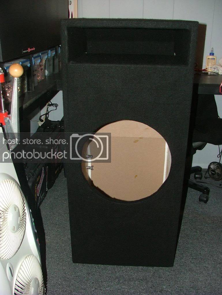

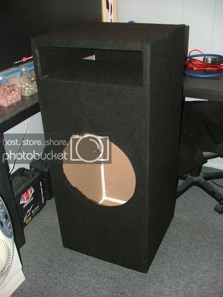

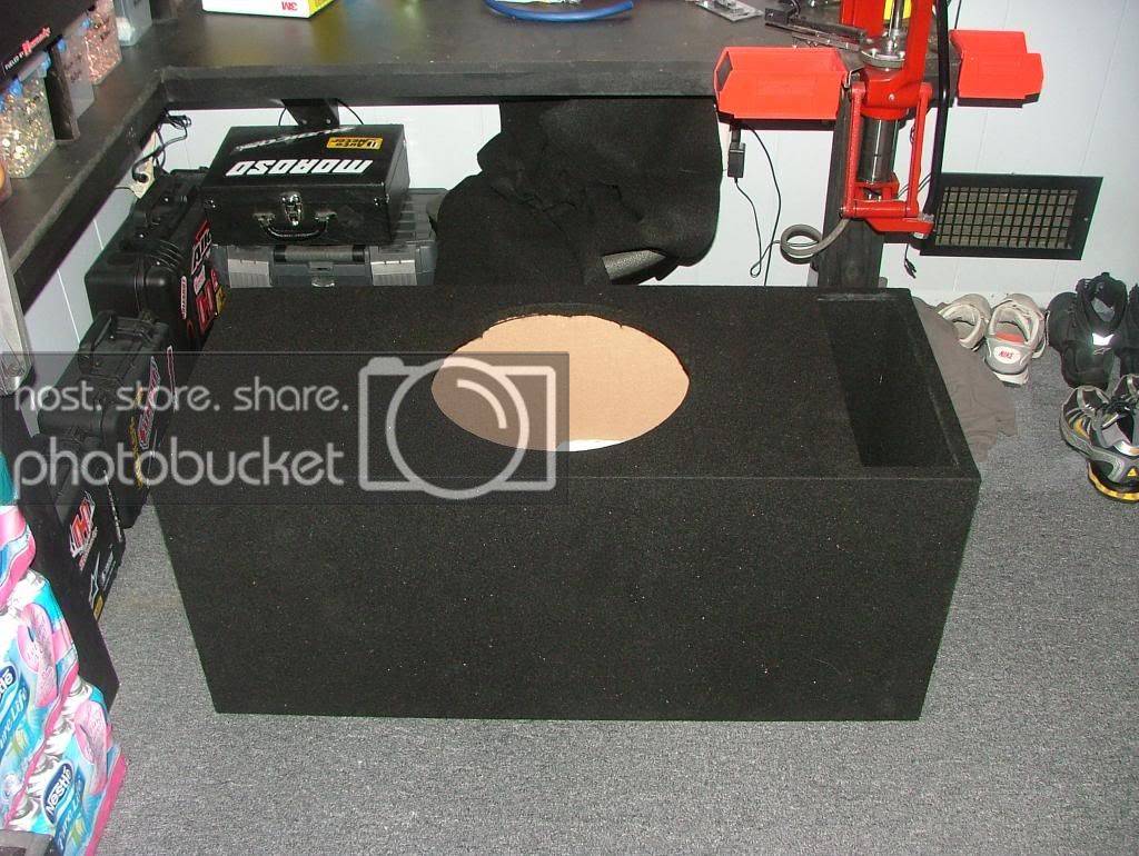

Well I built it. Won't have the sub for two weeks but that's ok.
6.22 Net, 4.03 after port and sub displacement tuned at 34hz.

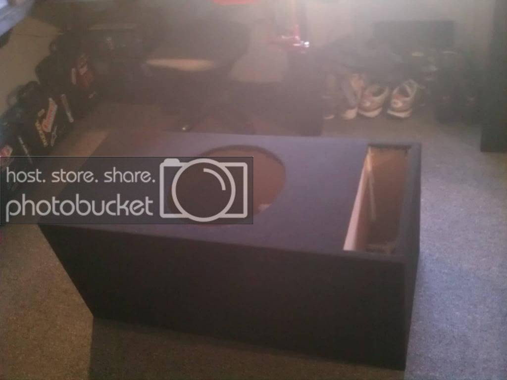

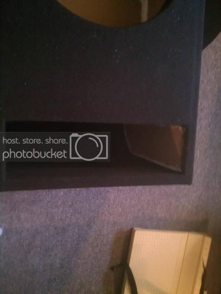

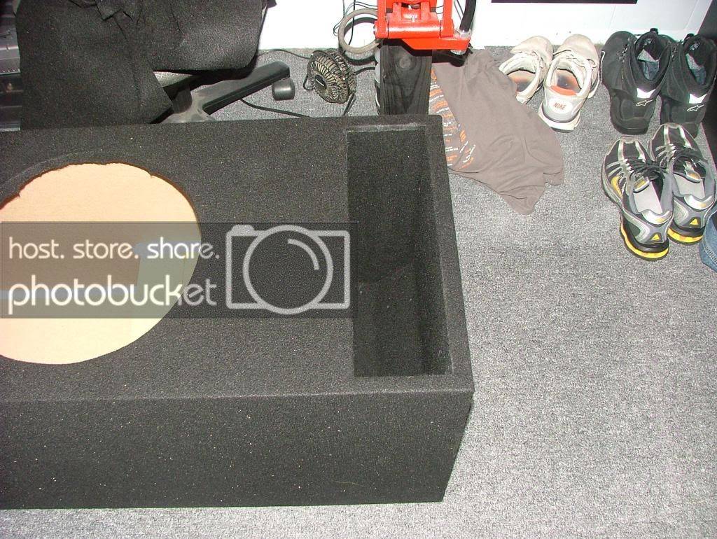

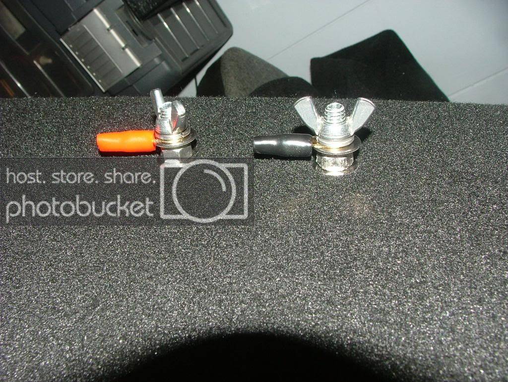

First time using carpet on a box, so be gentle. I decided to carpet inside the port as well. First time using all thread style terminals. I did not want to attempt soldering 8 gauge wire to the radioshack style terminal you cut out the square for and mount on the box. I figured these will be more applicable due to the power going through them.
Decided to go with pic 1. I figured out that putting the 45 in the corner (at the right distance) keeps the port at 5" wide, otherwise it got to 7" in the corner. I know I personally will not notice the difference with the other part having a 45 so I didn't bother.

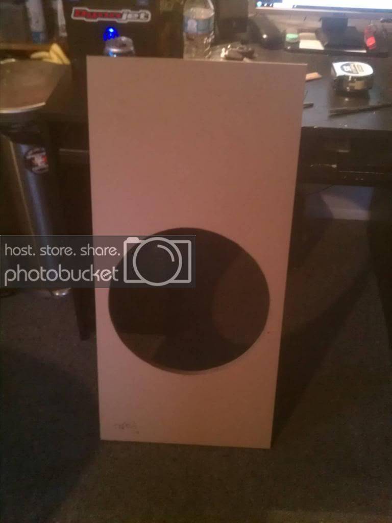

The circle aint bad for a jigsaw huh! LOL I hate cutting sub holes.
