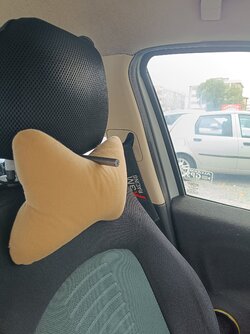

but with the microphone in this position should I have used the 90 degree calibration file?
I used the other one (normal calibration)

I think the 90° cal file is if you have the mic point up to the roof of the car or room. IASCA will sit in a car and evaluate the SQ @ aprx. 90db. Setting your tune between 85-95db would be a good idea.

Measuring with pink noise. I like to sit in the car with ear plugs so your body mass can be accounted for, in the drivers seat, using the 90° cal file, volume at 85-90db, using REW with the mic facing up, move the tip of the mic at ear level slowly around my head ear to ear 6 or 8 times to get a good average. You can do this for each speaker or set of speakers or all speakers at once. Reference DB's from your mids.

but I only have to do this method with the microphone passing it from one side of the ear to the other when I take measurements of the general frequency response, right?
to adjust the levels of each speaker I have to fix the microphone in a single point at head height without moving it anymore, right?
