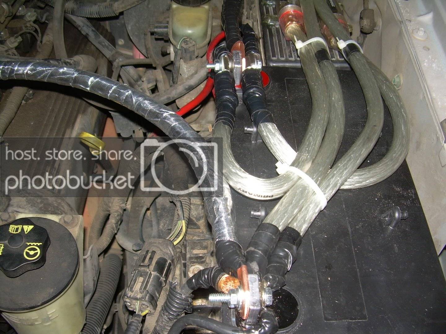

I used AP 1/0 for my build. OFC, but I can get 2 runs of it for less than 1 run of knu kolussus flex. I don't care how good it is, you can't beat doubling up the amount of wire.
what??? that logic makes no sense especially if it can't handle the current. but anyways, OP, I am not gonna tell you to go with Knu or any other brand but I'd atleast get a wire that you either no ppl use or you can find out what the actually current handling of wire.
How does that make no sense?
2 runs AP> 1 run of Knu and they both are the same price.
how much current does your AP wire handle? if it handles 150 or greater for each run than not bad but if it doesn't than it's just another run without any benefit.
250-300a. It's true 0 gauge, but not over sized.
Here's a pic next to 4/0:
