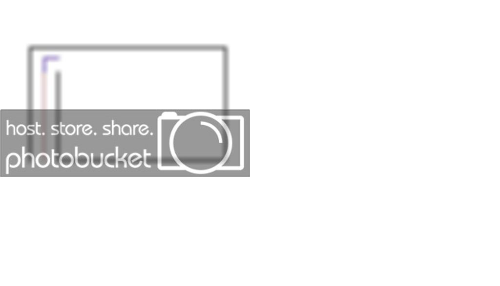

i think i know what it is.. the port is measured down the center, not along your port wall edge, thats why it looks weird on that calculator
how would that change the port length?
dimensions are
48w x 19h x 24d
port width: 7"
Port length 2: 0"
red mark is how the port length of wood is measured, you have to calculate the whole line for the total actual port length
so even though the red mark is X long, thats not the whole length of the actual port
unless they are calculating the remainder 3.5" (half your port width) out into the box for some reason...//content.invisioncic.com/y282845/emoticons/confused.gif.e820e0216602db4765798ac39d28caa9.gif
