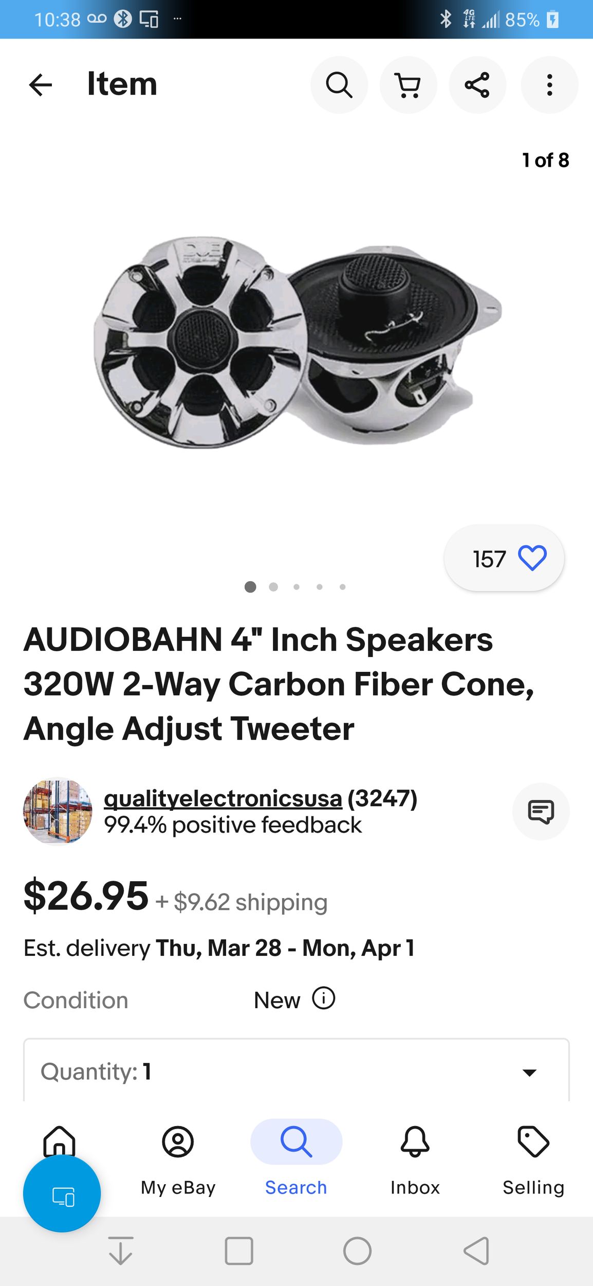

With a bit McGuyvering you can use these.
I really like the MM series Polks, but the DB series are really nice and clean as well for the $coin man. Just my suggestions atm.Might look to see if CT Sounds has anything of interest. ?Not a fan of D4S, but decently priced 3.5s that take a little more juice for the coin

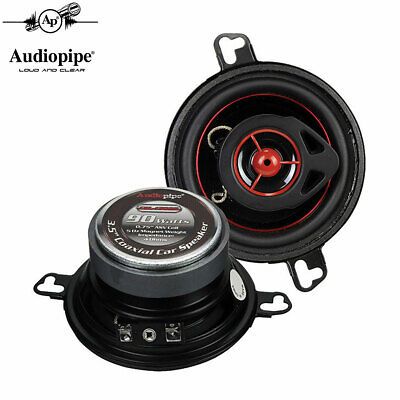

These will handle a little more power ea. 50 rms. for coupole $s more
