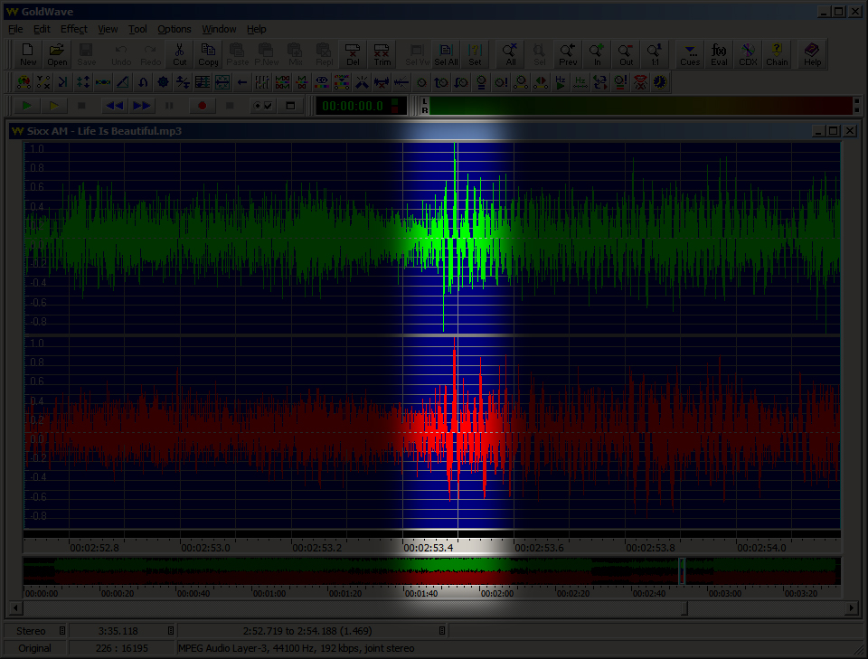

I opened up the MP3 file in an audio-editing program and noticed that it appears to have been recorded at 0db and the particular location of the popping sound is right at the max level. Could the popping I'm hearing in my speakers be a result of clipping?

I've attached a pic of the waveform as it shows up in the audio editor if it helps.

I'm not sure I understand the idea of clipping correctly, but couldn't it still be clipped without being clipped at the amplifer? I.E. the recording itself is clipped? (Which WOULD make me think that I'd hear similar results from my computer speakers when playing it, but regardless...)
