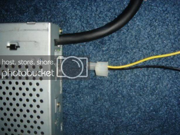

To anyone wondering how to make your own since the part is discontinued, here is a simple guide that does the trick.
It is a 2 pin molex cable you are looking for but I found a 4 pin molex cable on a computer power supply. You want the side that has the yellow for the odd shape and the black for the square ( yellow top, black bottom ). Pull the black and yellow wires out of the back of the other side and then cut the 2 front inserts off. I did a search online and for fusing, you will need a 3 amp fuse.
Here is a pic of what the finished product should look like.

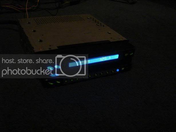

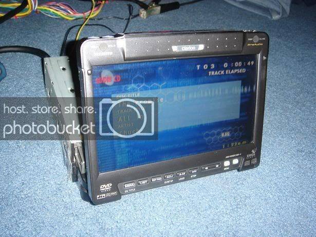

This method worked like a charm for me, here are some pics of the unit in action.
