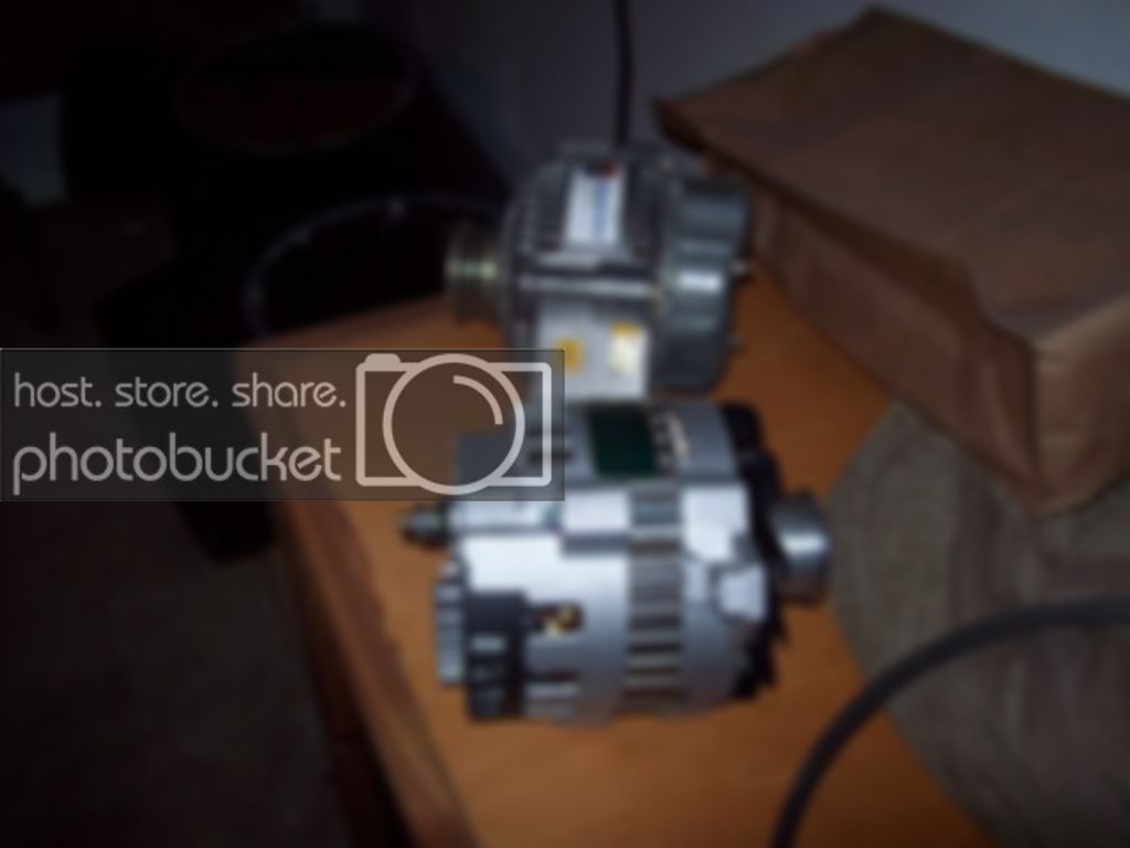

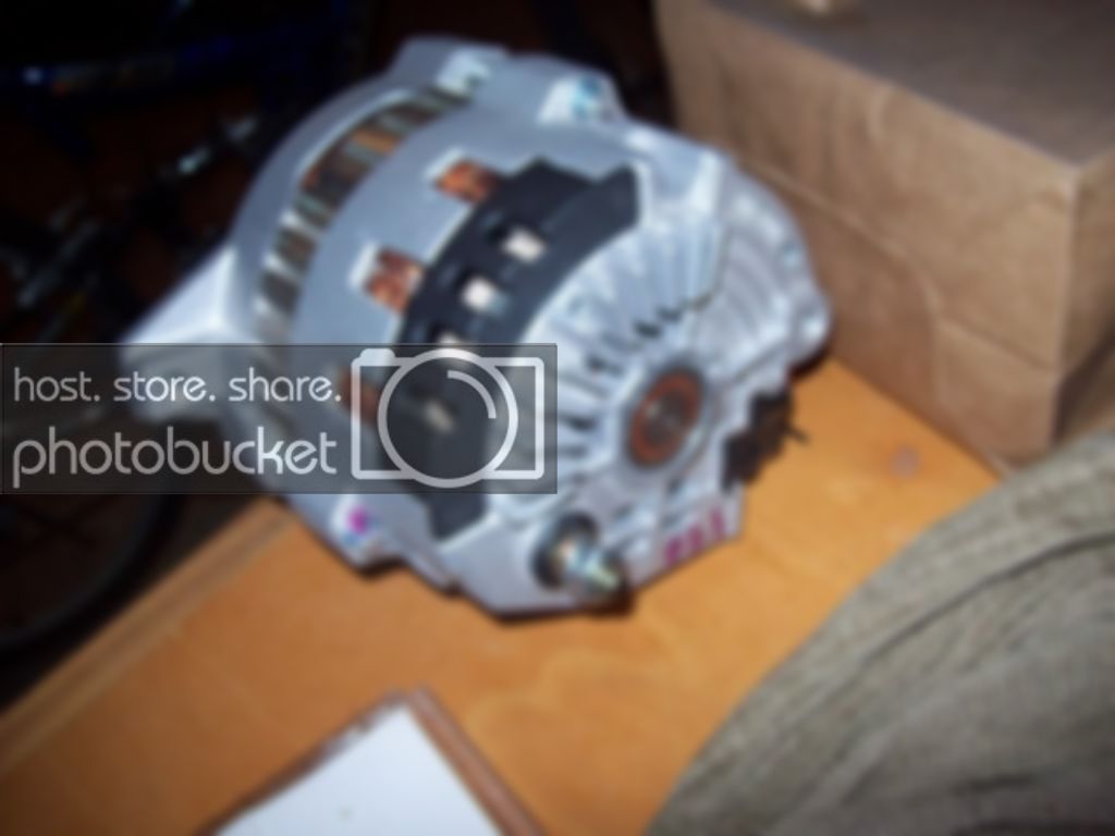

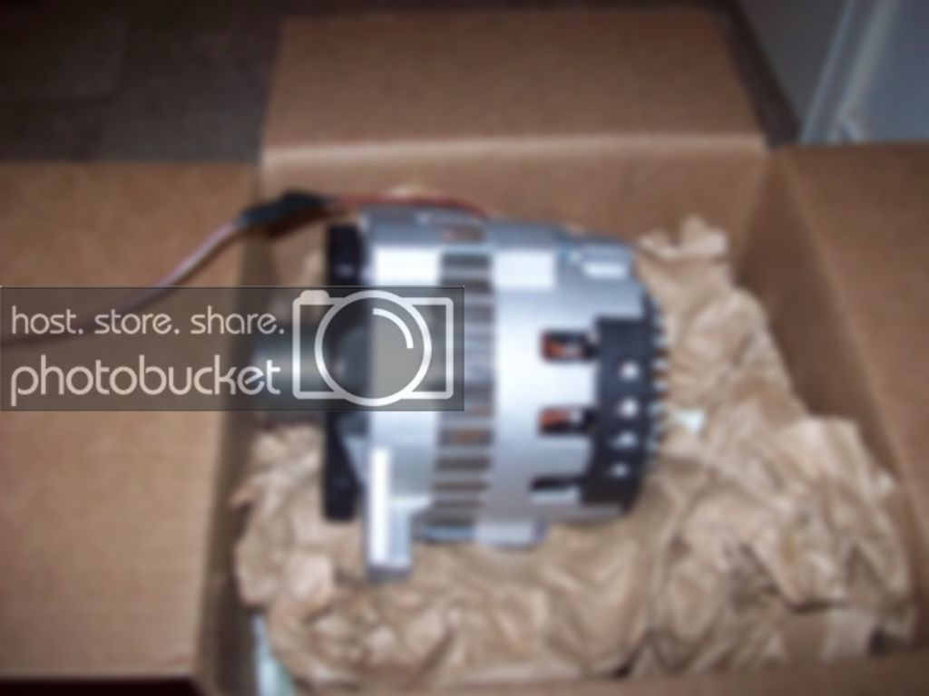

I just got this alternator from excessive amperage. It is a gm 225 amp alternator and include like a 3/8 or 1/2" spacer and fits perfectly. I took some pics of me puttin it in cause it's a ***** to get these alts in and out of these civics
First some pics of the alt

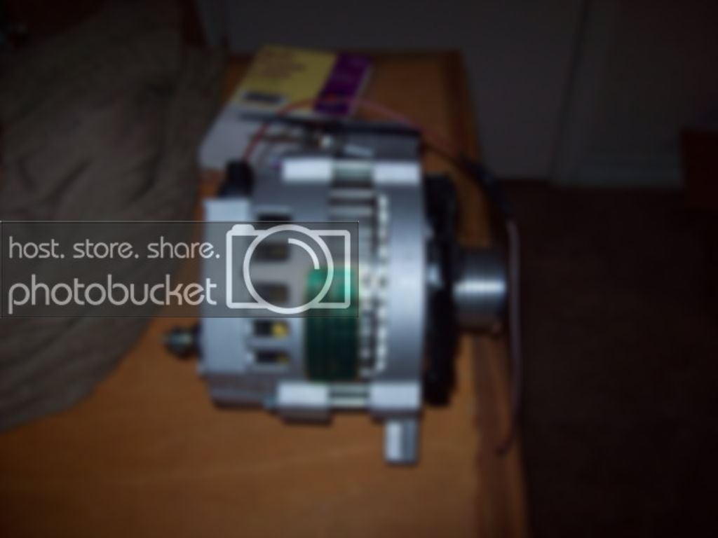

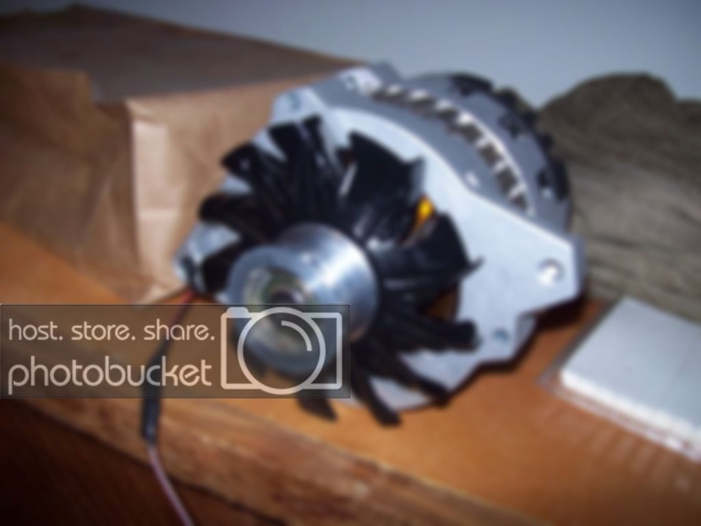

In this pic you can see the little spacer that is included
Here it is compared to the stock alt well that's a shitty load boss alt that crapped out on me but it's the same size as stock

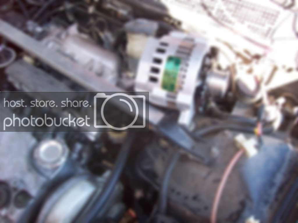

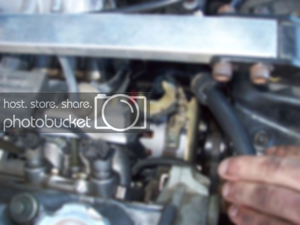

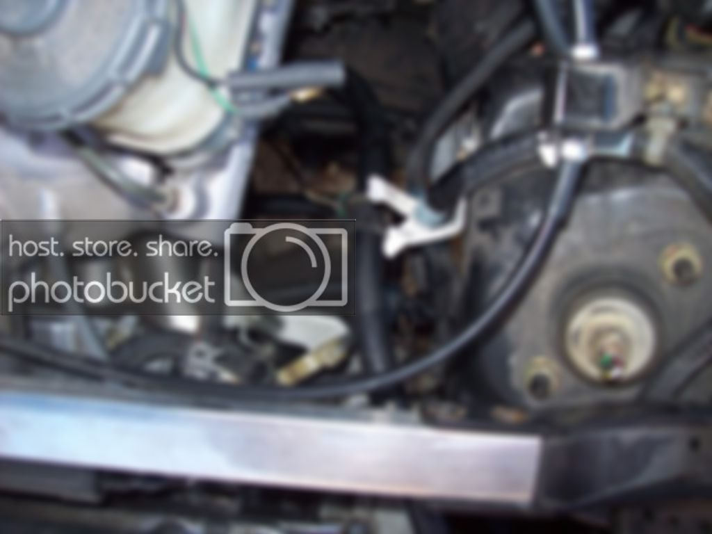

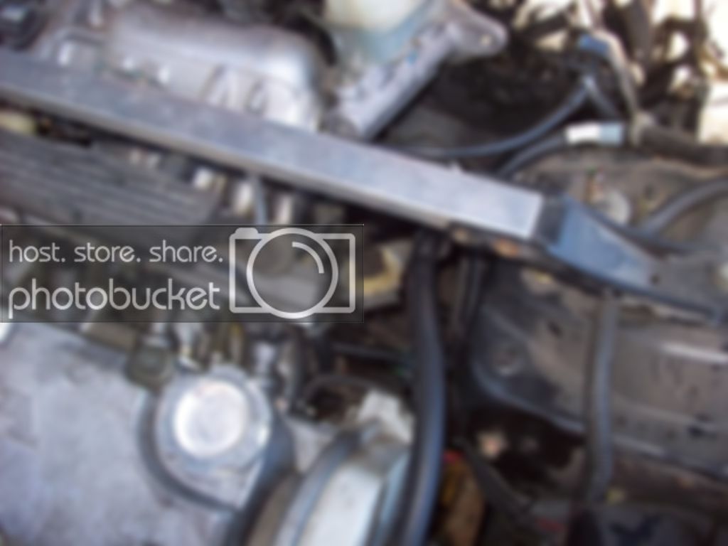

Here is where it has to fit I already took the old alt out
Now I just have to fit this bish in there
All done //content.invisioncic.com/y282845/emoticons/veryhappy.gif.fec4fed33b4a1279cf10bdd45a039dae.gif
It's crazy how this alternator sounds I guess cause of the fan on it but I like it and with all my amps at full tilt with rpms at like 2000 the lowest I will drop is 13.6 volts so I'm very happy //content.invisioncic.com/y282845/emoticons/veryhappy.gif.fec4fed33b4a1279cf10bdd45a039dae.gif
