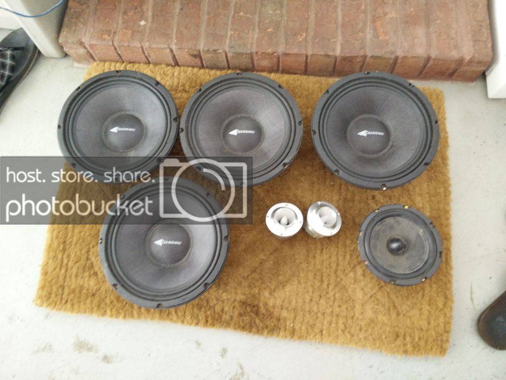

The crescendos are nice. I have 4 10" PWX mids and 2 FT1 tweeters.

My nendo 10"s and FT1s next to Soundqubed mid and tweeter.
