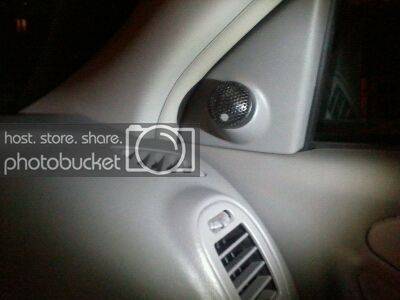

Finally mounted the tweets to the sails properly. When situated directly on top of the stock tweeter locations, it looks like a natural extension of the sails. I love the way it turned out, and it was sooo easy. Used some Loctite epoxy for plastics to join the back of the tweeter mount to the sail. I love the way it looks... the pic doesn't do it justice.
I agree it looks good... If only the tweeter was painted to match... //content.invisioncic.com/y282845/emoticons/smile.gif.1ebc41e1811405b213edfc4622c41e27.gif
My whole interior is a cheap-looking, grey, and blah... the black tweets (along with the h/u, hvac, and gauge cluster) are actually making it look a bit better, imo.
Sometimes it's nice seeing the speakers instead of hiding them. I think speakers are beautiful?
I used a silver hammered paint for plastics, disassembled my dash pieces, and painted the black and grey silver. I like it, but it would have been much better in a black car. You just gotta make it your own and enjoy it.
It is, and they most certainly are.
And, I do! //content.invisioncic.com/y282845/emoticons/smile.gif.1ebc41e1811405b213edfc4622c41e27.gif I actually enjoy this hobby a lot, despite not having much money to throw at it. In fact, making a little sound like a lot more is where a lot of the joy comes from.
