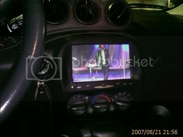

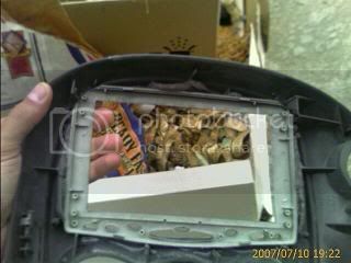

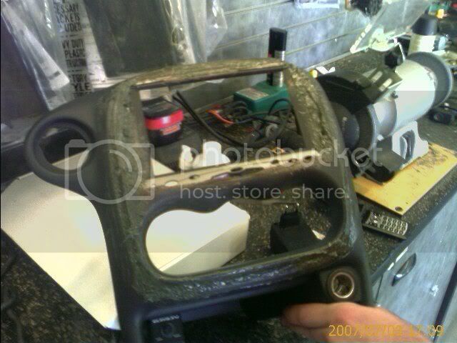

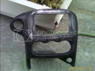

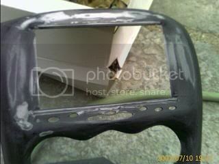

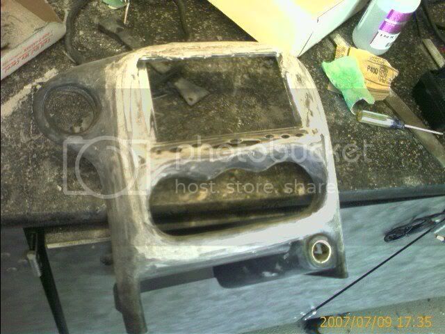

The computer is in the glove box, right next to the blower for maximum cooling. The screen went into a 1 1/2 din slot, so cutting and molding was necessary. Two buttons at the top were relocated and a groove around the bezel was filled in.

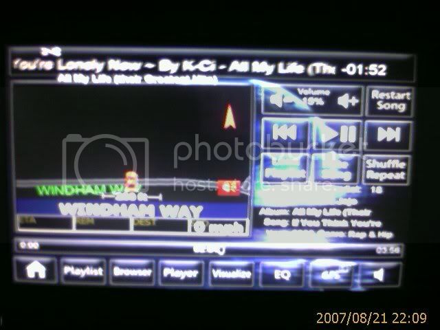

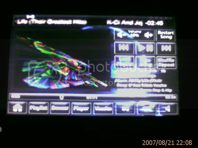

Computer is running Windows XP, Roadrunner front end, Iguidance navigation, and winamp for the music.

Lines around the screen are perfectly straight, but something about the video playing and my camera makes them look curved.

Main music playing screen with visualization

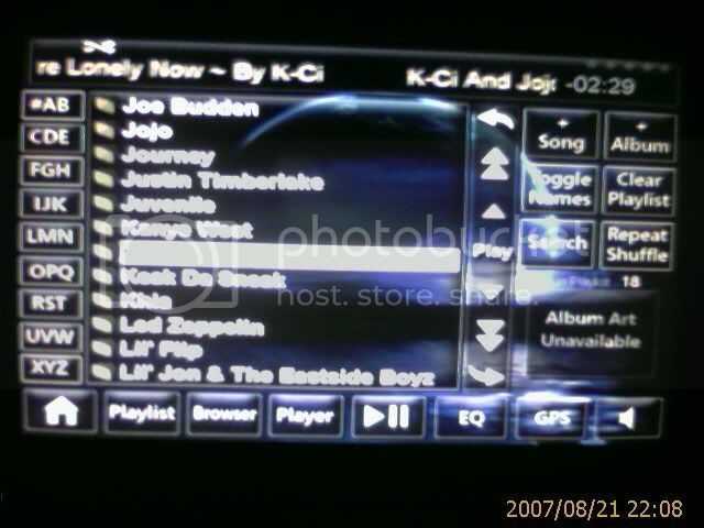

Browsing music on the hard drive. Very responsive, no delay at all like ipod interfaces.

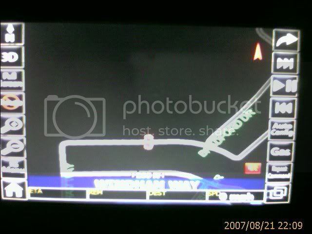

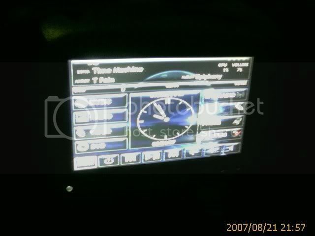

Main Navigation Screen

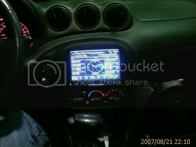

Music playing screen with navigation screen embedded. Looks a lot like the eclipse with the tomtom built in.

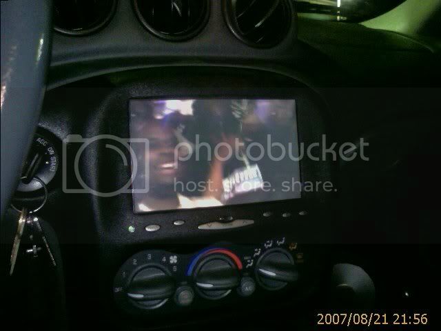

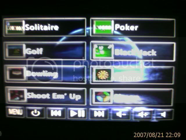

Game screen
Final Shot

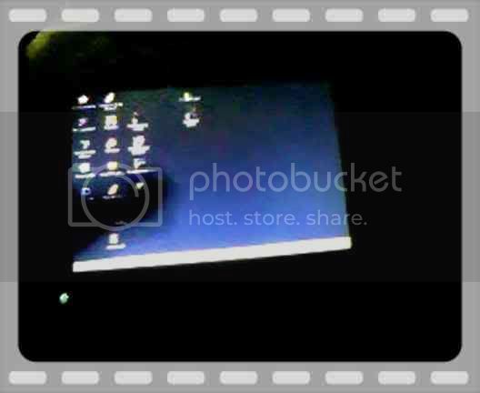

Video:
Sorry for the bad video quality, it was off a cell phone.

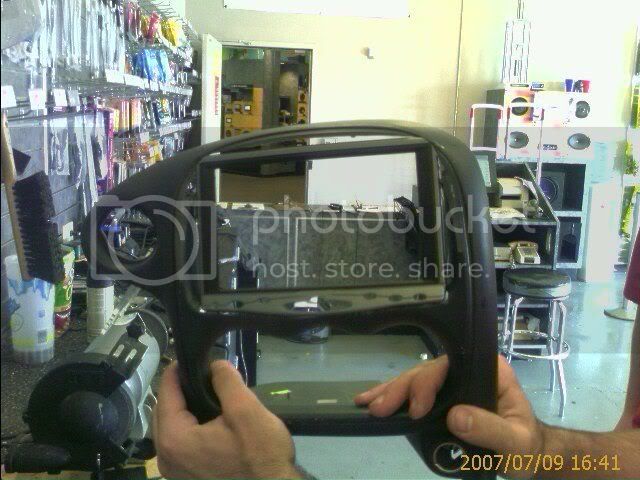

Heres some shots of the dash fabrication to give you an idea.
Thats the front bezel of the lcd mounted in so the rear housing (containing all the guts) can just screw on //content.invisioncic.com/y282845/emoticons/smile.gif.1ebc41e1811405b213edfc4622c41e27.gif
