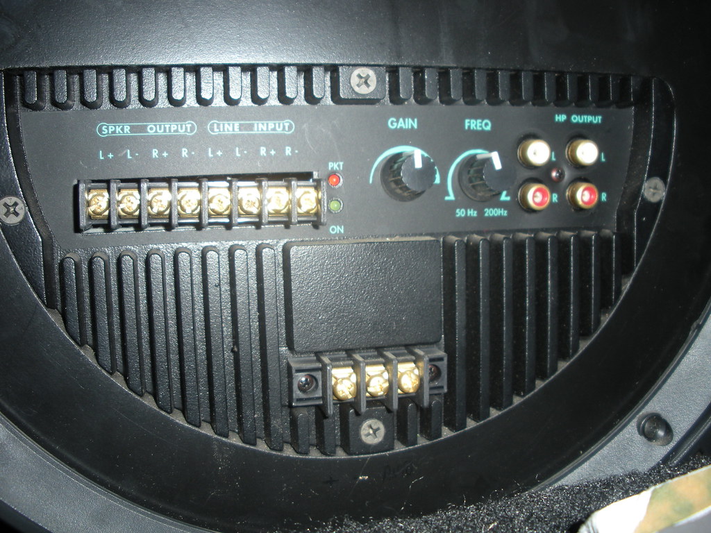

I need help with wiring a tube sub with an amp that is integrated(or already installed) into the sub. The brand is Hollywood sound an I've searched looking for help but I thought this might be the best place to look for help. Below is a picture of the pre-installed Amp. Any help would be appreciated thanks.
I was also wondering if this needed wire for power, ground and remote and which of these would that be..?
Also does this have an input for the RCA? I see the output, but is the input to the left of it?
Model of the car is a : 95' Toyota 4Runner
That's like a line output converter I'm assuming, run speaker wire from those to the wiring for the rear speakers.
Basically I want to test this thing out, I already have an regular amp and an enclosed sub setup in the car but was wondering what this would sound like.. so I need to know what wires would go where... *****This is a Tube Sub- with an amp or ( output converter pre-installed)****
I need help with wiring a tube sub with an amp that is integrated(or already installed) into the sub. The brand is Hollywood sound an I've searched looking for help but I thought this might be the best place to look for help. Below is a picture of the pre-installed Amp. Any help would be appreciated thanks.I was also wondering if this needed wire for power, ground and remote and which of these would that be..?
Let me correct myself for not reading completely. //content.invisioncic.com/y282845/emoticons/crap.gif.7f4dd41e3e9b23fbd170a1ee6f65cecc.gif
Line input would be if you ran wire from your rear speaker channel on the head unit to the amp. This would be for if you had a factory radio.
Next to the output on the left should be the input.
