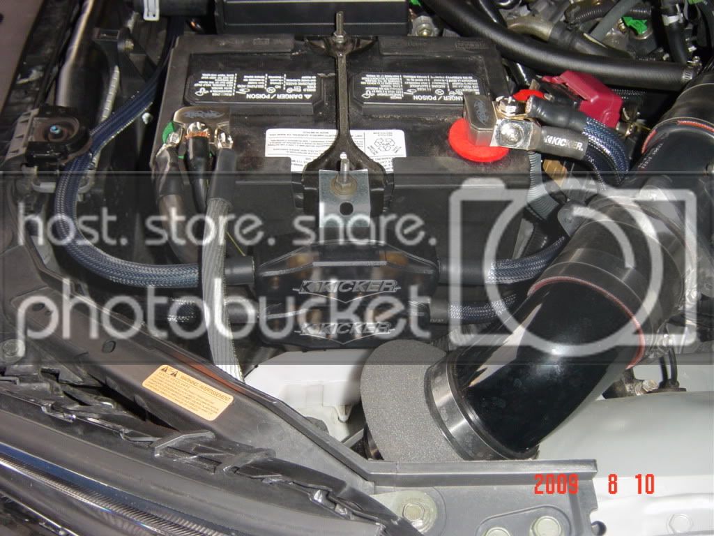

Does anybody know where to find a 4-way battery post?
I will be needing one soon for wiring.
Googled it and all..

BINGO!!! That's perfect for attaching my 2 way ring terminals I have planned!//content.invisioncic.com/y282845/emoticons/biggrin.gif.d71a5d36fcbab170f2364c9f2e3946cb.gif
in the bottom where you have the back battery going to "car frame ground"
you dont want to ground it you wanna have another run of wire from the starting battery negative to here.. not to the frame

http://img230.imageshack.us/img230/8129/newwiringdiagram.jpg
i suppose if ugly and messy is what you're going for, its perfect... //content.invisioncic.com/y282845/emoticons/rolleyes.gif.c1fef805e9d1464d377451cd5bc18bfb.gif
You fail at wiring 101. You need fuses on each of those power leads. Those are grounding blocks, not power distros. It's fine for the ground, not for the power side. You need a power distro with fuses.[/img]
its stock wiring.. you're an idiot.. //content.invisioncic.com/y282845/emoticons/rolleyes.gif.c1fef805e9d1464d377451cd5bc18bfb.gif
there is a fuse on the 0ga power cable running from the positive distro to the back of the car..
and you don't need fuses for everything!
Please, how you figure it's ugly and messy just because you don't like it?
Sure, there are more attractive alternatives, but they are functional, and they work.
I don't have the room in my engine compartment for a large fused distro block, and ground distro block. I needed something I could get 3-1/0 terminals onto, and these fit the bill nicely.
You have to many fuses and why are the breakers in the trunk not under the hood?
I'm not using too many... The main power line needs to be fused near the front battery, as well as the back battery. My amplifier doesn't have internal fuses and recommends 200A inline fuse for each. Thats where the fosgate 200A breakers come in handy, no replacing fuses, 1 for each amplifier.
