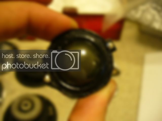

yea it sucks.. i just bought the comp set..and the tweeters only worked for about a day...but..i installed a mdf baffle and it caullked in and all that good stuff.. the company I bought it from said they will take them back but they want teh complete set back.. so id have no music in the front and who knows how long it would take to get them back...so i think im gonna just get some tweeter...i can get a pair of massive (audio ct-1's for real cheap) and see how they sound...if they sound real terrible ill just buy a new comp set...nice tweeters are almost as expensive as a whole comp set anyways.

would you sell or give away the tweeter cup/housing of your PG RSD's?
I took mine out and dont know what the installer did with them.
the part that this sits in
