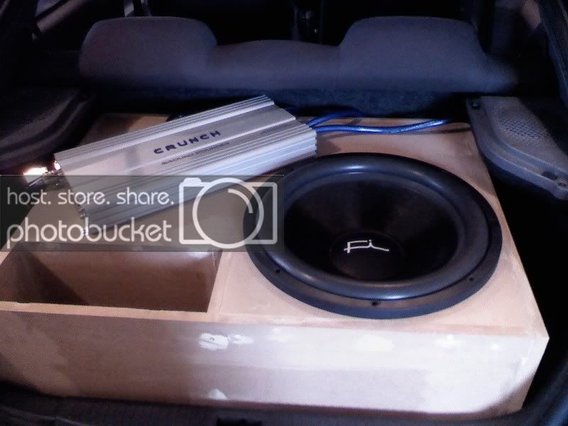

What would you like to know? 18" BTL firing up, port up, amp mounted to the top of the enclosure. The enclosure has like 2.5-3" clearance between it and the cargo cover panel so that's enough room for the amp as well as the sub's excursion. The panel moves quite a bit when it's wanging but it still sounds great, gets hella loud, and is completely concealed. Also yes the spare tire sits in the back seat because I have a huge battery in the spare tire well.
This was before paint and with my old amplifier (that I toasted). It's 5.8 net and over 7 gross, tuned to 32hz.
