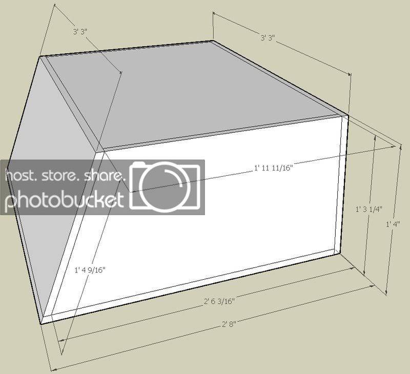

F fbi90909 5,000+ posts Panty Thief 8,530 0 Key West, FL Sep 18, 2008 #16 negative.... ^^^^ i got it, posting in a minute just gotta get the lenghts shown.
IDSkoT 5,000+ posts Resonating Reticular 6,522 1 Miami, Florida Sep 18, 2008 #17 That's a 67 degree angle with the hypotenuse extending 18".

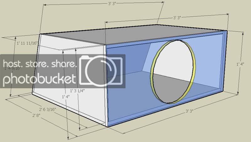

F fbi90909 5,000+ posts Panty Thief 8,530 0 Key West, FL Sep 18, 2008 #18 here you go. your rear board is set with a 67 degree angle. i don't know what speaker or how many it's for so i just put a circle for a single 15. can i has sig space ? //content.invisioncic.com/y282845/emoticons/tongue.gif.6130eb82179565f6db8d26d6001dcd24.gif
