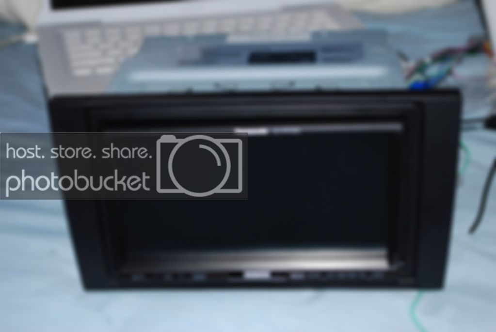

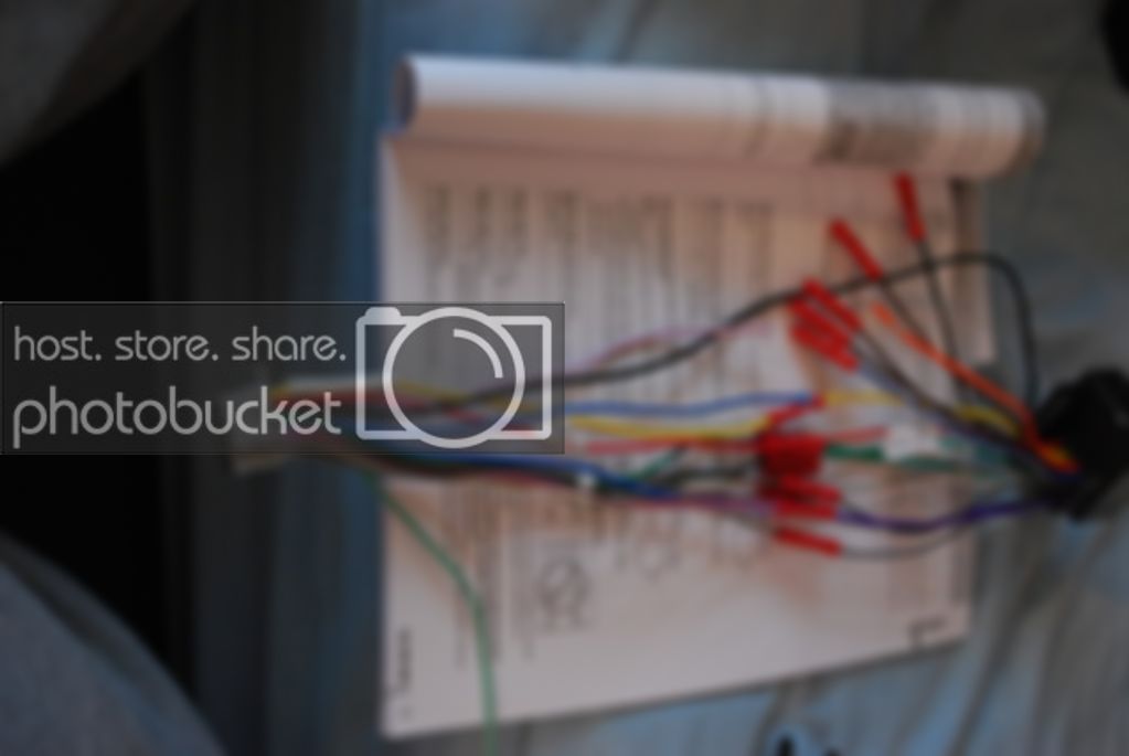

Ok i know pictures always help so after a little modding of a single din dash kit heres my double din all ready to go in, or so i thought.
the wiring kit i got from ebay which was way wrong.

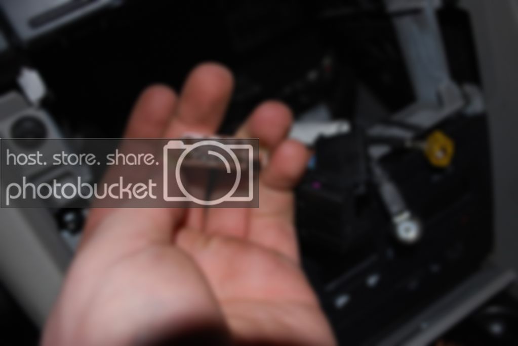

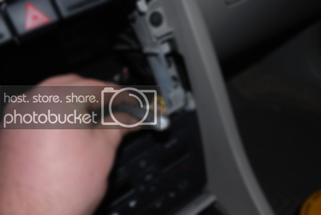

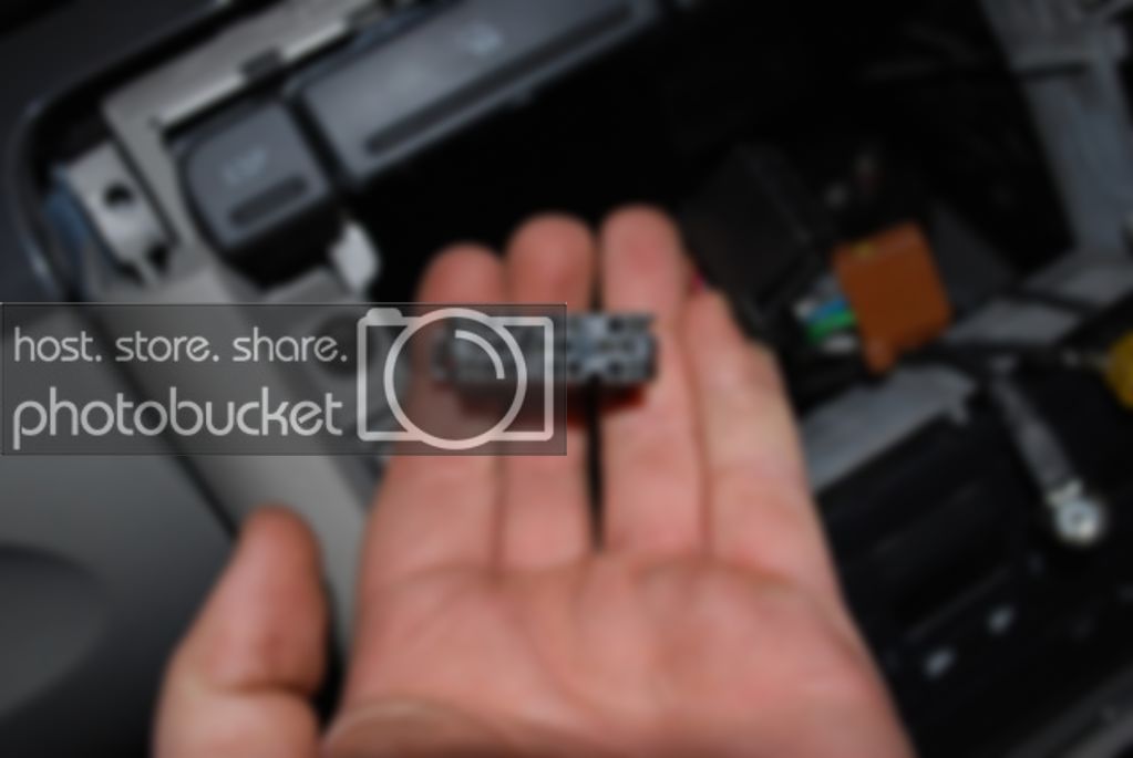

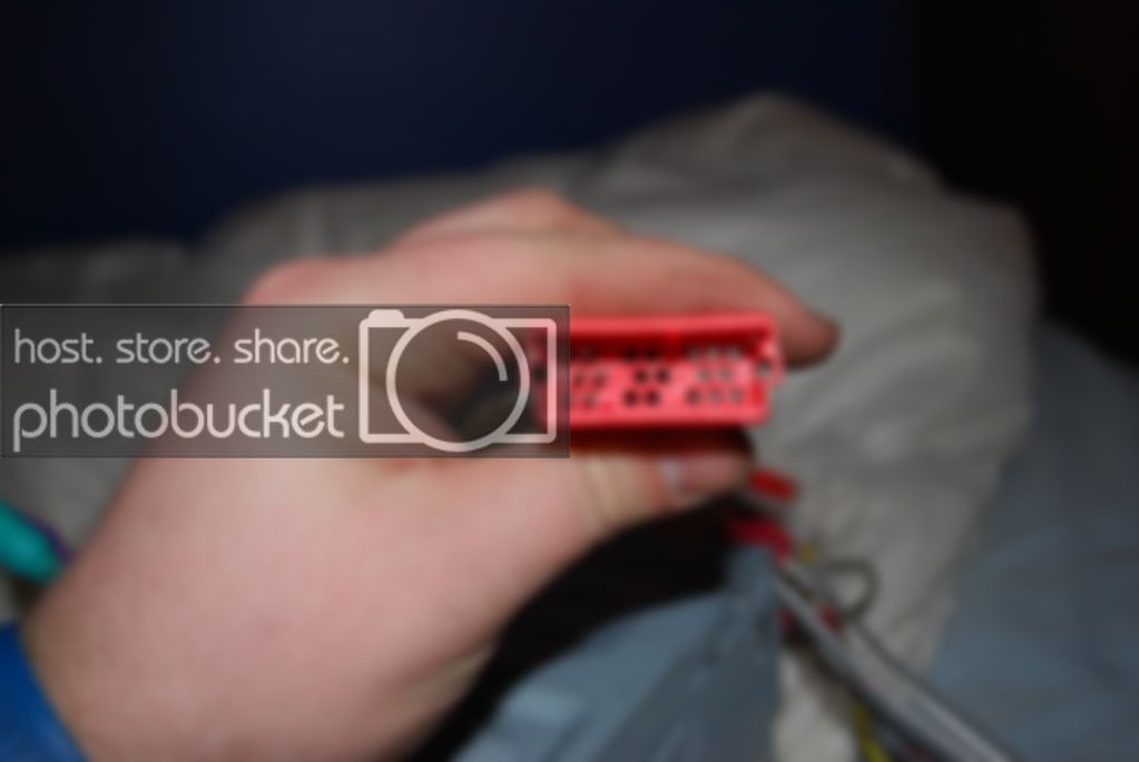

Heres the plugs that are in the car...

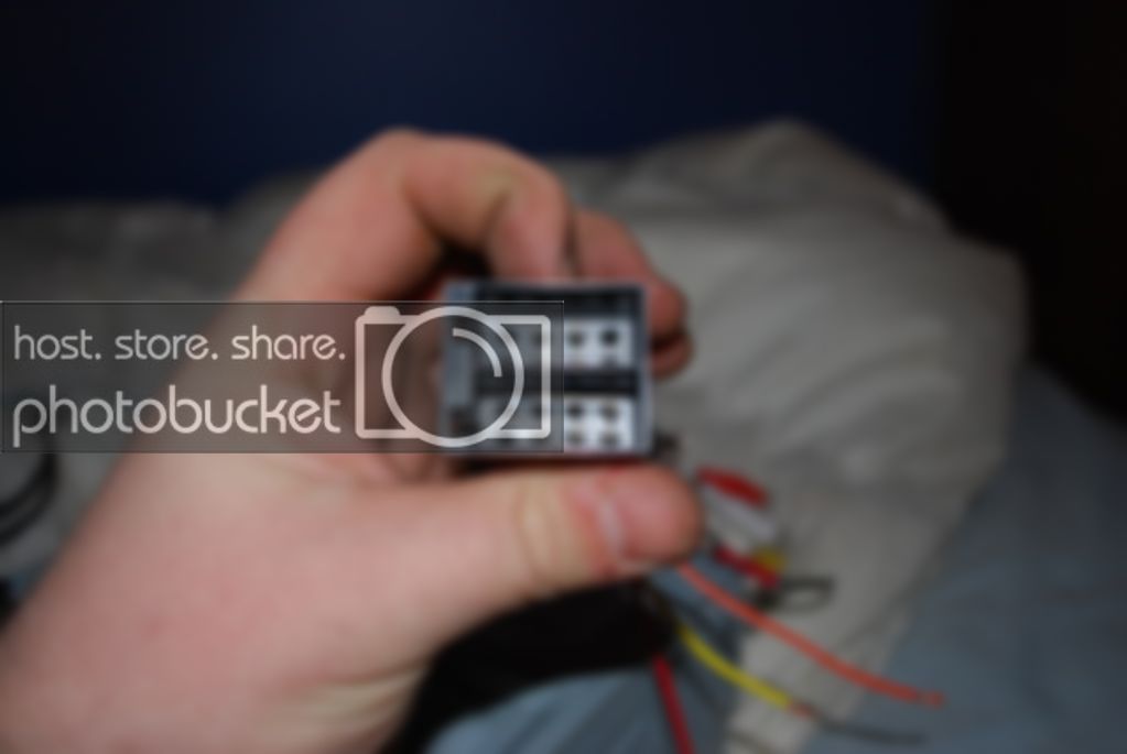

Then here are the plugs from the second kit i got that dont work either.

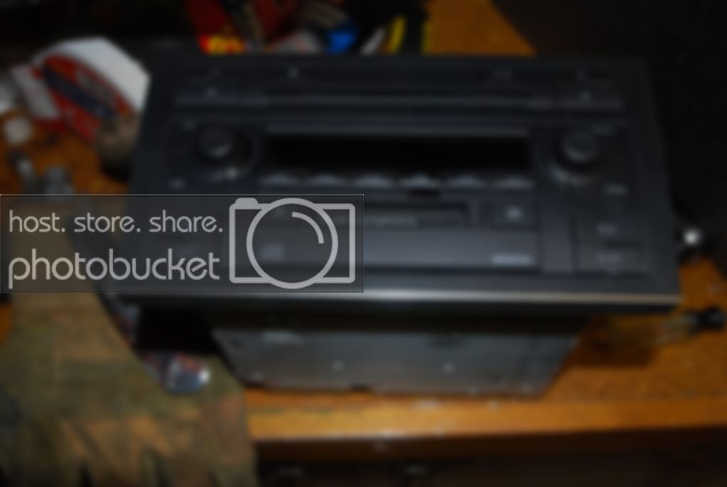

And heres the radio
