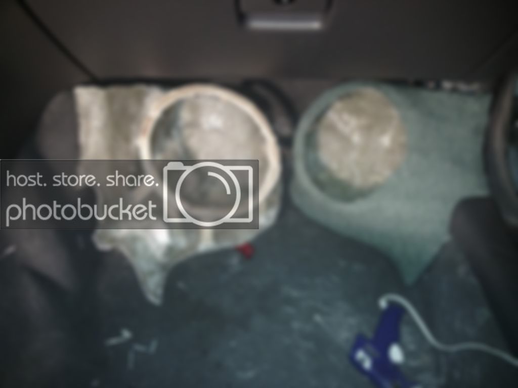

A layer of mat and vinyl wrap, these should be good to go. I'm considering using Velcro to hold the panel in place.
Then on to the amp rack... All that's left of the amp rack is mounting the plexiglass, carpeting the inside and mounting the amps.

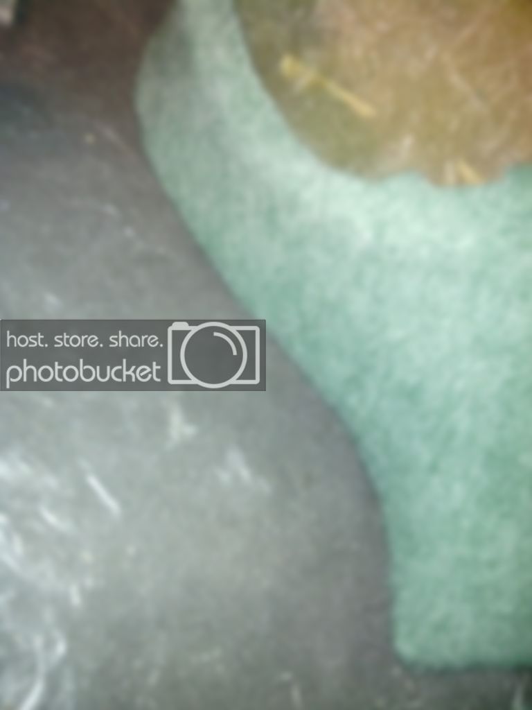

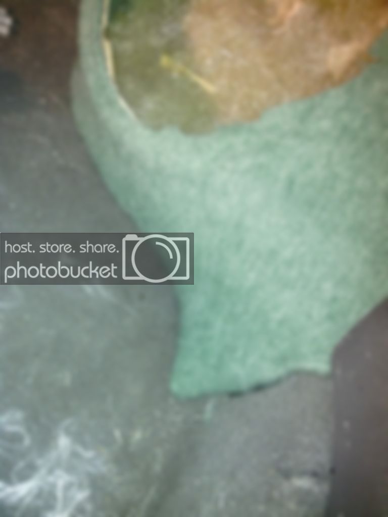

Flush to carpet

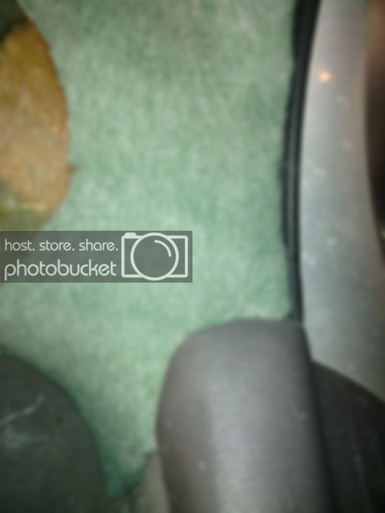

Tiny gap. May bondo it, but i don't think it's enough to cry about.

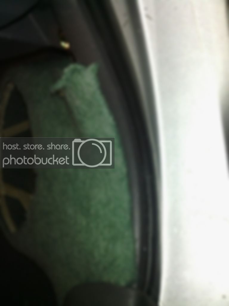

Nice fit with the rail panel
Somewhat decent fit with the a pillar. Again i don't think it's enough cry about.
