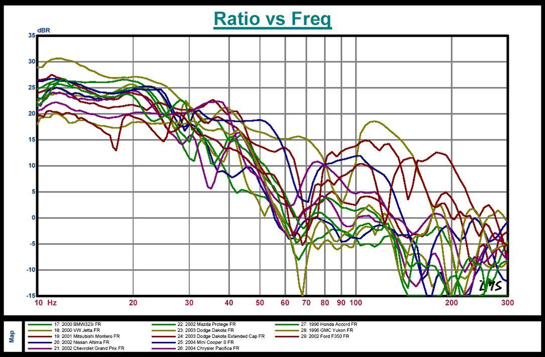

This is my FR.
A bit of a jumbled graph but you can see that around 40hz Those cars have their peak frequency then plummet in spl.
[quote name='dailyrider123']So does that mean my bandwidth falls off around 41hz ? How do I know how low it goes? @The Camry[/QUOTE]
No, Sealed boxes simply give you a flat response and i believe they have better low frequency extension. You'd have what is essentially my FR without the box peak hump. You'd roll off between 25-32 hz.
The only way to know is to do a freq sweep. A basic mic and Roomeq. Even a cheap one should work as long as it can take the spl pressure. Dont do it very loudly
