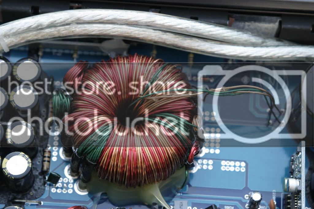

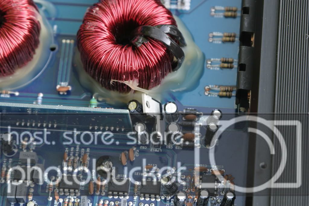

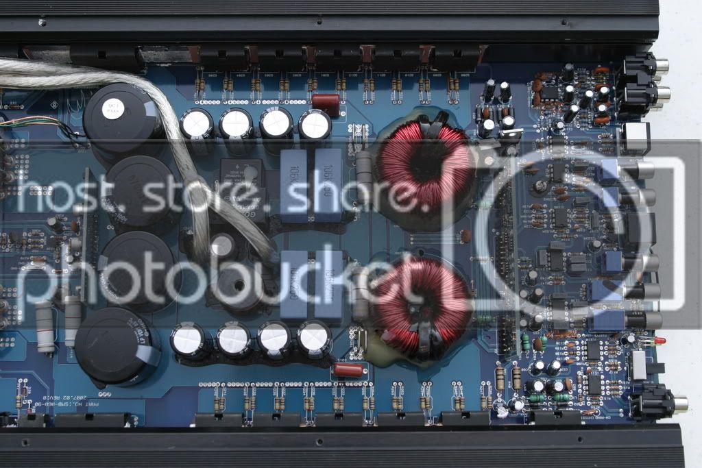

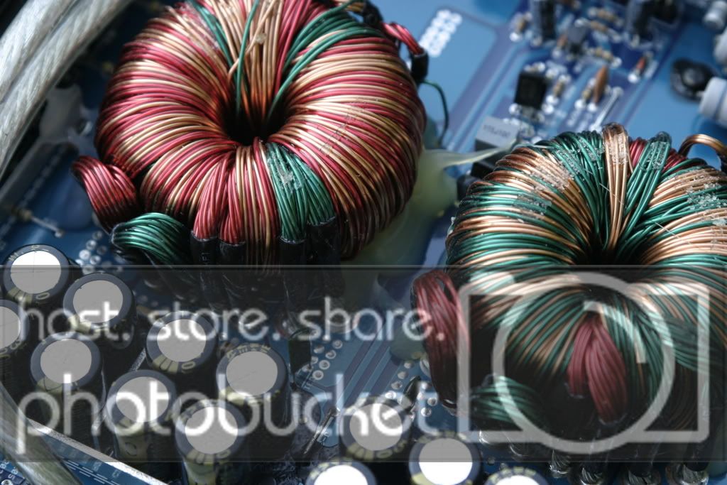

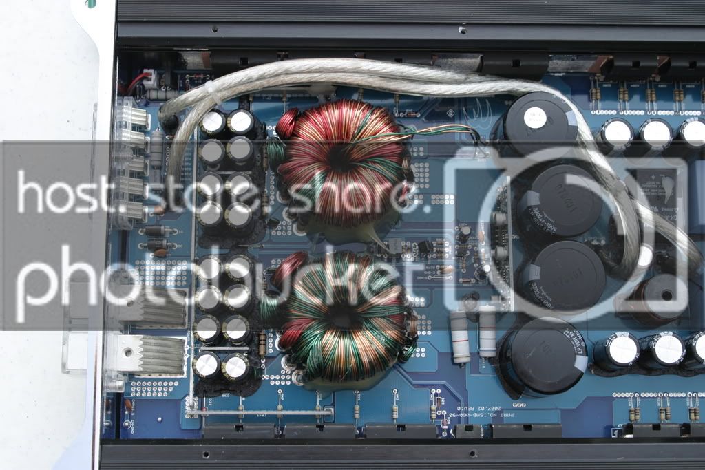

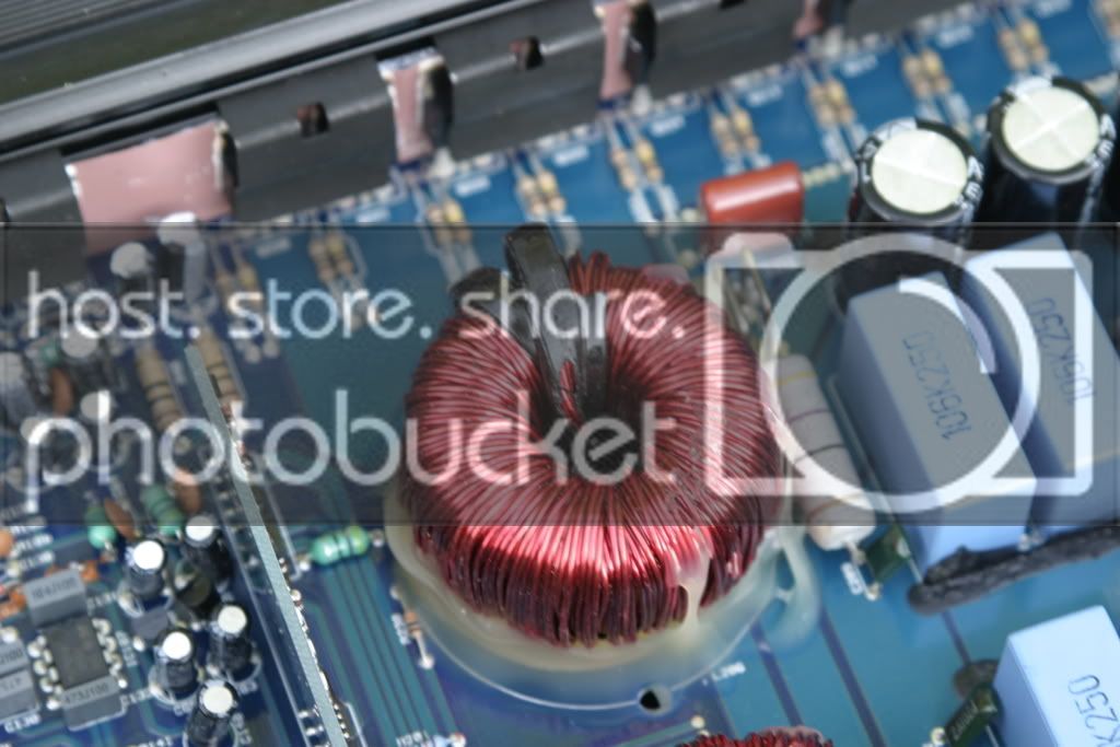

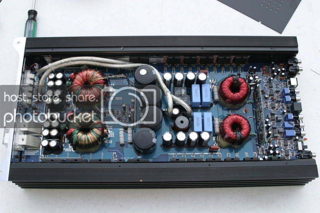

yea, well dont get me wrong its not like my amp was flexing or vibrating very violently or anything, it just vibrated, kinda felt like a phone on vibrate, to the touch. Assuming its not under warranty or anything, should I open it up and see if there's anything obvious? Or is there any reason I shouldn't?
I honestly don't really know what I'm looking for, so any help appreciated...I can't find anything that looks particularly damaged or that obviously is a problem
