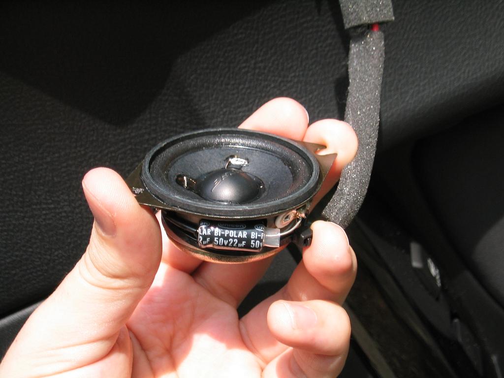

because your cheap tweeters probably had caps on them (capacitors)
that looks something like this
