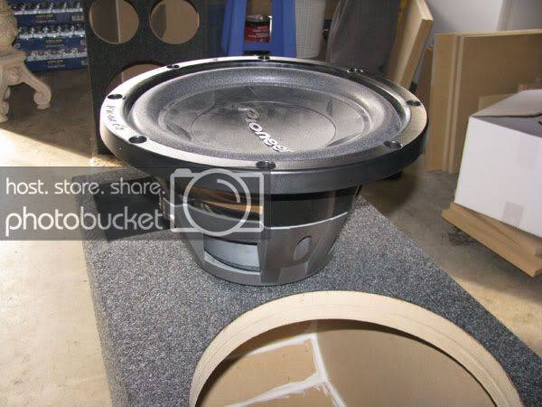

I've been doing some major testings with many various boxes. Anybody in socal that wants to try out some boxes, bring your sub to the next meet and I'll have probably 5-8 different types of boxes you can mess with. I have a lot more boxes on the way.
- Left: Single 12" Ported enclosure: 2.0 cf with an Effective 0 - 1,200 watts 35 hz ouput.
- Middle: Single 12" Ported enclosure: 2.0 cf with an Effective 0 - 2,000 watts 35 hz output, flared/bent/kerf port.
- Right: Single 10" Ported enclosure: 1.5 cf with an Effective 0 - 1,000 watts 35 hz ouput
By "Effective 0 - 1,200 watts 35 hz ouput" do you mean its optimized for that power range and the tuning is 35 hz? I've never heard it termed that way...
What that means: Roughly the amount of power than you can throw into that enclosure and retain a laminar profile without any head loss. In other words, linear efficiency. The second part of that is the effective tuning...which is 35 hz which is entirely different from calculated tuning.
