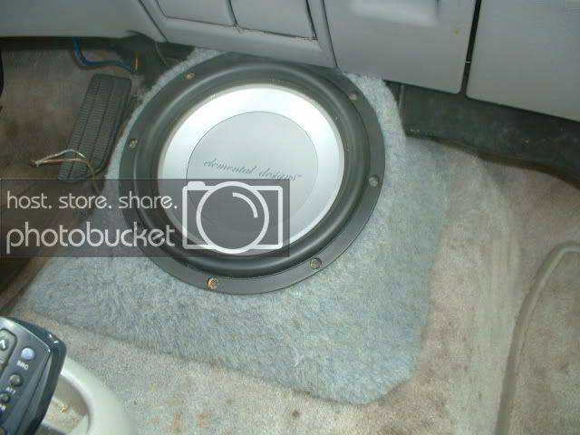

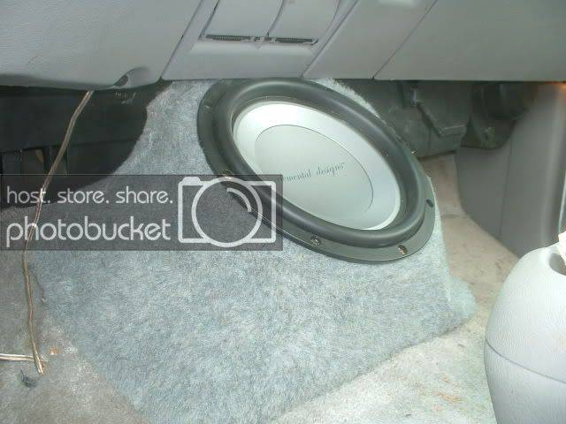

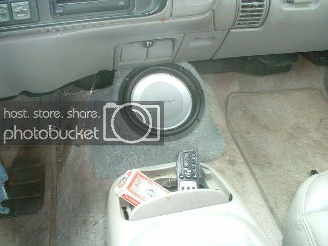

I type this with Dried Glue and Carpet on my hands, This is my new Mid Bass 8 Inch Enclosure and sub!
I couldnt find matching carpet...actually couldnt find any actual auto carpet for that matter....this is the closest I could find...im sure after a couple years of ware it will start to fade and look like the rest anyways

Is that woofer built for midrange freq? Or are you using a sub for midrange duties //content.invisioncic.com/y282845/emoticons/confused.gif.e820e0216602db4765798ac39d28caa9.gif
FYI... Midbass is stereo...
still better than having NO midbass, what are your crossover points? *edit* just saw your post, I have two RE8's behind me playing 80-150 some people will say it pulls the stage rearways but i don't notice it
looks good //content.invisioncic.com/y282845/emoticons/smile.gif.1ebc41e1811405b213edfc4622c41e27.gif it will give you a bit of bump up font, but like cj said, it won't cover your midrange frequencies and you may have some blending issues unless you have/are putting in all the same sub
edit: posted after i read original message, not his second response
Make up your mind, first you say I'm not smart, now you agree with me... What does that make you?
Rephrase that I didnt quite get it
//content.invisioncic.com/y282845/emoticons/eyebrow.gif.fe2c18d8720fe8c7eaed347b21ea05a5.gif//content.invisioncic.com/y282845/emoticons/eyebrow.gif.fe2c18d8720fe8c7eaed347b21ea05a5.gif
like, if you have two different kinds of subwoofers in the same vehicle, they would obviously play differently and may not sound right... personally, it isn't a big enough difference to matter, but people on here will advise against it...
Ahh I get it....so....any comments on the structure? //content.invisioncic.com/y282845/emoticons/smile.gif.1ebc41e1811405b213edfc4622c41e27.gif
yea i did buy it off him, Yup....now I just need an amp!
as long as he has the crossover points right then it shouldnt be a problem like take the sub woofer and set a LPF at 80 then thake the midbass and bandpass it at 80 and 150 and then set a hpf for the mids and highs crossover at 150 and it should work, might need a little tweaking but its a good start. that midbass should give you some of that good chest thumpin bass, that hits you like a real kick drum
