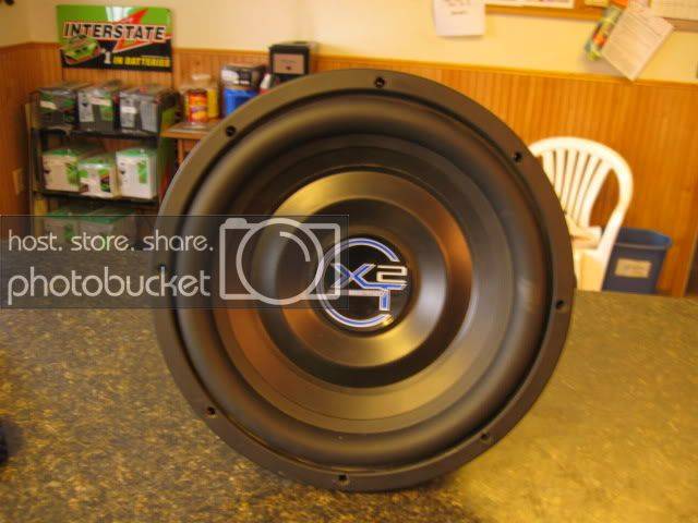

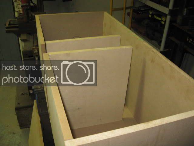

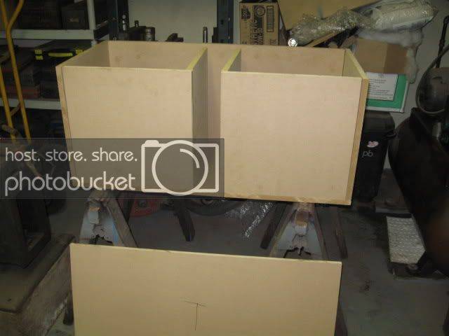

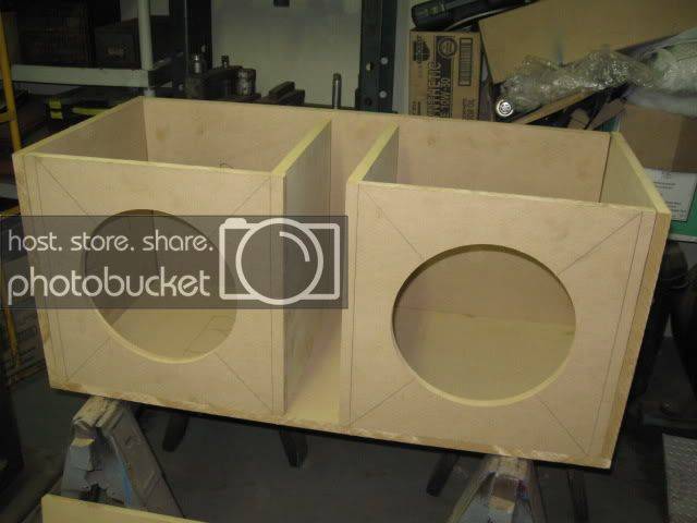

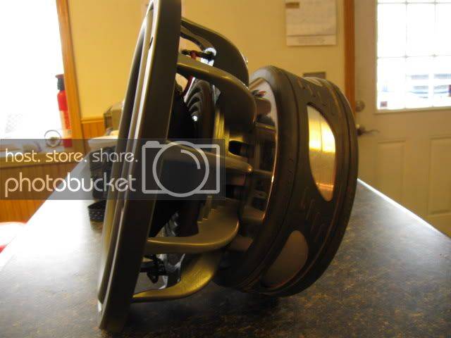

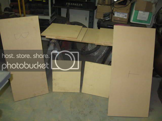

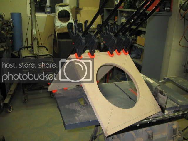

I can not find any real specs or enclosure specs for the subs (contacted crossfire and no help:() So here is what i am trying for the box 1.5" front baffle, 5.25cuft after sub and port displacment. 68sqin of port tuned to 36hz. Powering the pair with a massive p3000.1. (3000rms to the pair at 2ohms:D). I will put it on the Termlab and let ya's know how it turns out:) Here are some pics!
The wood all cut
The enclosure just setting
Pics of port from front
port up close
box with first sub cutout
1 sub baffle+half port getting wood glue-brad nailed-screws
I will get more pics up tomarrow!
Those subs are beast. There is a local shop that has a pair in his demo car out where i live and they were very impressive when i heard them.
wow, I seen the dustcap and though "Eh, looks cheap" but that thing looks beefy.. quite an *** end on it
Yah not a big fan of the dust cap:D They are 51lbs each on the scall //content.invisioncic.com/y282845/emoticons/eek.gif.771b7a90cf45cabdc554ff1121c21c4a.gif It is going to be a b!tch getting them in the truck with subs box and amp //content.invisioncic.com/y282845/emoticons/furious.gif.fc81ca146dbff91fede3ed290dbc4f4c.gif
