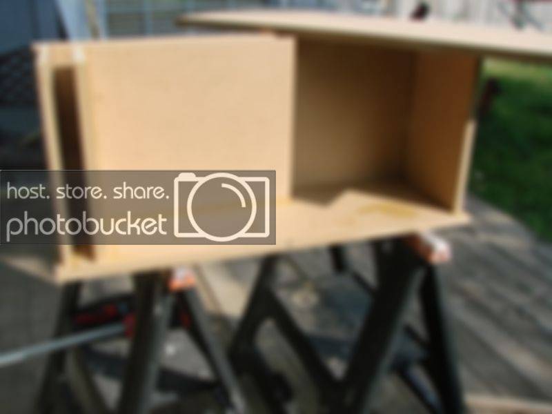

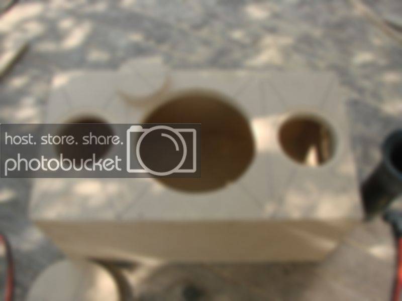

First is for a 13w7, its 3.45 cubes ported to 34 hz. Will be using 2 4" aeros

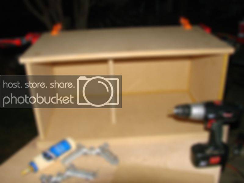

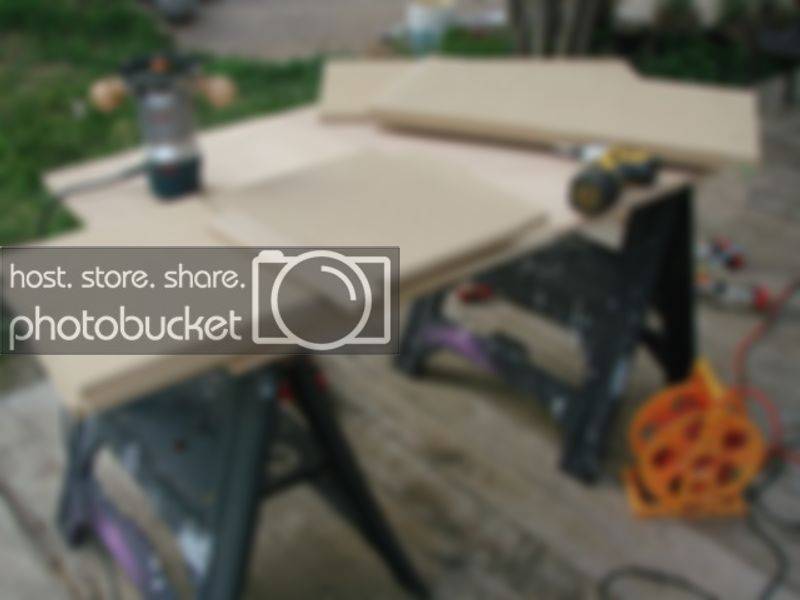

Wood cut, rabbeted, brace cut and rounded.

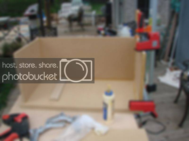

1 1/4" baffle
Almost done
Brace in, that is all for today as I had this other box and had to install the amp.

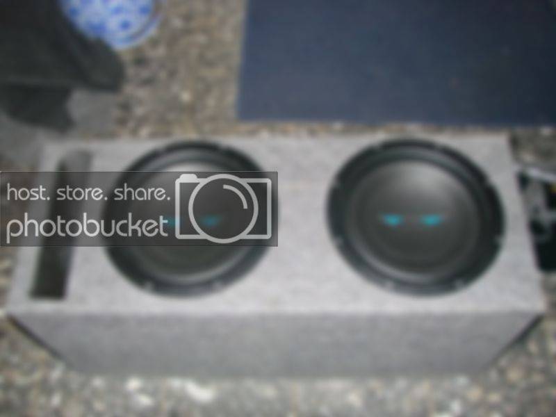

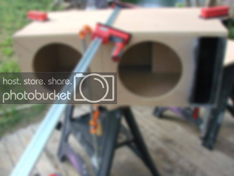

Heres a box for 2 12" IDQ's, I think it was 3.8 tuned to 30 hz

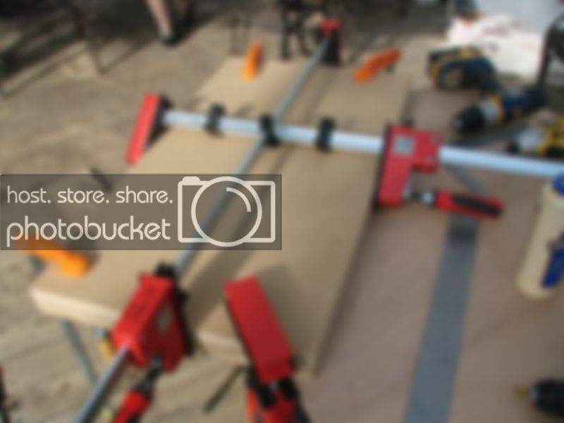

Got some new clamps the other day, pretty expensive but they are very nice.

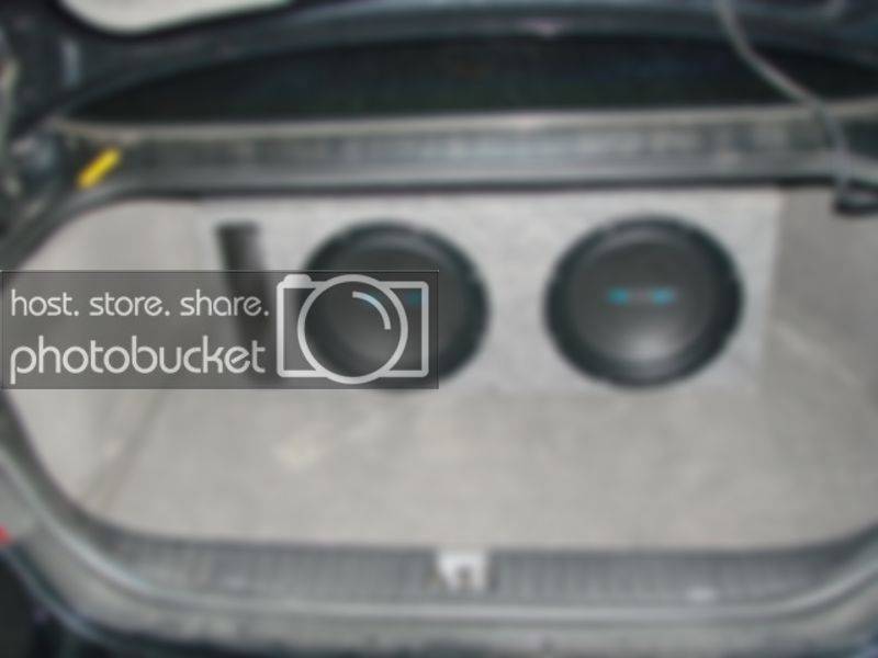

Carpeted and subs mounted
In the trunk

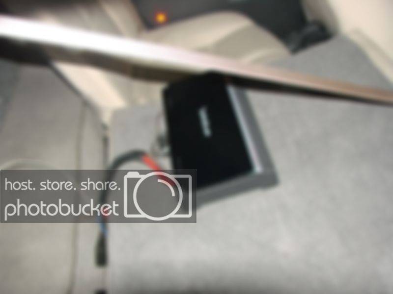

Amp kinda looks like shit, not sure why I took a picture. Got the whole amp completely installed in 23 mins. I was keeping track because it was dark and sucked.

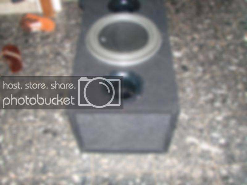

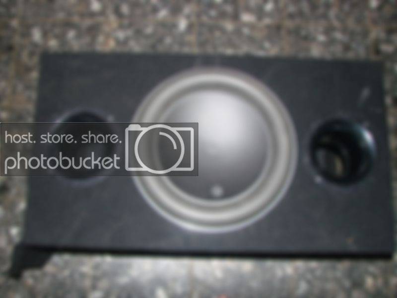

Got the w7 box done, holes cut and aero ports flushed. Its going to have black carpet with a charcoal end cap accent. Didnt finish the carpet yet.

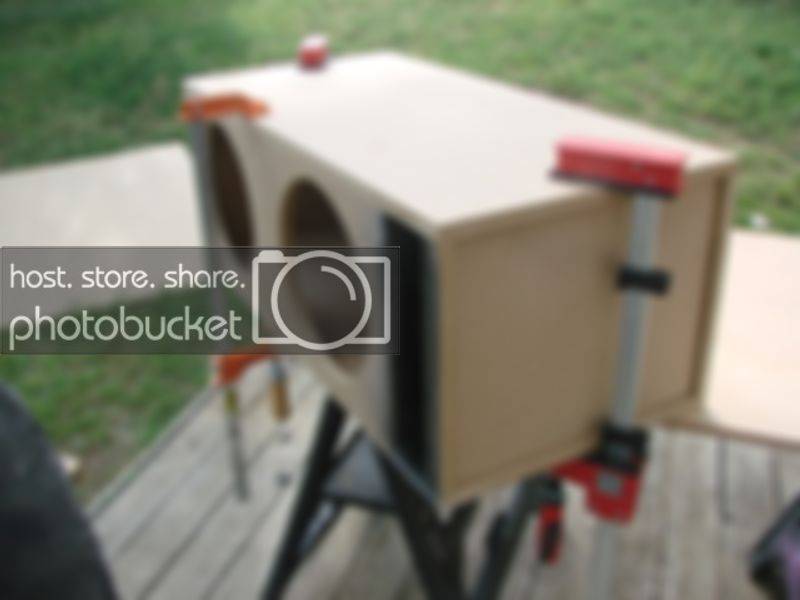

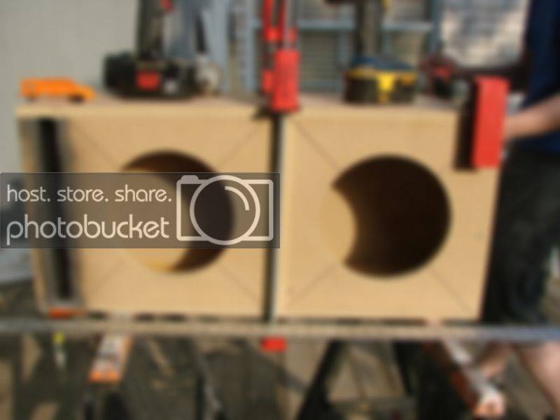

Also got started on another box, 2 cubes tuned to 32 hz for 2 alpine type-E's
Done and ready for carpet
Finally got around to finishing the w7 box, pictures before I did one last side. Also ports are just being held in with 2 screw because i dont like using drywall screws so I have some others when it comes to install time.
Accented endcaps
