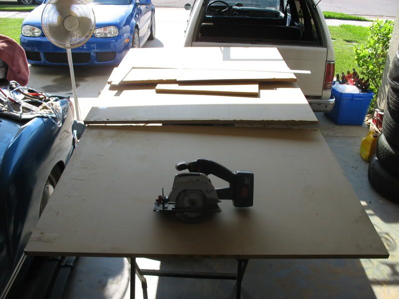

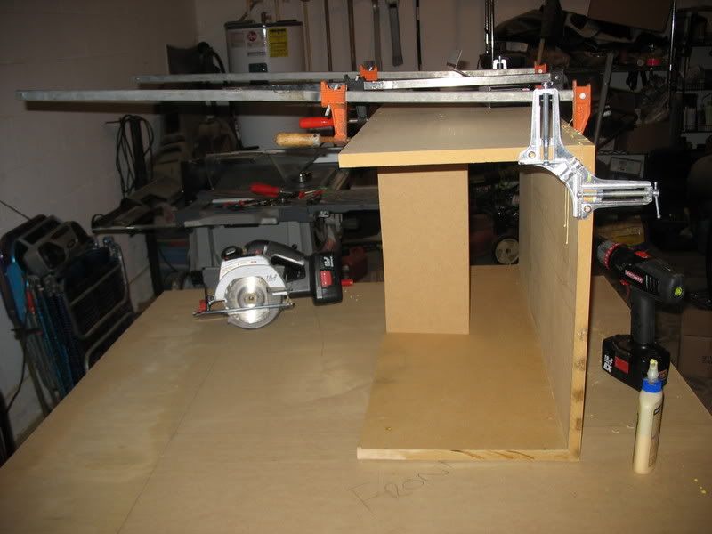

OK, after having it sit here for all theses months, I decided to build a box for my RL-p 18". The box is 5.2cubes net ported to 34hz. Powering it is a U.S.AMP MD2D @2ohms (about 1000 rms). On to the pix.............
The beginning

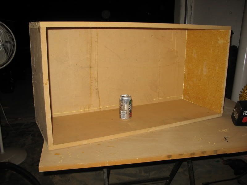

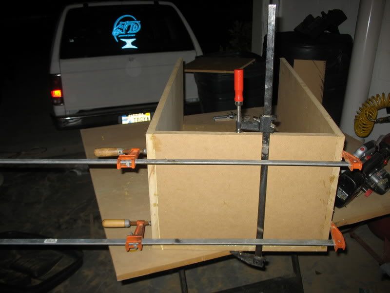

Bottom, back & front
Side
Size comparison

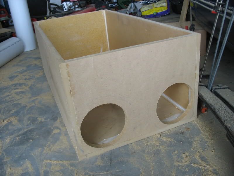

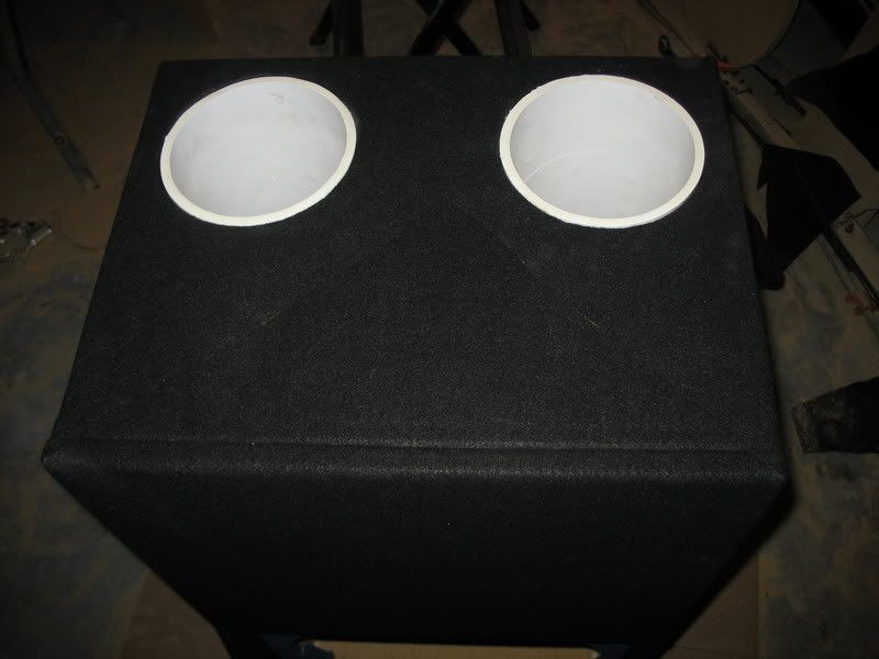

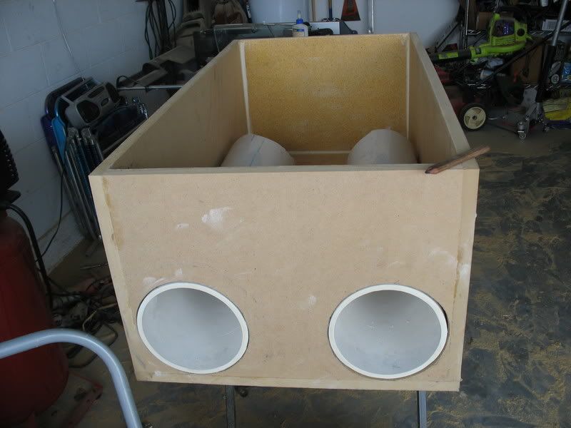

Holes for the ports (2 6" PVC)
There she is, beautiful isn't she, lol.

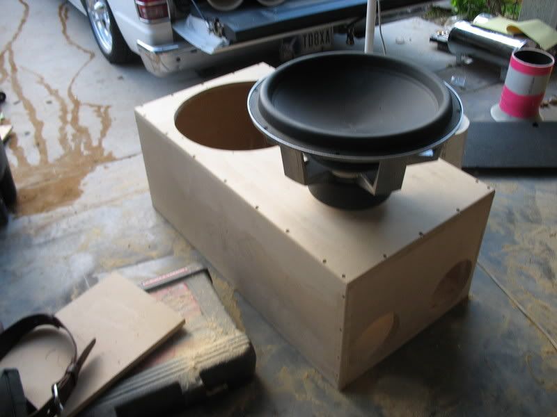

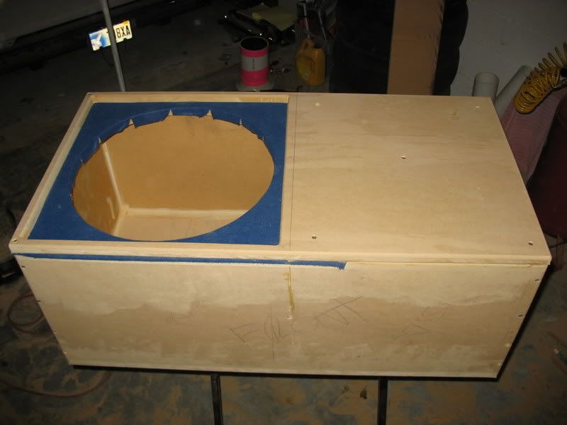

Test fit

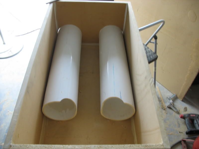

Had to notch them in order for the sub to fit.

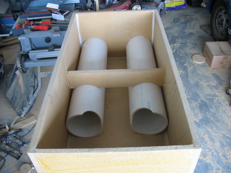

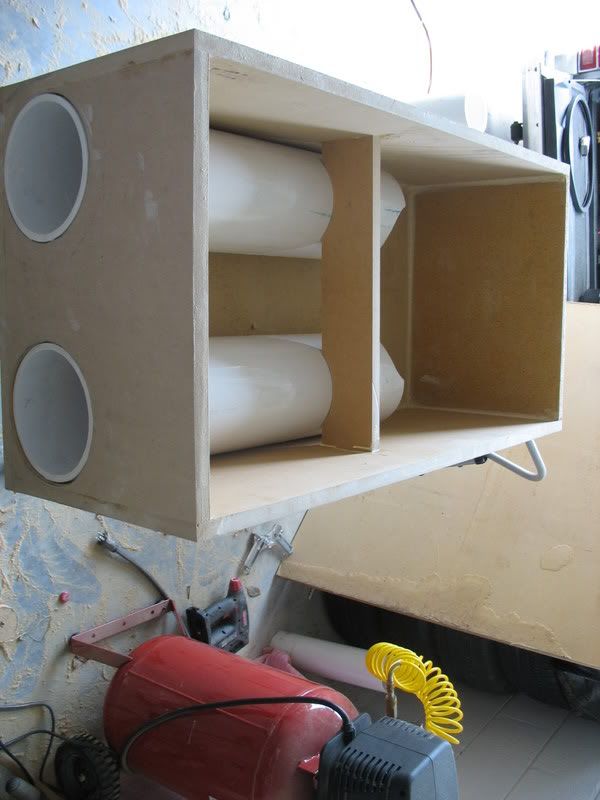

Brace for the ports & box

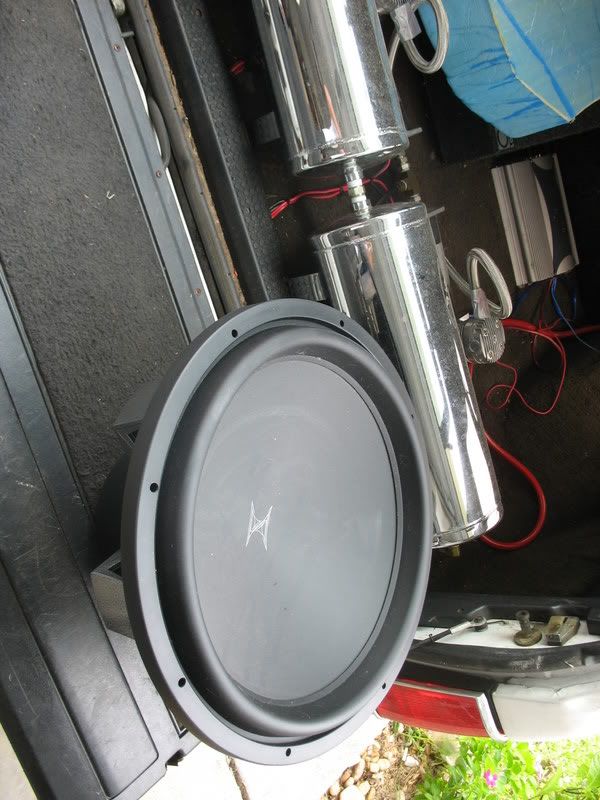

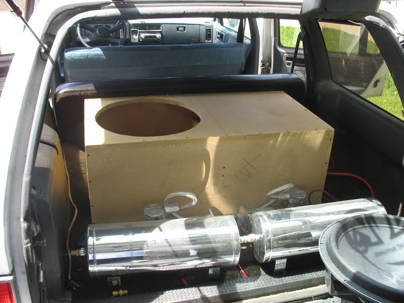

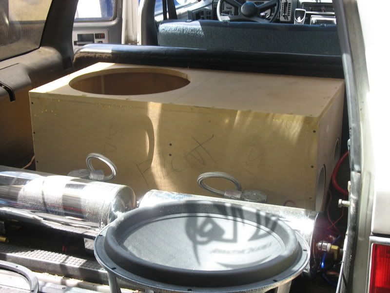

Test fit in the truck
Another angle
Getting ready to test fit her, lol
Blue
Ports. I will take these out and paint them black before I put it in the truck

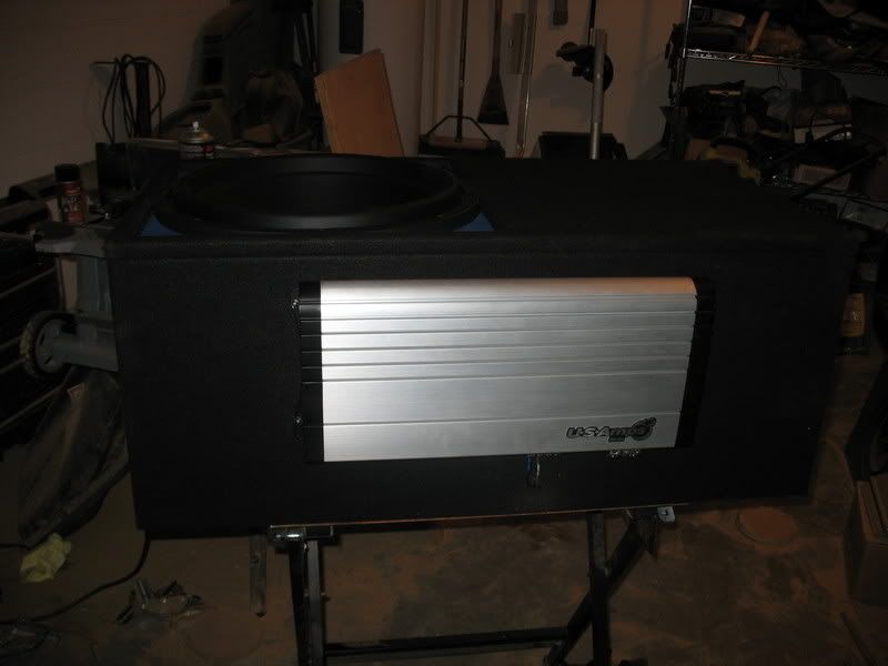

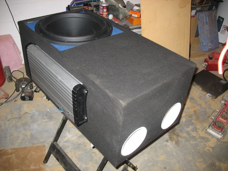

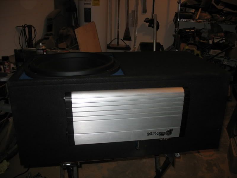

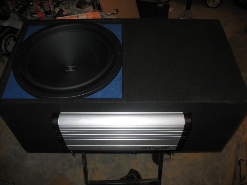

Finished product.
