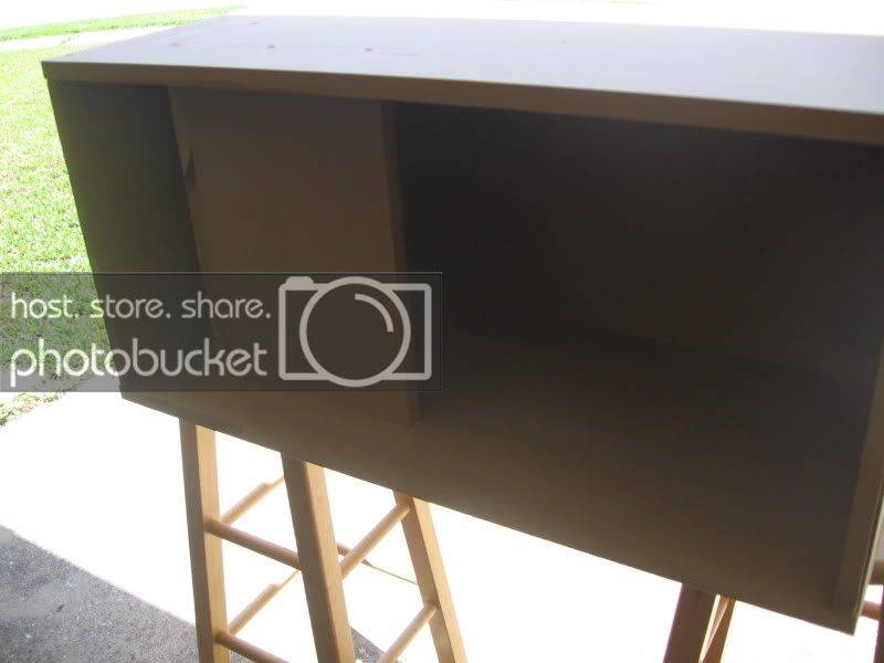

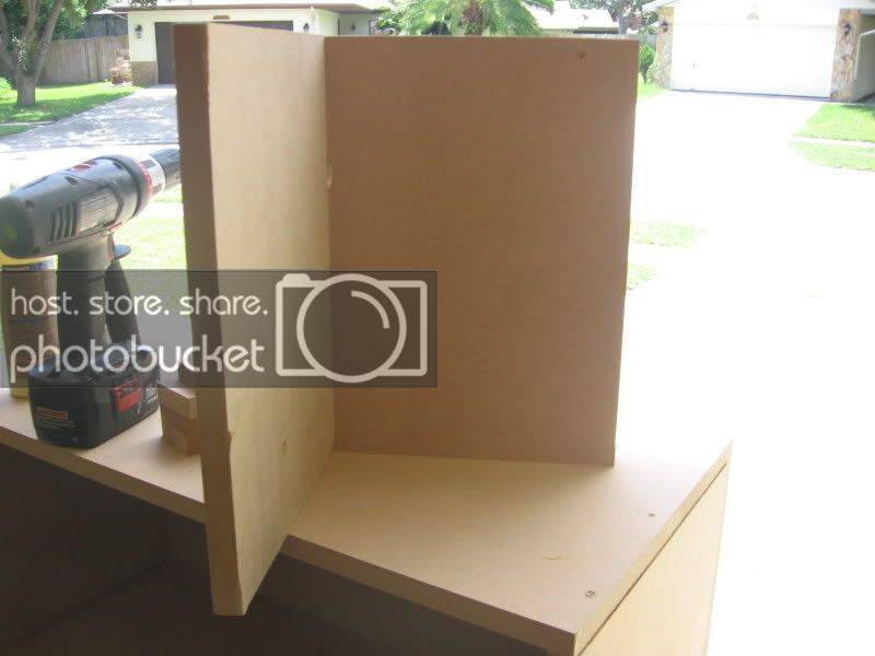

Build is for 2 10" Kicker CVXs. Box is 3 cubes with 42.5" of port tuned to 34hz. Box will be carpeted and painted port.

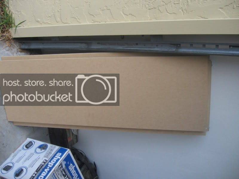

Once again... 16x48 sheets FTMFW

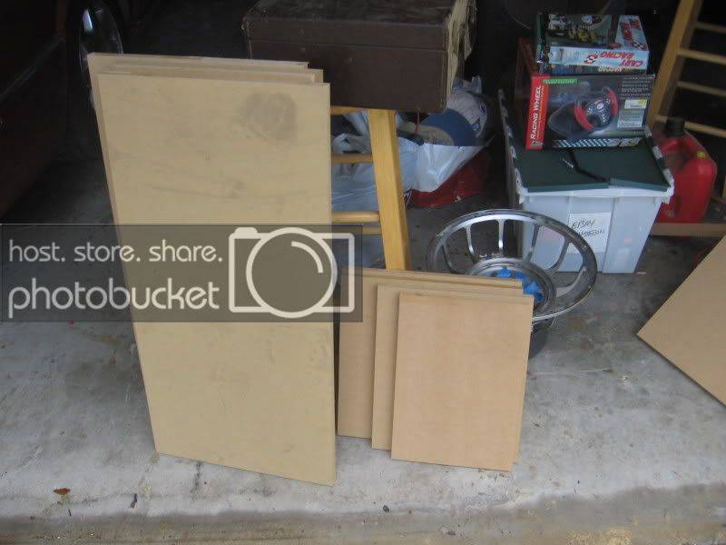

All cut

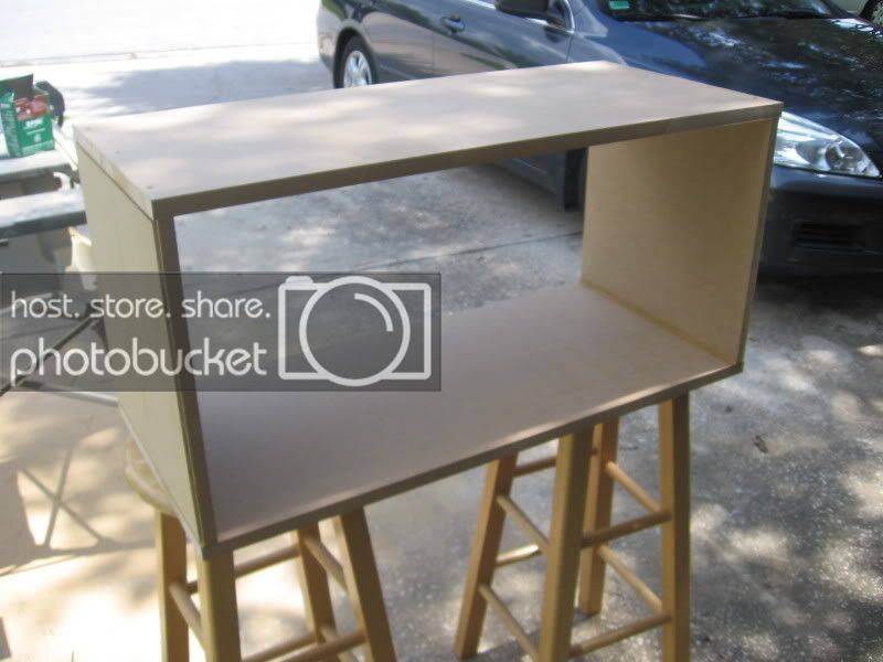

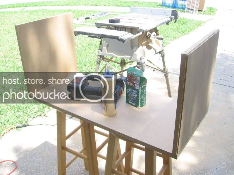

Sides Up

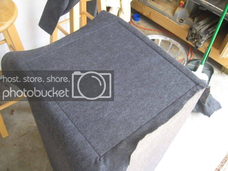

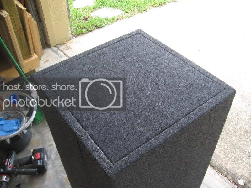

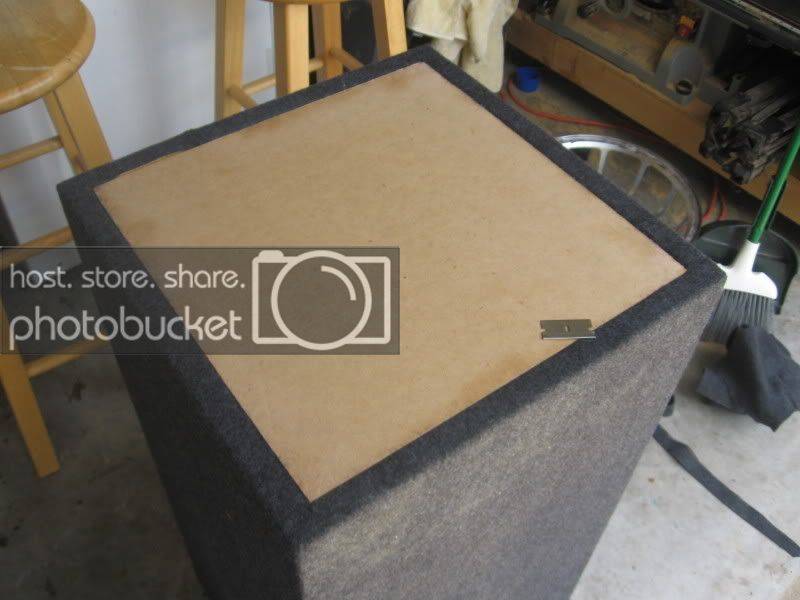

Best Technique IMO to carpet

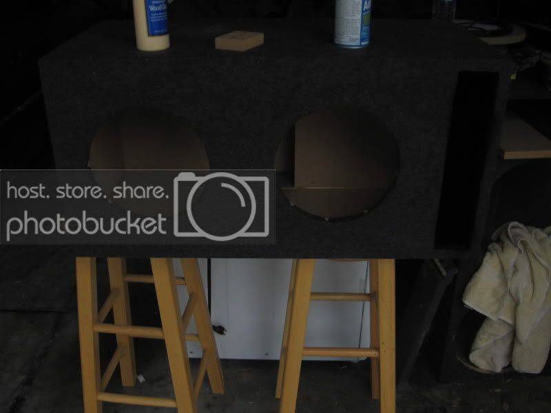

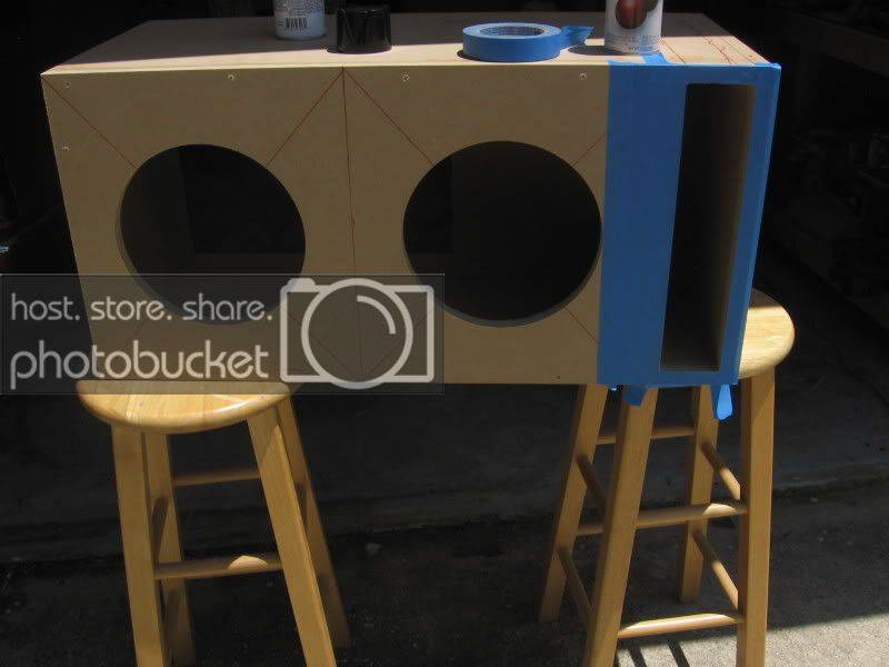

Front On

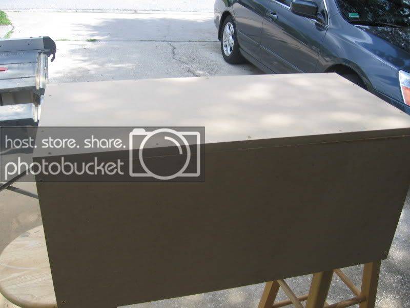

I left off here, will finish it tommorow hopefully.
i glue the seam down to the bottom when i first start the carpeting process....then when i get the second seam all the way around the box, i overlap the 2 seams. Using a straight edge, i cut through both layers, then peel up the thin strip that was was glued down, spray on some more glue and the seams line up perfect from there. I don't even touch the sides until that bottom seam is 100% perfect

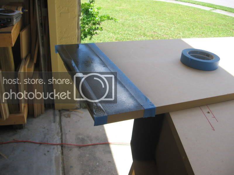

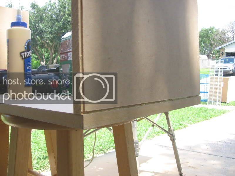

i imagine it was either a rabbitting bit or a straight cut bit in a router
Good guess....
But it really only works well with a router table, which I don't have.... So I lower the blade on the table saw to about 1/8th" and then I set the guide to an 1/8" and use that, works much better than the router.
