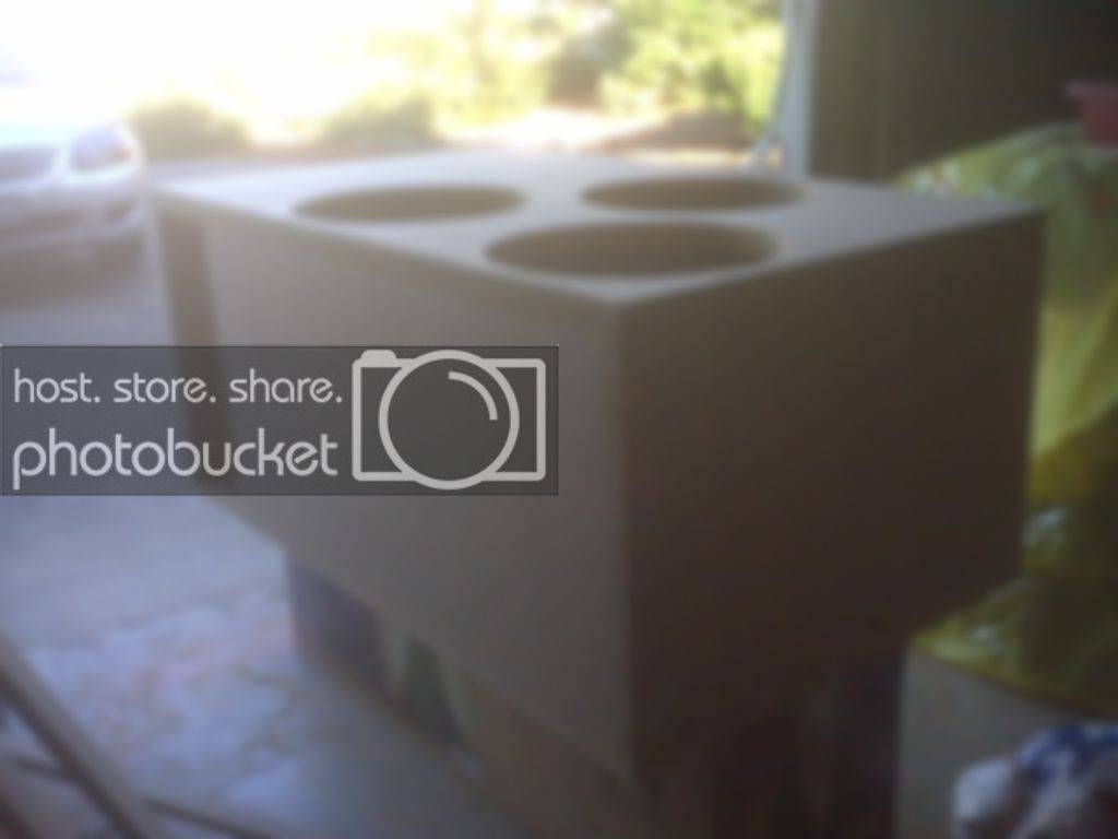

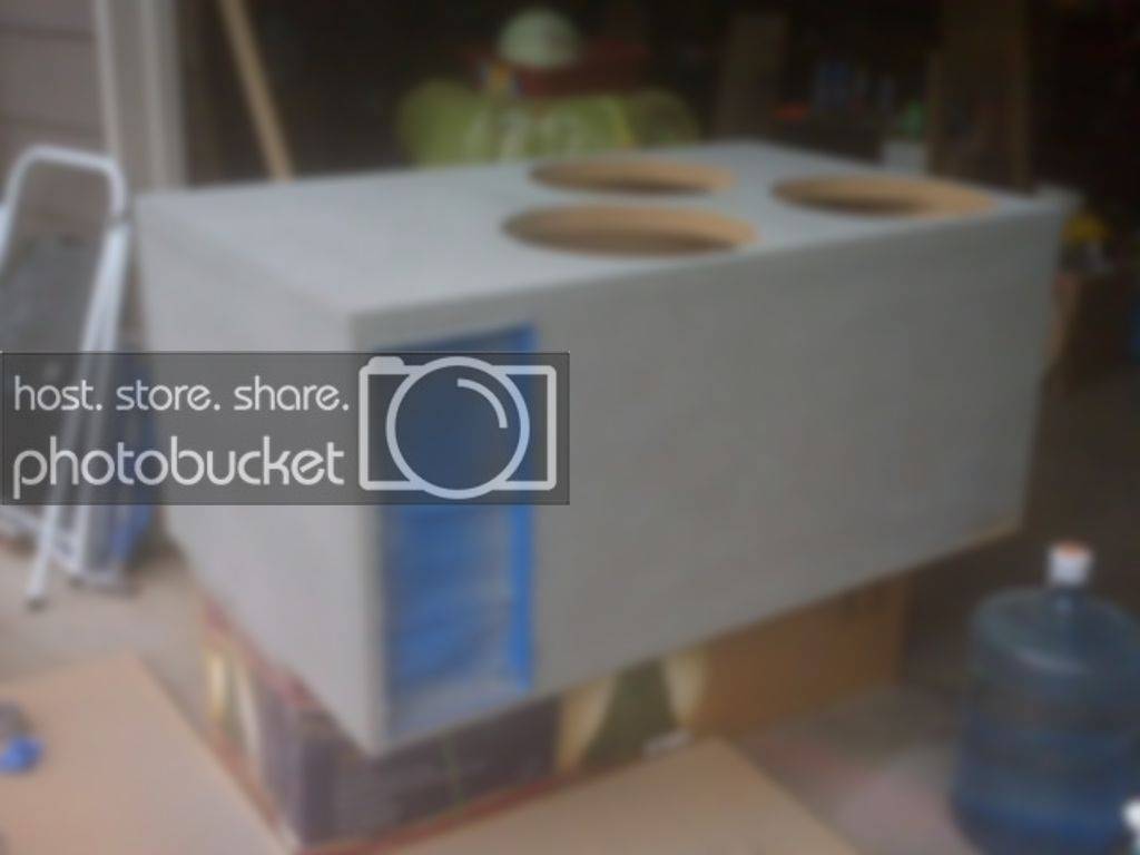

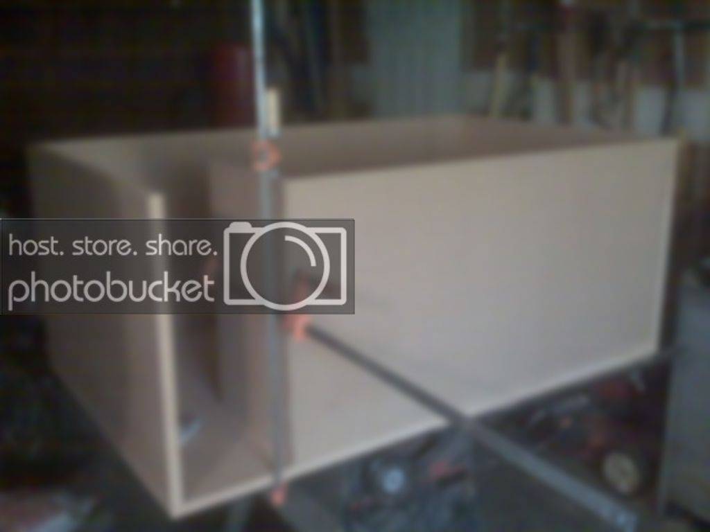

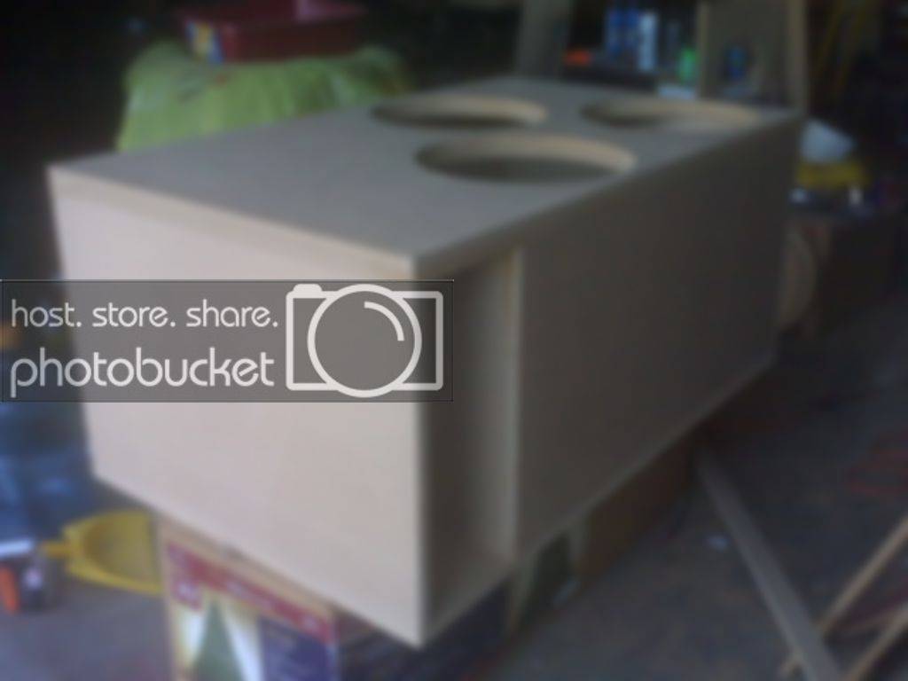

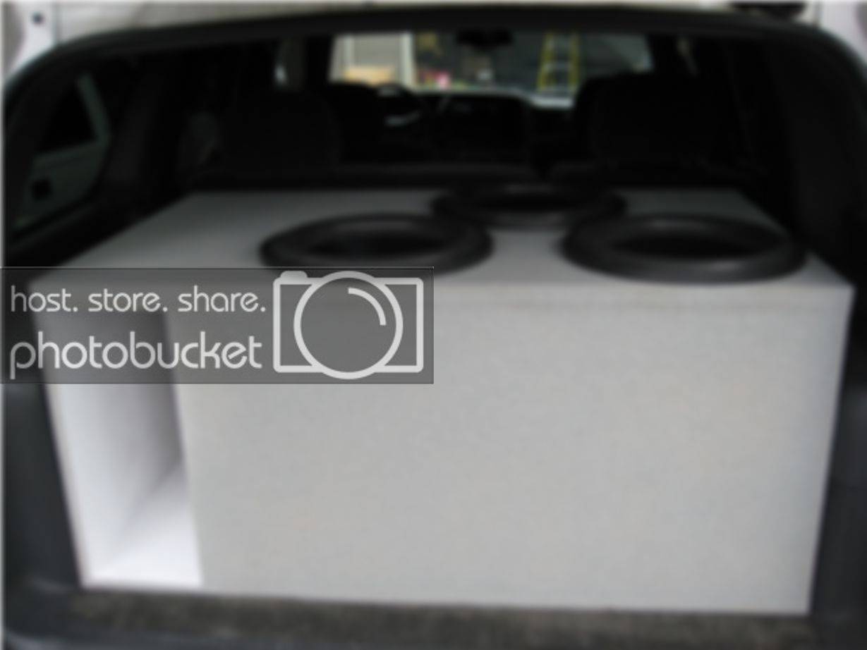

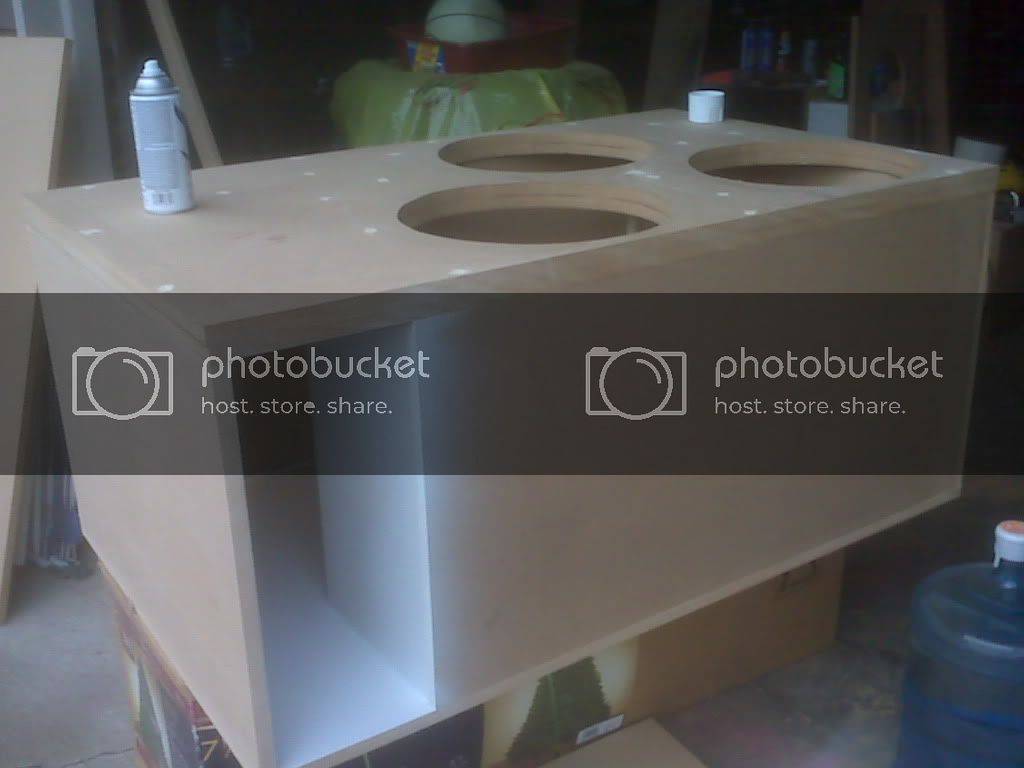

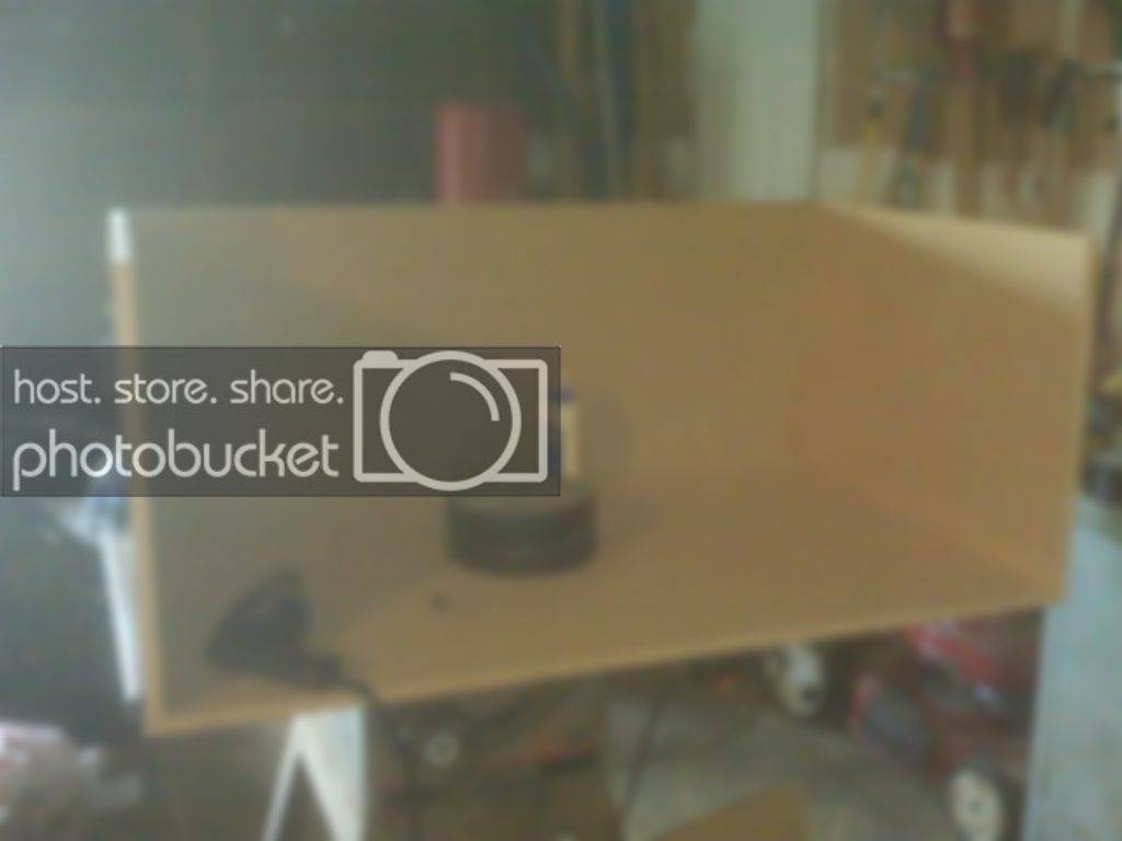

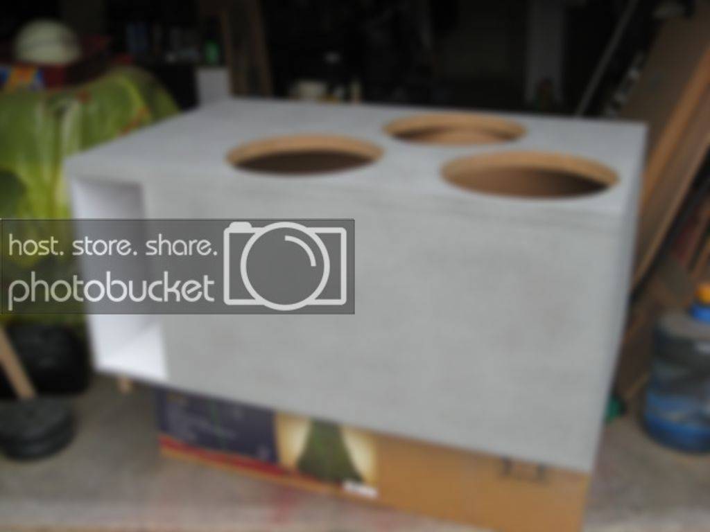

I decided to get a third lvl 4 and run my dc3000.1 @ .67 ohms. Meca comp is coming up so the box is tuned to 38hz. im going to lower the tuning after the comp. Its 14 cubes, designed by Undadog. Painted with american accents "stone" paint, they stopped selling it local so i had to order it online. Also did a few new things to the tahoe, removed the crossbars on the roof rack, and completely debaged and demolded it. Onto the pics:
Is that stone paint pretty durable? It doesn't chip off?
yeea its pretty good, i slid my old box from the blazer in/out and around all the time it was okay. But it turns to shit if it gets wet. I had my snowboard drip on an old box one time and it stained it.
Good call on switching woofer placement. The one that was going to be closest to the port probably would have unloaded real bad. Throw some black paint on the inside of your grille IMO. Looks a tag funky all white, like when homie spray paints his civic and doens't take the time to mask off the grille.

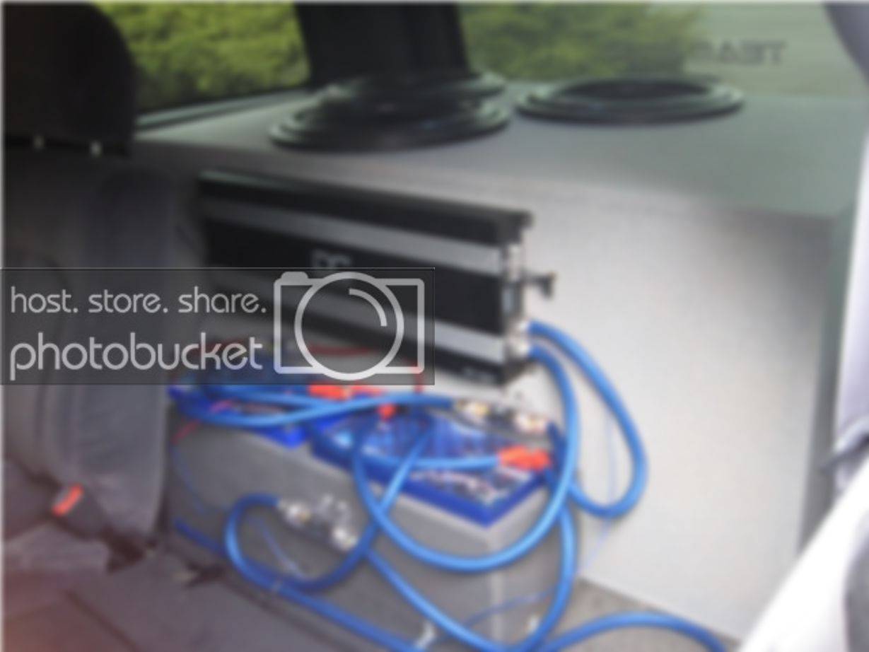

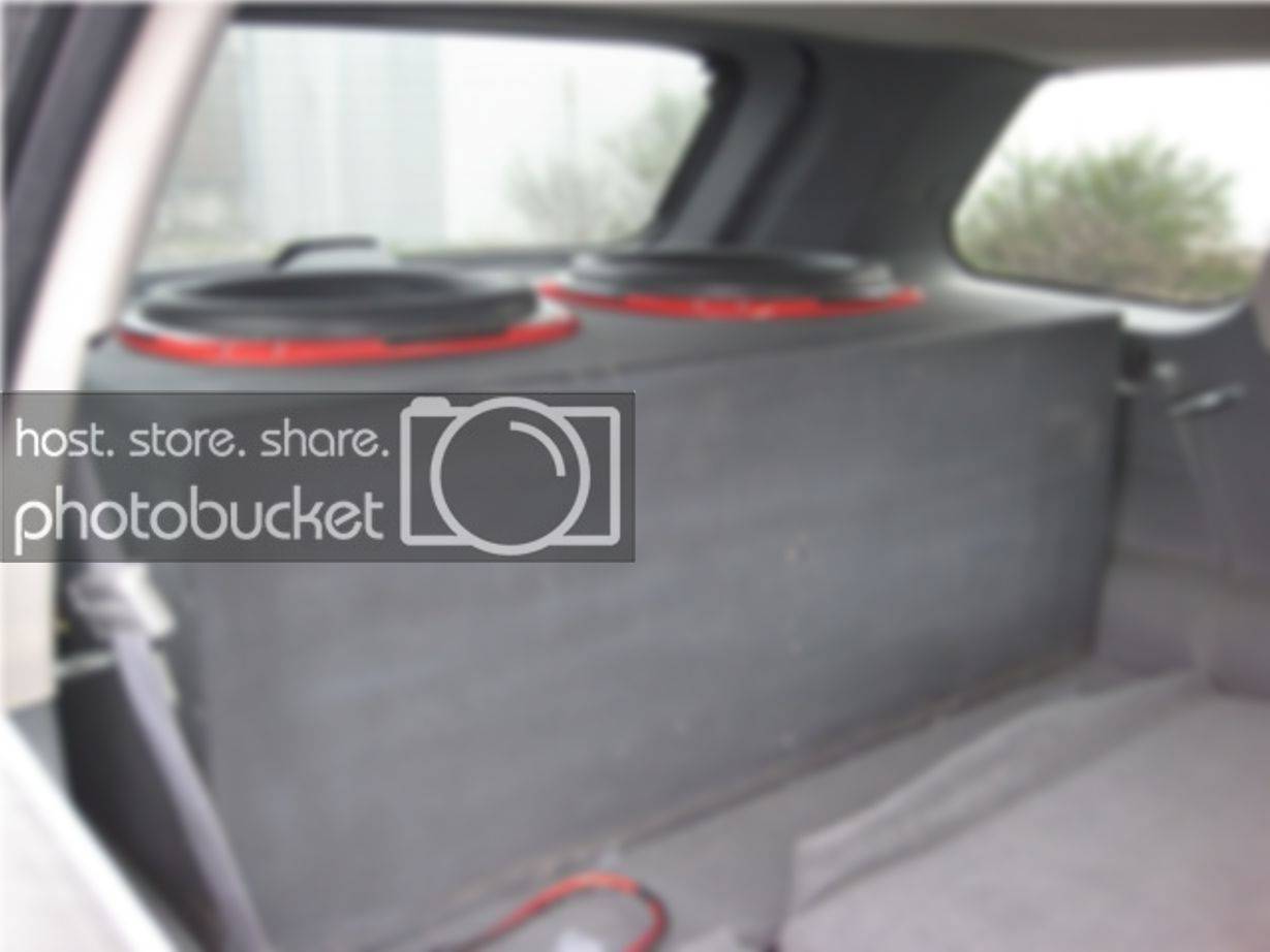

Got everything up and running today, its pretty loud. Got it on the termlab, managed a 150.1 @ 41hz outlaw meca style. Sub still needs some break in for sure. Im gonna deaden my rear hatch tomorrow. Itll be back on the meter in 2 weekends with some locals right before the meca comp. Met up with corey and junior today got a vid of his tahoe with 4 15'' mojos off a RD D9, quad alts, one stock and 3 DC 270 amp alts
