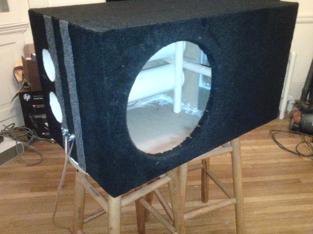

Try something like this, I just made this box, 1.8cu/ft tuned to 32hz with 2 3in pvc ports about 17in long:
