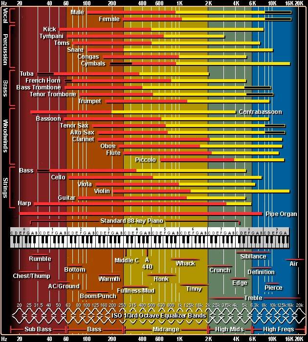

dude no wonder you arent getting any crisp sound, you literally cut off all the frequencies that matter when it comes to crisp sound. Your EQ definitely needs proper work.

start by putting your 2.5khz to 16khz back up to zero... find out what each one does by lowering or raising a lot. Typically the 10khz to 16khz dont ever need to get cut.
I was getting blasted by my tweeters, so thats the reason I had them that low. Im certainly willing to try it again.
And its not just that my mids aren't there because of the settings.....theyre crackly and sloppy even at the settings I currently have. I feel like If I turn those up, it'll just get worse?
