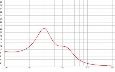

Hi,
I've run a lot of subwoofers through WinISD to find the right one which met the needs of the audio system being installed in the car. The goal was to produce a very deep subwoofer that drove 25 hz to 80 hz effectively. In looking at over a dozen drivers I came up with the Boston Acoustics SPG-555 2 ohm. It's going to be run in a 2009 BMW 535i, but needs to be ported through either the rear seat arm rest or up through the rear deck. The car has a lot of steel and really deadens any sound in the trunk, so I felt I'd lose too much sound quality unless it was ported into the cabin. The last car I had, the previous gen E39, ran a JL Audio W7 firing through the ski pass, but that wasn't an option on this car unless I cut the whole for it...which I want to avoid.
So, do any of you have WinISD and can look at the attached file to provide some feedback on the performance graph and if I did everything correctly?

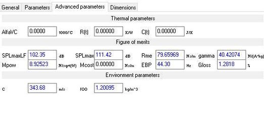

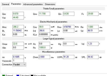

For those of you who don't have access to WinISD I have attached a bunch of photo's showing graphs and specs.....
Does this look like a good set up? Am I missing/forgetting anything? Thoughts, concerns, impressions?
Thanks for the feedback, appreciated!

Red line is your original design without cabin gain figured in
Black line is your original design tuned to 41hz with the addition of cabin gain. Note the HUGE difference below 50hz which is why I'm always preaching that winisd is useless below 50hz.
Green line is a tune to 48hz with cabin gain. Note the difference over the black line above 35hz.
Depending on the power, a 4 inch port might be a bit too small and will cause compression and port noise.

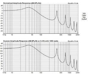

I followed the advice and bought Bassbox 6 lite, but since this is my first time using this software I wanted to get opinions from others to see if I did this correctly.
How does this design look overall? Any issues that you see? Air Velocity too high?

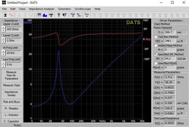

Ok, so I just picked up a dayton audio DATS speaker analyzer and one of the things that the software requires is the diameter of the piston. It says to measure from center of surround to center of surround....however the SPG-555 is an oval shape.
Here's what I did, and am not 100% I did the right thing based on what the software wants, but I measured the circumference and then divided by 3.14. It turns out the SPG is 33 inches around and that works out to 10.5 ish. So, I used 10.5 as the diameter of the piston area. If that's how to do it great. Or  if someone knows the actual diameter value I'll plug that in.
The numbers compared to the original OEM specs seem quite different than those I got when using the DATS. Does this look right to any of you? This is the 2 ohm version.

You can check for yourself by working out the area of a circle 10.5" and comparing to the 555cm^2 published..
Or to save you the time, yes, your piston area is correct.    For the record, when using DATS if you're using added mass method make sure you use a large enough mass (I usually use 500g or so) and make sure you do measurements in a quiet room (fans running or breeze will give you very strange looking results), and sit the sub up on something so that the pole vent isn't restricted if the woofer has a pole vent.
Specs actually look pretty good and close to what BA quotes. A lot of times manufacturer tsp numbers are an average from multiple samples off the production line so minor variances are to be expected. How much has the sub been used? Imo it looks like it hasnt been broken in, hence the stiffer suspension (higher vas and fs.) Play it free air for a few hours on 10-15hz on low power and it should loosen up.
How low do you want the box to play? Its nearing xmax just under 30hz. The other plots look good. It looks like you added the cabin gain boost in the plots.
Thanks for the feedback folks. I actually don't know how much the sub has been used, it looks to be in perfect shape. Also, I used the SPL selection in DATS.....

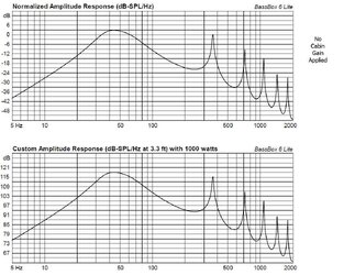

Here's the updated charts with both Cabin Gain and without. I actually don't know what to think about the cabin gain factor within BassBox. It makes a huge difference to frequency response....but without it the results show it won't be very effective at 20 hz....
what do you think real-world affect will be? Does this look like a good baseline sub? I'm going to use a digital processor to tune the speakers, but want to start off with a solid foundation.
The goal of the sub is to play 20hz to 70 hz (or so). The car has twin 8" mid bass drivers that play easily down to 40 hz, so I'm focusing the sub to drive deeper bass.
Looking at the chart without Cabin Gain included and the roll off at 0 db is around 35 hz.....is real world use cut off at this point, or will the sub be able to drive 20 to 25 hz frequencies?
Thanks, I appreciate any advice offered.
