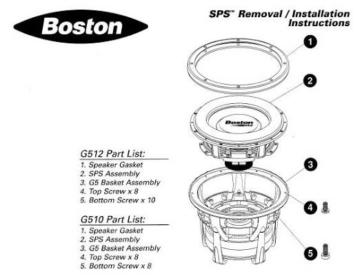

You can order an entire soft part system replacement for $80! SonicElectronix will order a dual 4 ohm or single 4 ohm, but only if you give them a call.
