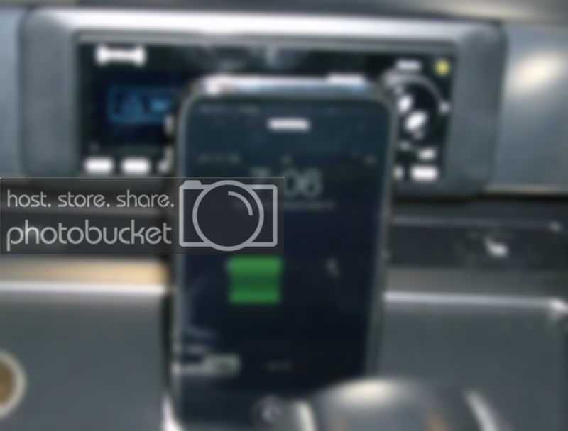

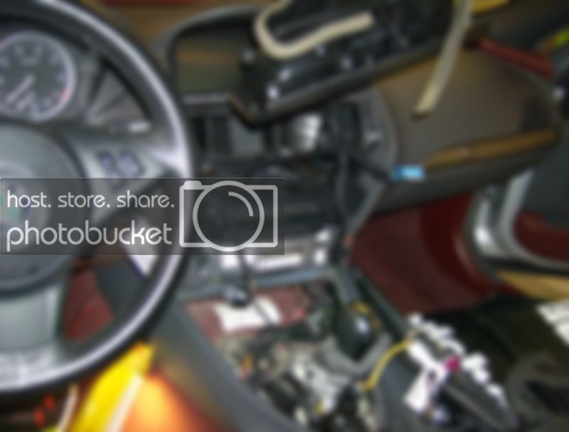

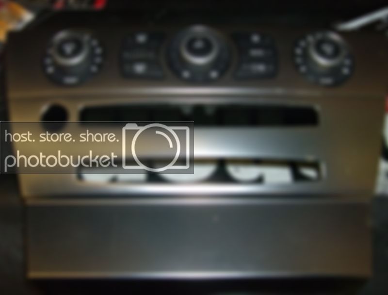

Customer wanted XM Radio and I Phone Mounted and installed into the veh...wanted something simple so this is it....Enjoy.

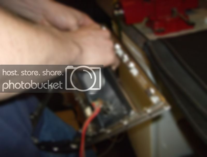

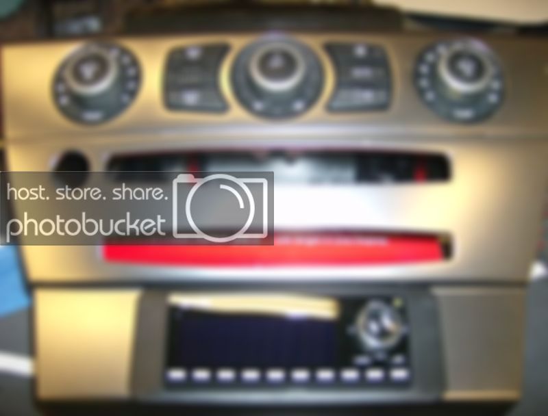

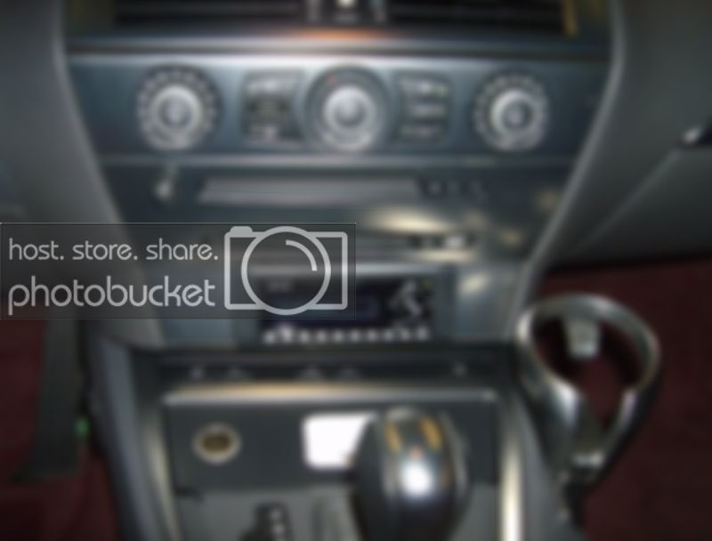

Basically used the mount with the xm commander to flush it into the panel, as for the I phone, i took out the factory ash tray and made a piece of ABS to fit in, covered that in black Vinyl and inserted the factory cig lighter, then cut out and mounted a iphone dock into the peice allowing it to charge the phone and play music via aux from the base into the Aux in the BMW glove box.
Only thing left was a nice billet cig plug
