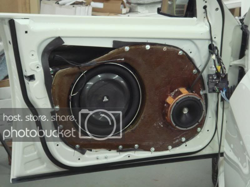

Do you have details of how you molded 13.5s in the doors? I would love to hear this car...
The doors were sealed with cardboard and tape to make a bowl shape where the fiberglass would not get caught under the lip of the inside edge.
Here the fiberglass mat is glued to the tape to get the flatted mold possible
http://www.dupontregistry.com/blvd/photos/build/full/DSC07458.jpg
Resin added
Sub ring mounted with wood spacers, and then wrapped in fleece and resined again.
Ring for midbass attached with spacers and wrapped in. The enclosure is mounted to the door with riv-nuts and bolts.
(Multiply by 4)
