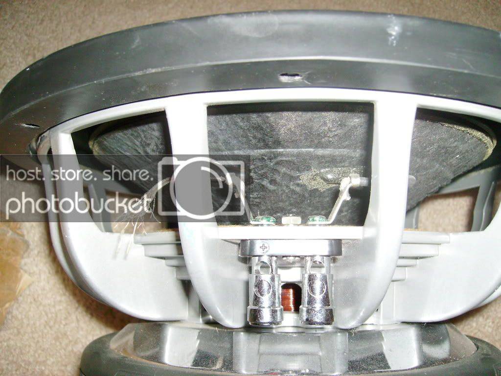

I have a Crossfire XT 212 and one of the wires that goes from the terminal to the woofer cone looks as if it burnt up. Not exactly sure how, but i totalled my car and after pulling everything out of it this is what I found:
What can I do to fix it? Or is there somewhere I can take it to be repaired. I live in Southern California. Zip Code 91350. Thanks for the input.

nah, you can fix it. just replace the tinsel lead. you will need to re-solder a new line. you can contact fi and ask them to sell you some tinsel lead. i'm sure other companies like sundown could help you with some tinsel lead since fi is usually busy. your sub is an easy fix. only issue it trying to mke it permanent so it doesn't do it again.

Soldering is easy enough. Should I completely remove the lead from the cone and use the glue or silicone that is holding the lead to it, or do I just solder the new piece to the existing one?

the tinsel lead is soldered on to that part it conects to on the cone.
ur best bet = try and un solder the current broken tinsel completely off the sub.
then solder on a new one - at the correct length it needs to be.
( check the other side for refrence. )

Just so I understand this completely before I start tearing things apart. If I get rid of the black silicone type material that is covering the tinsel lead on the cone side, I will find a metal connection on the cone where the lead connects?
Looks like it just seperated at the solder joint I would see if you have enough room to remove the frayed section and resolder, that is if the tensil lead is long enough
that is a nice find, but i would say this with my experience in attempting to resolder new lines fromt he existing leads in under the cap. they can be hard to find and not all are the same.
the one he used in his images stood out a lot. the ones that i tried with an 18" XXX and a 12"SX the leads were VERY VERY close to the voice coil tube thing.
though the position of where the tinsel lead exits the cone on his speaker can esily be reached unlike a few moofas out there.
