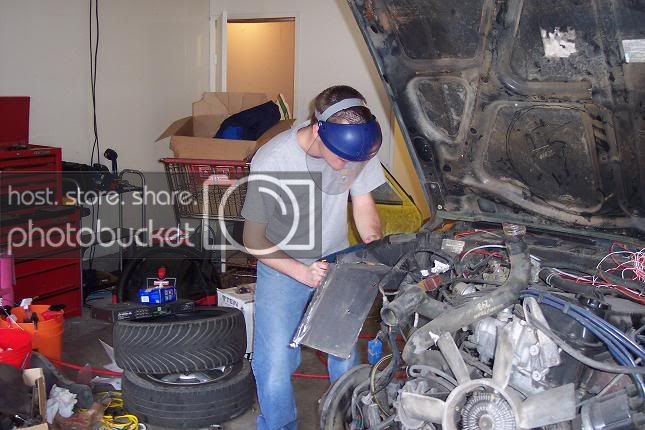

hehehehe, that's a wicked looking grinder there rick.Promise me you'll keep all 5 fingers o.k ?
2nd pic up from the bottom looks like you are taking a pee
P.S
Dont catch that carpet on fire on that post.

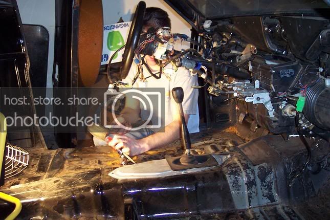

Yea the grinder is a little scary. it will start moving on its own depending on which way you turn it like wind gets under it and it gets air born almost! but yea i keep my hands out of the way.
most the sparks are shooting out of the garage so i dont catch anything on fire inside. should be more pics comming later today.

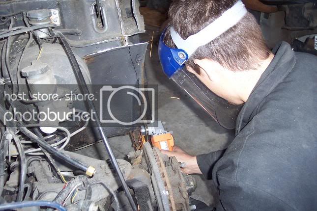

ok last night i was to tired to post pics so here they are

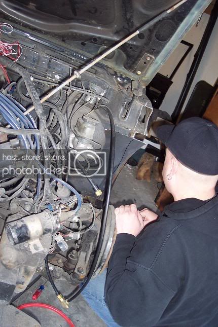

cutting the inner fenders off flush with the fire wall
drawing where we will trim the inner fenders
me trimming
fender all trimmed up

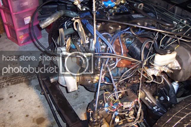

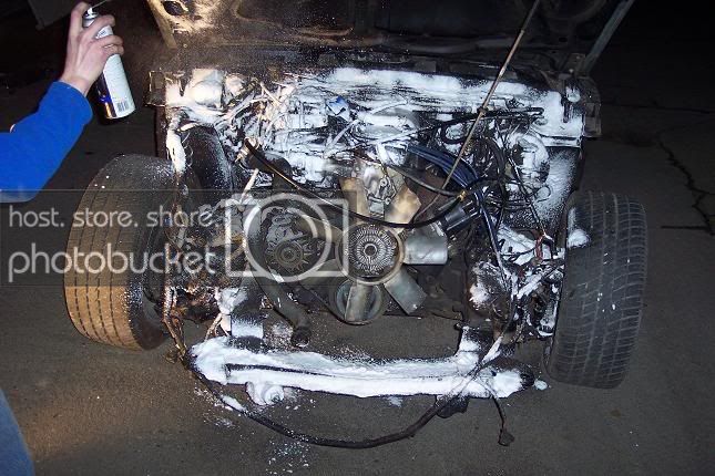

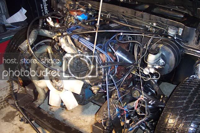

then we degreased the engine and sprayed simple green all over it. we made sure to cover the carburator with tape so no water got inside.
the motor all cleaned up

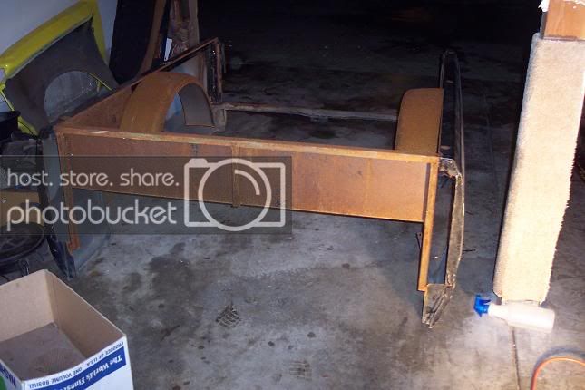

the rusty bed i have to sand down next!
