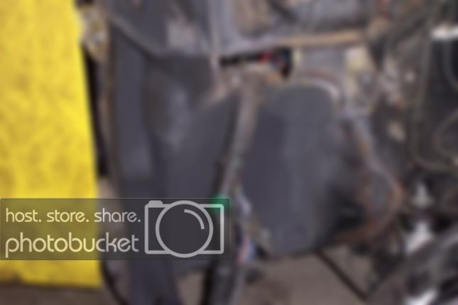

here i am cutting away part of the firewall that was tubbed. the reason for this is because with my current wheel /tire combo the top of the tob hits the tire making it so that my truck wont lay out all the way

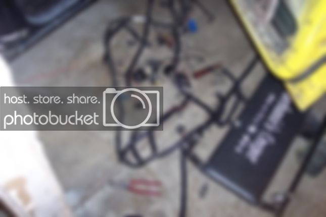

more cutting. i am also feeding the wiring harness throught the firewall so i can have it come through at a different spot. the location it came through normally would have been extremely close to my tires. so im moving it rather than taking a chance.

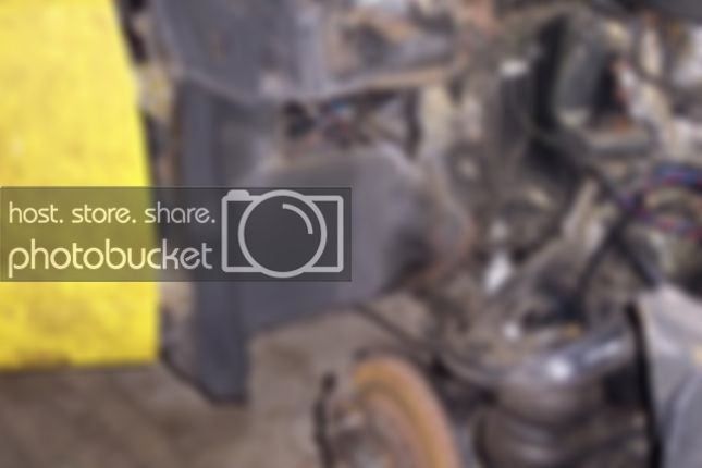

and here i am covering the old nasty wire with new wire loom to make everything nice and clean under the hood.
do like I did on my H/B and mold an Eclipse bubble on there
yea i could try that for the time being just to make it look a bit cleaner. but i think when all is said and done ill run stock hood. maybe ill take a trip to pick and pull and get a bubble
