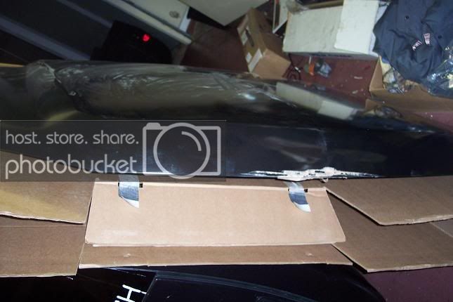

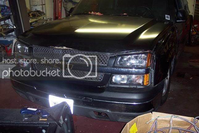

and this is why im selling my stock hood. Went to chevy today and picked up a brand spankin new HD hood for my truck
the marks on the hood are really just cardboard that i havnt taken off yet

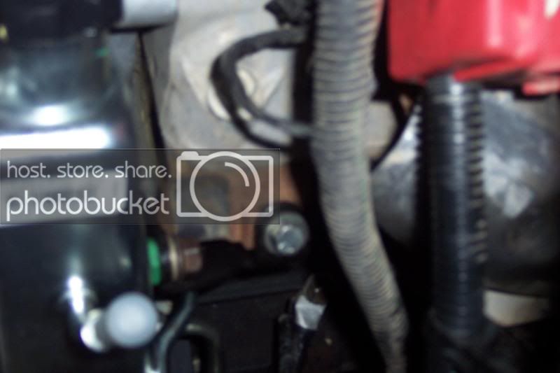

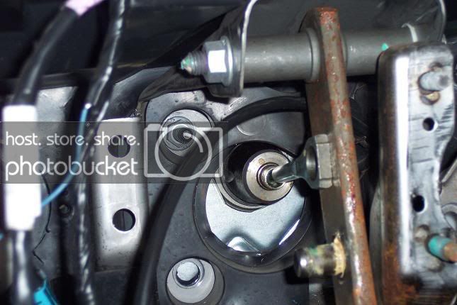

Removed my stock booster

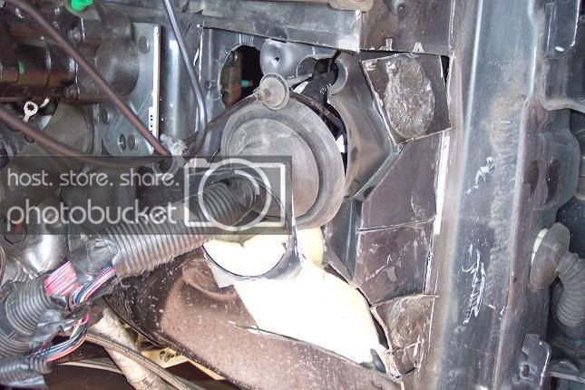

A shot of the hydro booster inside the cab. i need a break pedal from a hd chevy as you may notice the pin on my stock break pedal sits below the booster now.

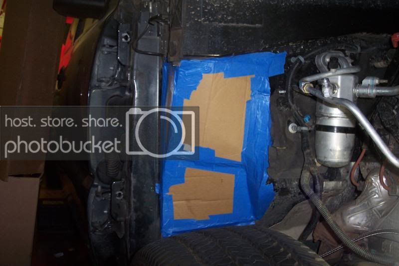

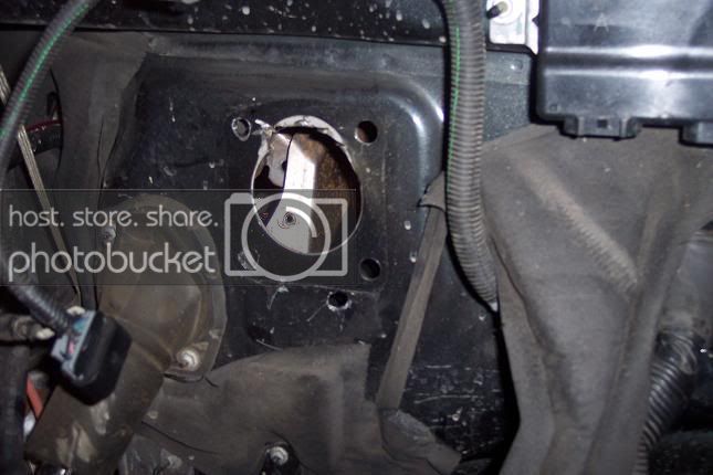

Cut away the drivers side of the firewall. I left the circle piece intact so that i can use the stock grommet when the firewall is welded up.

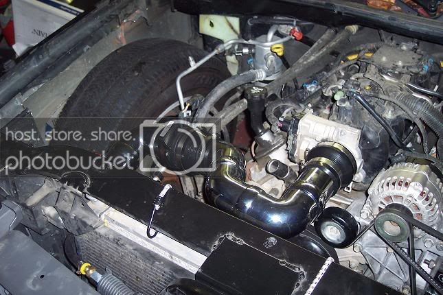

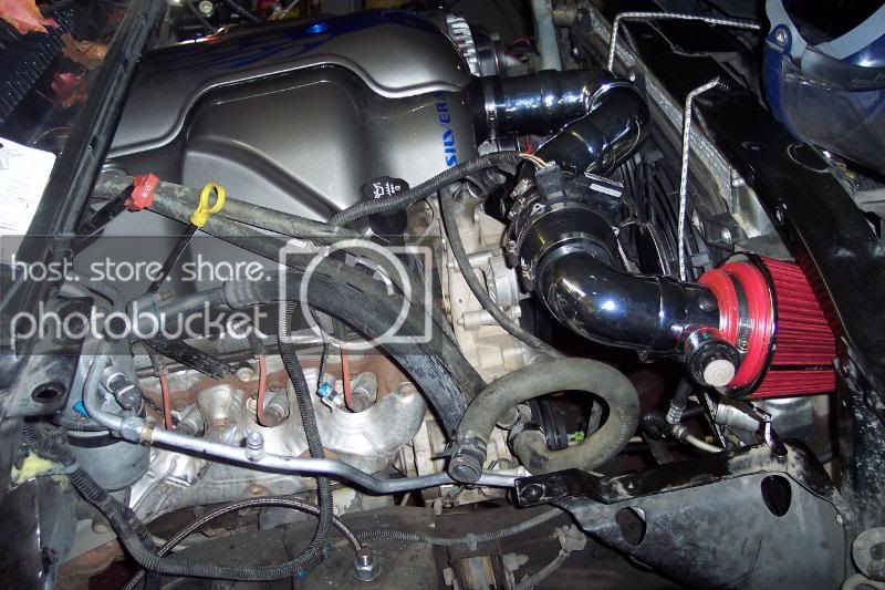

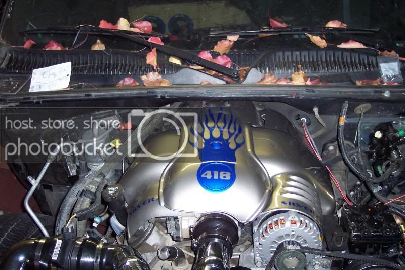

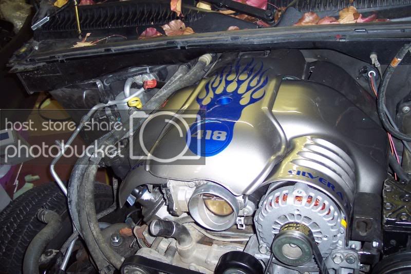

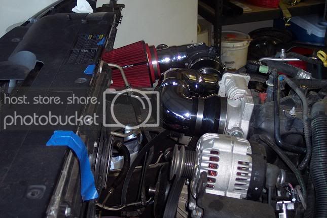

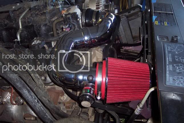

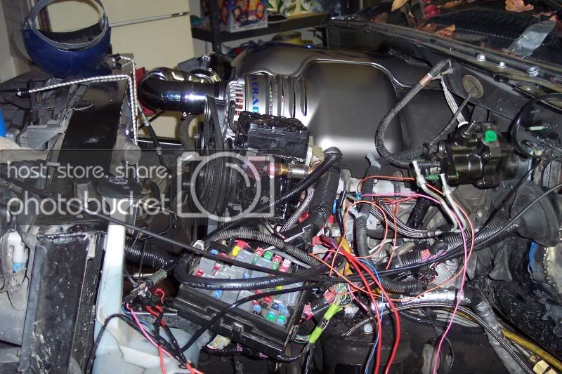

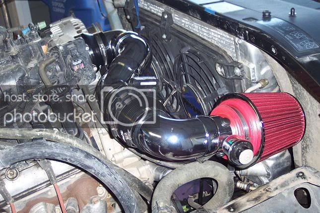

The new intake
another shot. I am able to use all my stock sensors hopefully it will all work well.
another shot

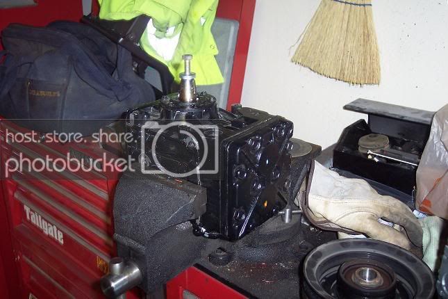

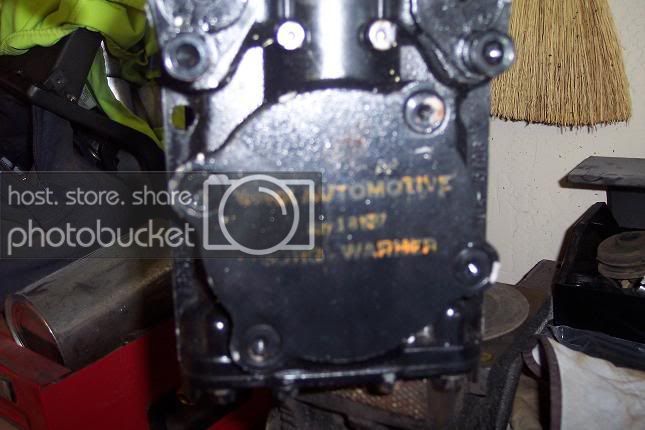

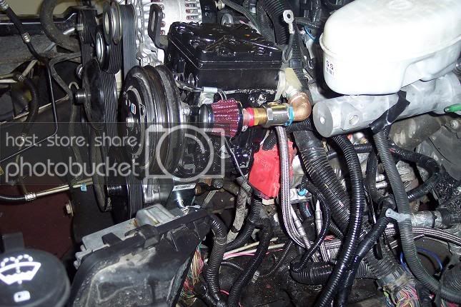

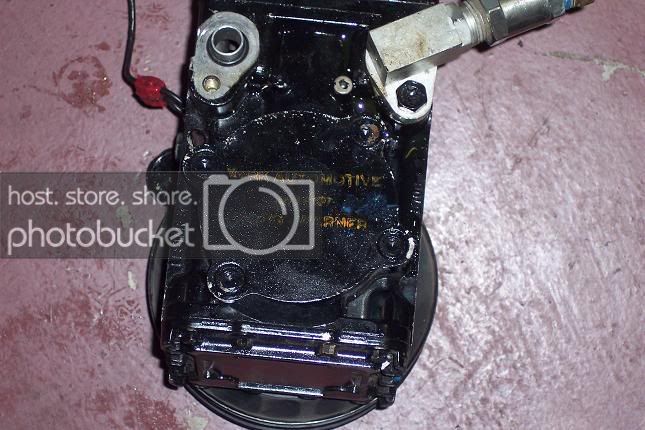

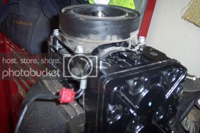

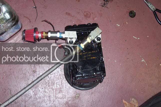

And here is how you make an EDC out of a York compressor
a new old stock bmw york compressor i bought for $30

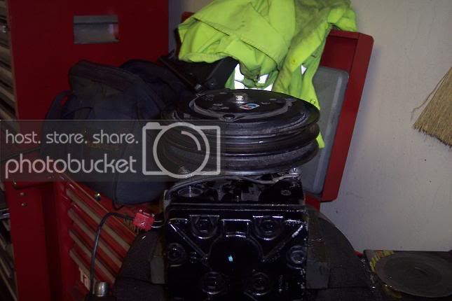

here is part of the v belt clutch that contains all the electrical for the edc

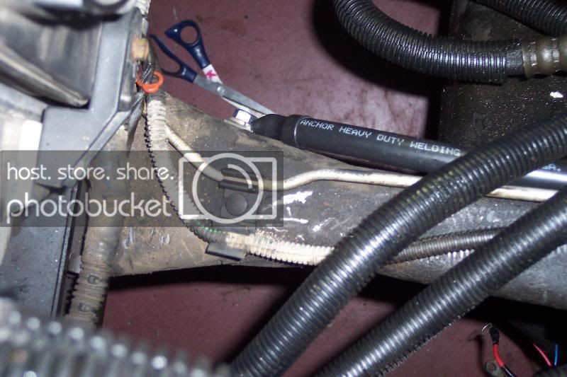

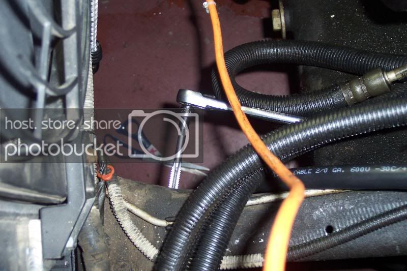

make sure the thing is grounded
and added the pulley to the edc.

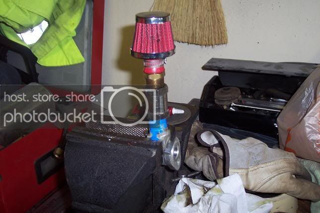

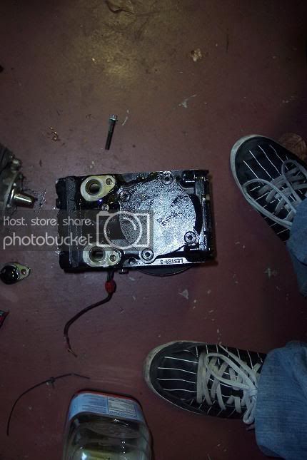

removed the back cover plates so i can add the air fittings. When i removed them they let out a little pressure kinda startled me. then oil started leaking out.
Breather filter

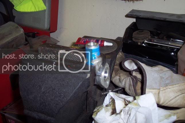

make sure you add these little nipples inside the unit.
all fittings installed for now. then i had to mnake a home depot run

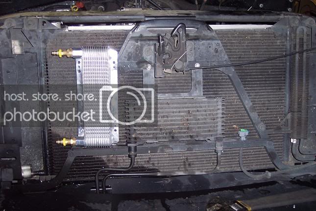

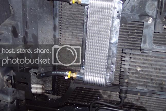

New B&M ****** cooler installed
added the new lines

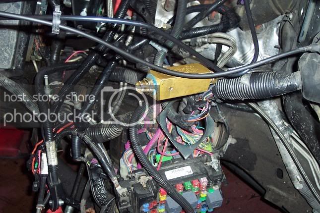

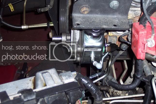

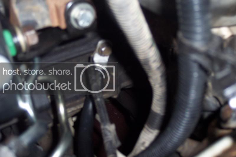

escalade power steering pump installed. it has an extra line coming out of it that is to be used with my hydro booster.

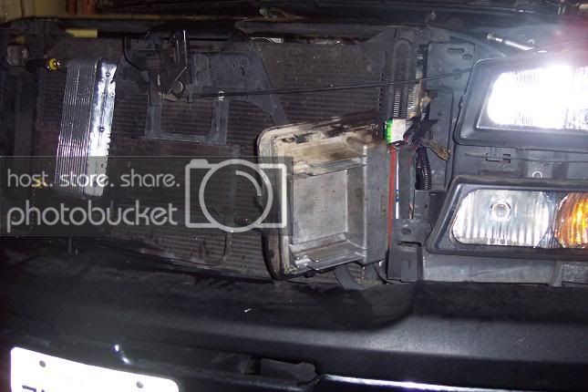

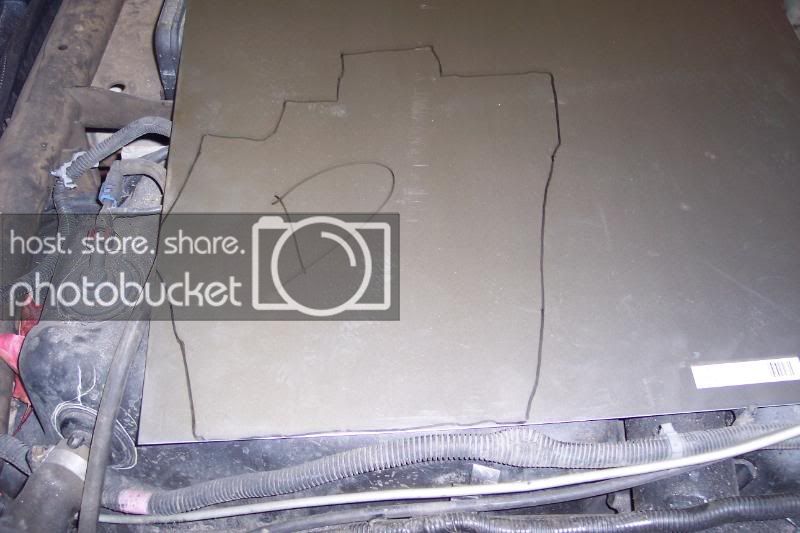

the new location of my computer. got it da fawk outa my engine bay! and thats all for tonight cuz its hella cold out and my nuts are freezing to my legs!

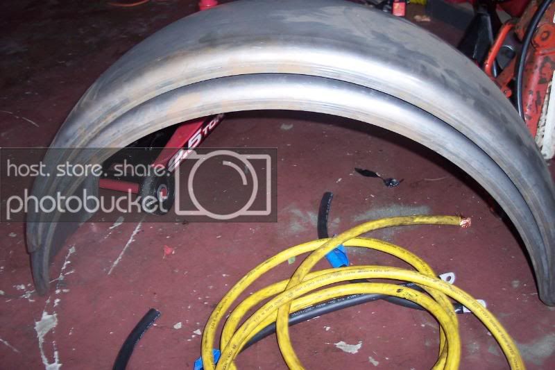

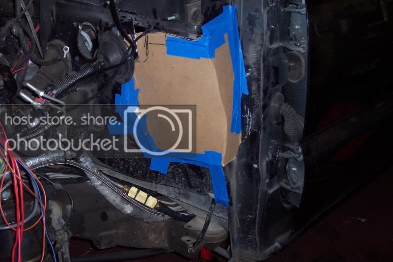

cut up the fenders
both fenders fit now.
a little tucking

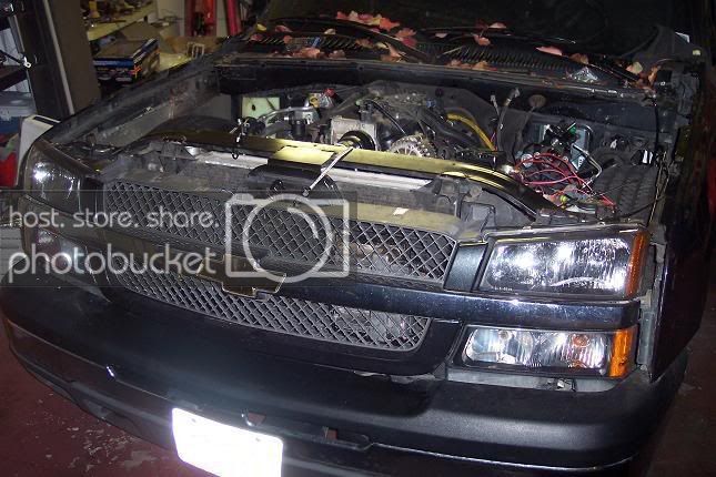

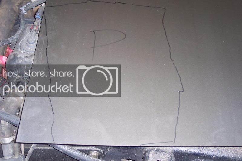

testing the new hood

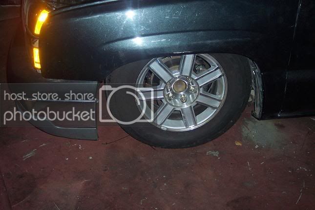

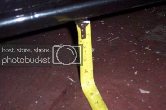

Looks like i wanna be about 5" lower.
Thats as low as its going for now. its on the ****** crosmember if i went lower id drag the exhaust. Ill just have to wait untill i can redo that as well.
Very nice there, love the york conversion, was planning on doing that with my old ford 4x4 definitely a better way of going instead of some electric compressors.
Dang you guys go through a lot of stuff to "lay frame" or body or what not lol, I think I would be happy with it just on the crossmember.
Keep up the good work and keep us posted.
never seen the york compressor thing before, whats it for?
On Board Air Compressor.
It uses the motor to fill the tanks for the suspension. It can fill a 5 gallon tank to 150 PSI in about 20 secs compared to an electric compressor that would take 1.5 - 2 minutes.

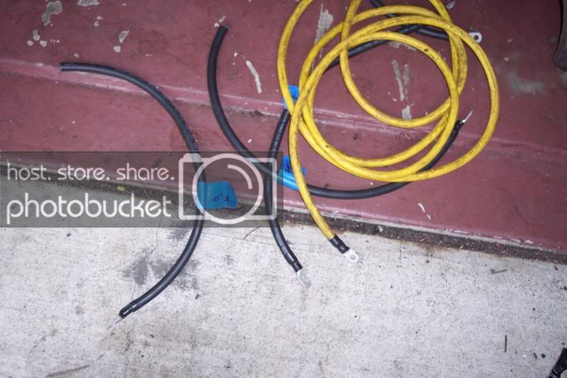

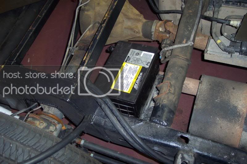

relocating battery to the back

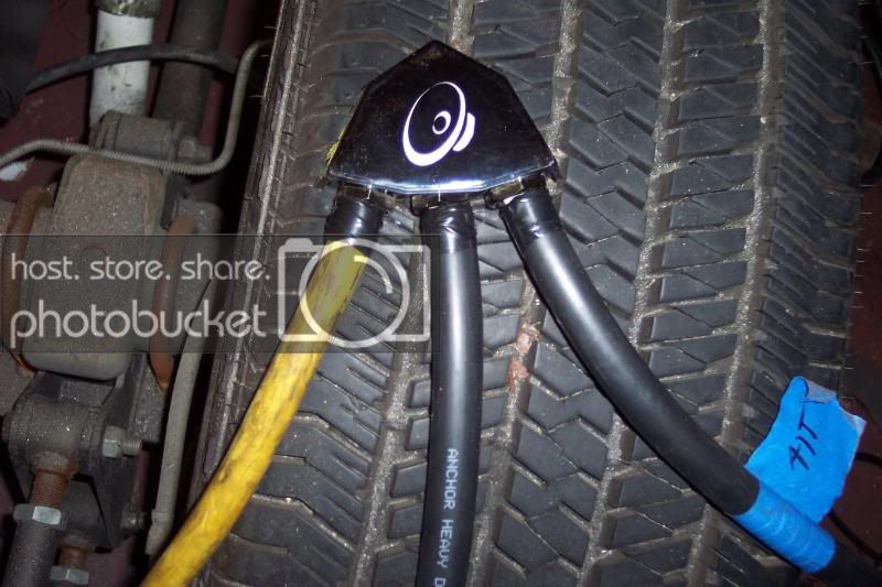

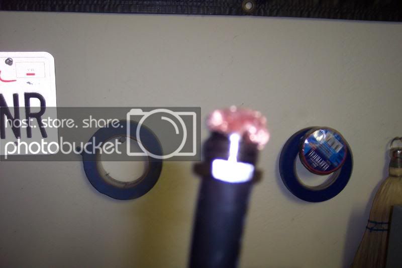

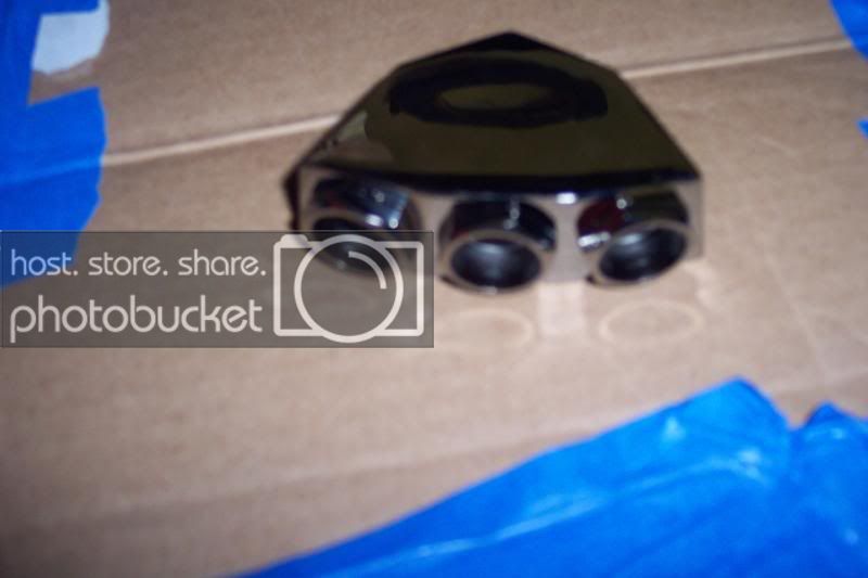

distro block
with this distro block by knukonceptz you put the wire through a compression fitting and bend the strands back around the fitting then compress it into the block
