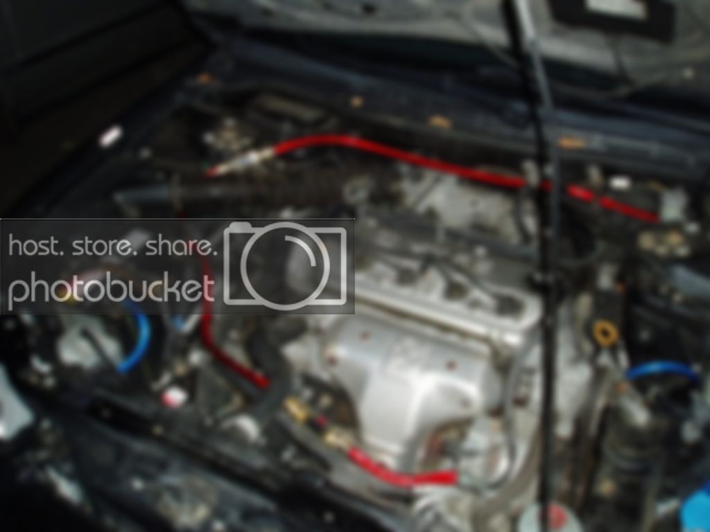

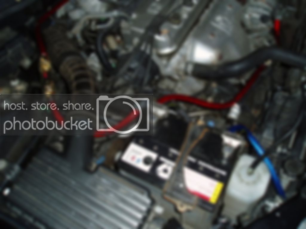

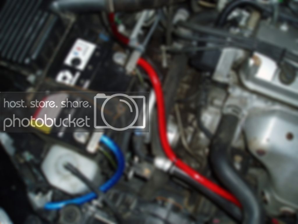

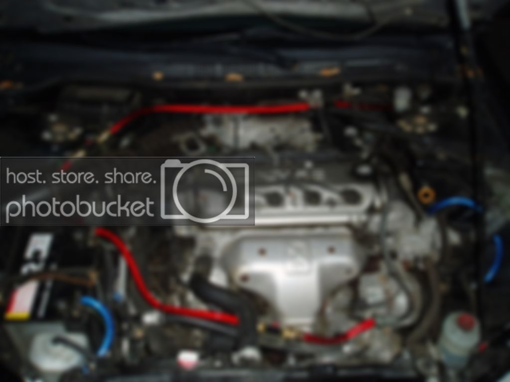

finished running the wires. took f'ing forever and my back is killing me.
all that's new in these pics is the run back to the amps. started a new thread cause that one was f'ed.

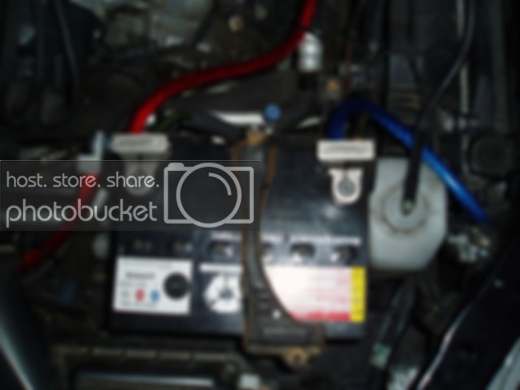

as you can see, my idea to get another run on 1/0 on the battery terminal was to remove the set screw for the 1/0 input and use a nut bolt along with a ring terminal. seems to have worked out well.
getting the big wire through my small hole in the firewall wasn't nearly as hard as i thought. i just had to push //content.invisioncic.com/y282845/emoticons/smile.gif.1ebc41e1811405b213edfc4622c41e27.gif
i tried hooking my soundstream amp back up and realized the power/ground terminals are no where near big enough for 1/0!!!!!
but it's totally messed up anyways, there must be some sort of bad short internally, i couldn't even get the wires in without sparks //content.invisioncic.com/y282845/emoticons/crap.gif.7f4dd41e3e9b23fbd170a1ee6f65cecc.gif

i also like my idea for the bolt out the side of the battery terminal //content.invisioncic.com/y282845/emoticons/smile.gif.1ebc41e1811405b213edfc4622c41e27.gif
