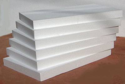

I will test it next week when it comes. For example about how much air space would be taken out with like a 4"x4" foam square?
Also I assume you are referring to the cheap light white Styrofoam stuff like in packing material.
basic math man. 4 x 4 x 4 = 64/1728 = .037 cubic feet

Yea plain ole high density foam like this.
