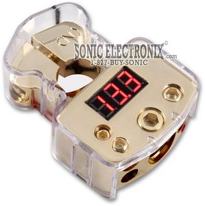

either splice them together or get one of the battery clamp from a car audio shop that has a 0/1 awg and a 4 awg slot to make it look better. you may want to consider getting the battery terminals for ease so there is no soldering or error. fyi: consider another clamp for the negative side from the chassis to the battery.
2 options;either splice them together or get one of the battery clamp from a car audio shop that has a 0/1 awg and a 4 awg slot to make it look better. you may want to consider getting the battery terminals for ease so there is no soldering or error. fyi: consider another clamp for the negative side from the chassis to the battery.
What do you mean by battery clamp.
Is this what I would need. 0 guage for big 3, 4 guage for amp power, 2 8 guages for stock car wiring?
I understand that I would use ring teriminals to connect one end to the car. Im just confused as to how to hook up all 4 wires to a single battery terminal.
My stock terminal has 2 red wires connected to the it. I then put a ring terminal in there for amp power. Dont think I would have enough room to add another ring to it, especially with 0 guage,
