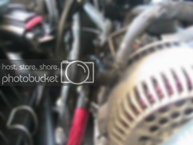

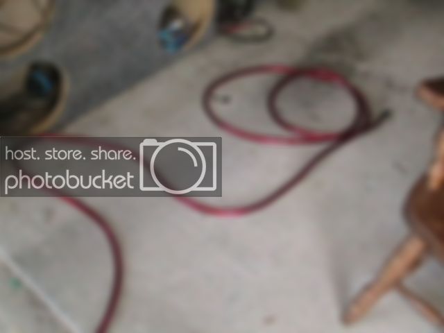

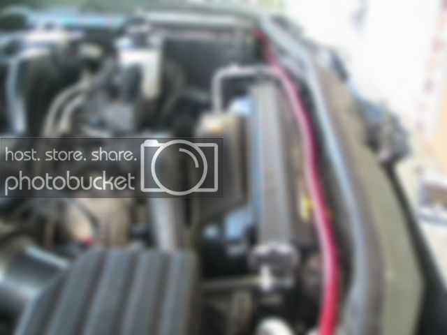

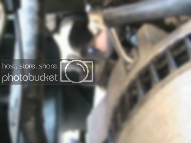

I did my alt wire for now...gonna get a new batt before i do the ground and all it lookin prettier
You have to break a piece of the plastic off to fit a 1/0 terminal...at least i did
thanks man, thats what i was wondering, because when i was lookin at it the battery is basically on the opposite side of the alt. so i was curious how i was gonna run it. I was actually thinking about running around the windwhield, underneath the hood and around but **** thats a lot of wire to run, and the sht aint cheap. Post some more pics as you do the other stuff, or send them to me, im planning on doing it in a couple weeks.
